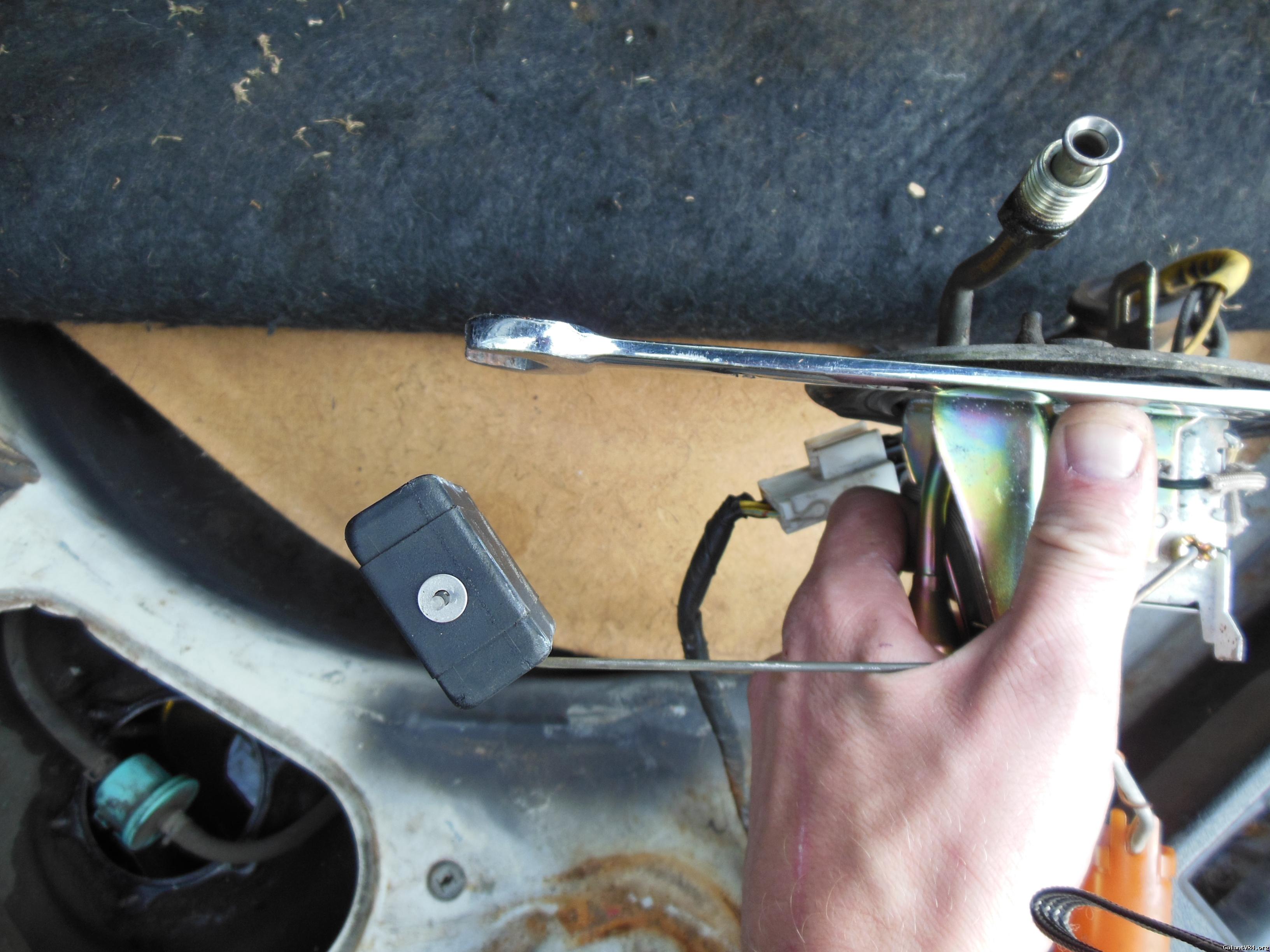

so i filled up 1078 the other night and it reads 3/4 at full. today i will puill the pump take pictures and explain how to fix it for ya'll

this is where you want it level to, mine ended up being a bad fuel level sender. if this is where yours is, maybe a little closer to the wrench then you have a bad sender as well. if its sitting above the wrench then it can be bent back to here and its still a good unit.
