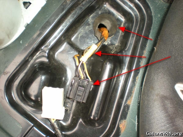

It's probably not available new, but I can cut one off a junk sender I've got sitting around. You can solder and heatshrink the new harness section onto your pump bracket/sender unit and be as good as new.
Send me a pm with your shipping address, and I'll get it in the mail later this week.

What's wrong with that one, exactly?
The wire with the crimp connector is the one you cut to do a fuel pump rewire. Looks like someone did that mod, then reversed it before selling. I'd suggest redoing it.
