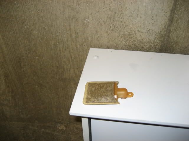

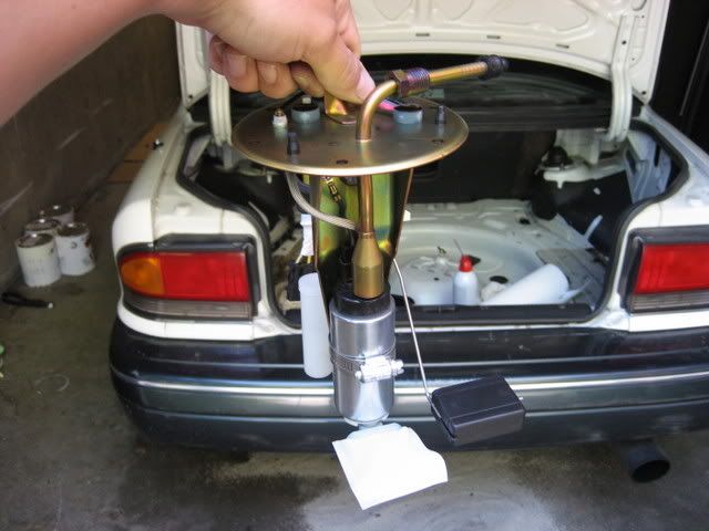

Well here is the deal, I was so close to pussing out and leaving the stock pump on there because i was deathly afraid of screwing it up transferring the walbro over. Also the filter on the walbro was disgusting and i didnt know if the stock one would fit. But I stuck with it and set it up beautifully (imho), the stock filter fits fine.

Dirty old walbro filter:
Walbro on new assembly:

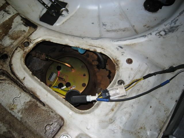

And here it is installed with no leaks!!

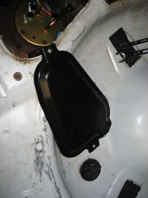

Thanks again for the help Aaron, and thanks to GVR4.org for giving me the confidence to work on my fuel system. Now Im heading down to the junkyard for a good cover, the one I have isnt airtight, I dont know where its from here is a pic:
Bleh I just realized when looking at the pics that I will have to cut that 12V line again to get it through the good cover if I get one, oh well.
Rausch
Dec 21, 2004
12,049
Cleveland, OH
just run a bead of RTV around the flat edge of the cover, and let it set up before you install it. when it's still semi soft, but not sticky, screw it down kinda loose, and let it cure. when thats done (probably overnight) cinch down the screws, and voila! instant sealed gasket! good work, glad we could be of service!
