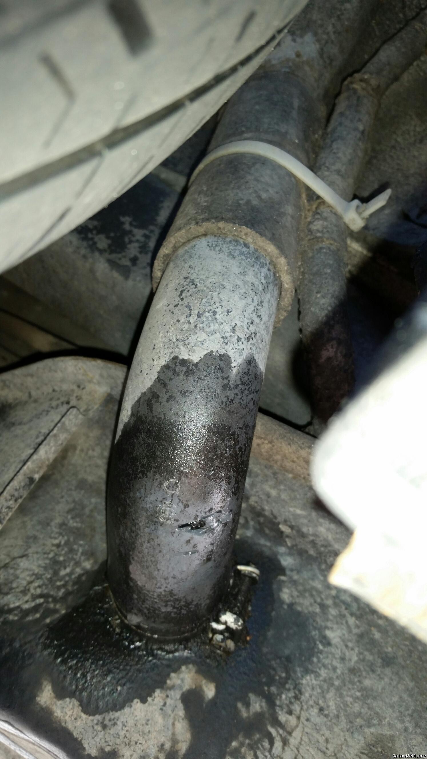

So I come home from work today and find this dark spot on the ground near the gas tank area.
Take a look under and I find this.
/ubbthreads/images/graemlins/banghead.gif
Anybody have an extra one of these fuel hoses laying around that I can grab?

Should be available new from JNZ. A lot of members have bought those over the last 5 years.

mine failed due to age and looked just as "slashed" it's just the angle of it I think, and it dry rots and splits right there.

I tried to temporarily seal the filler hose to keep it from leaking but no success. Just gonna have to wait til the new hose comes in.
So how should I go about replacing it? Should I drain the gas tank before pulling the hose off? I just want to avoid spilling fuel all over the place during replacement.
11,982
Depending on how much fuel is in the tank now, you could just jack up that one corner and the fuel would all slosh to the other side while you swap the hose out.
