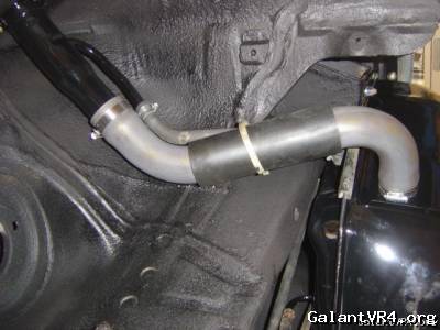

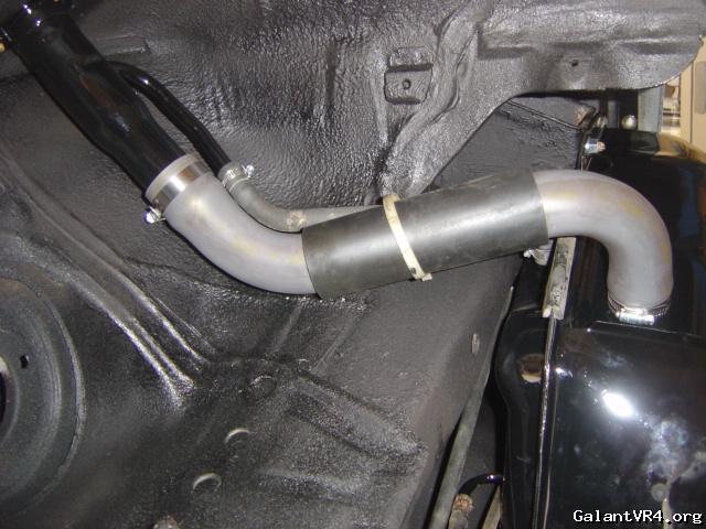

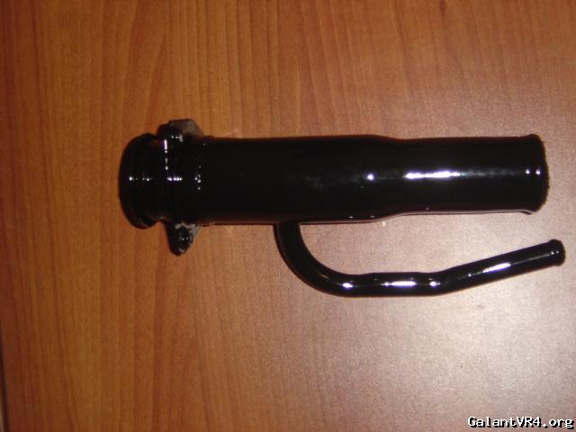

talking about this pc?
OEM Part number is MB678630. Not sure if it is still available. I had mine powder coated.
