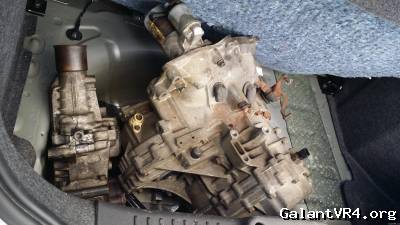

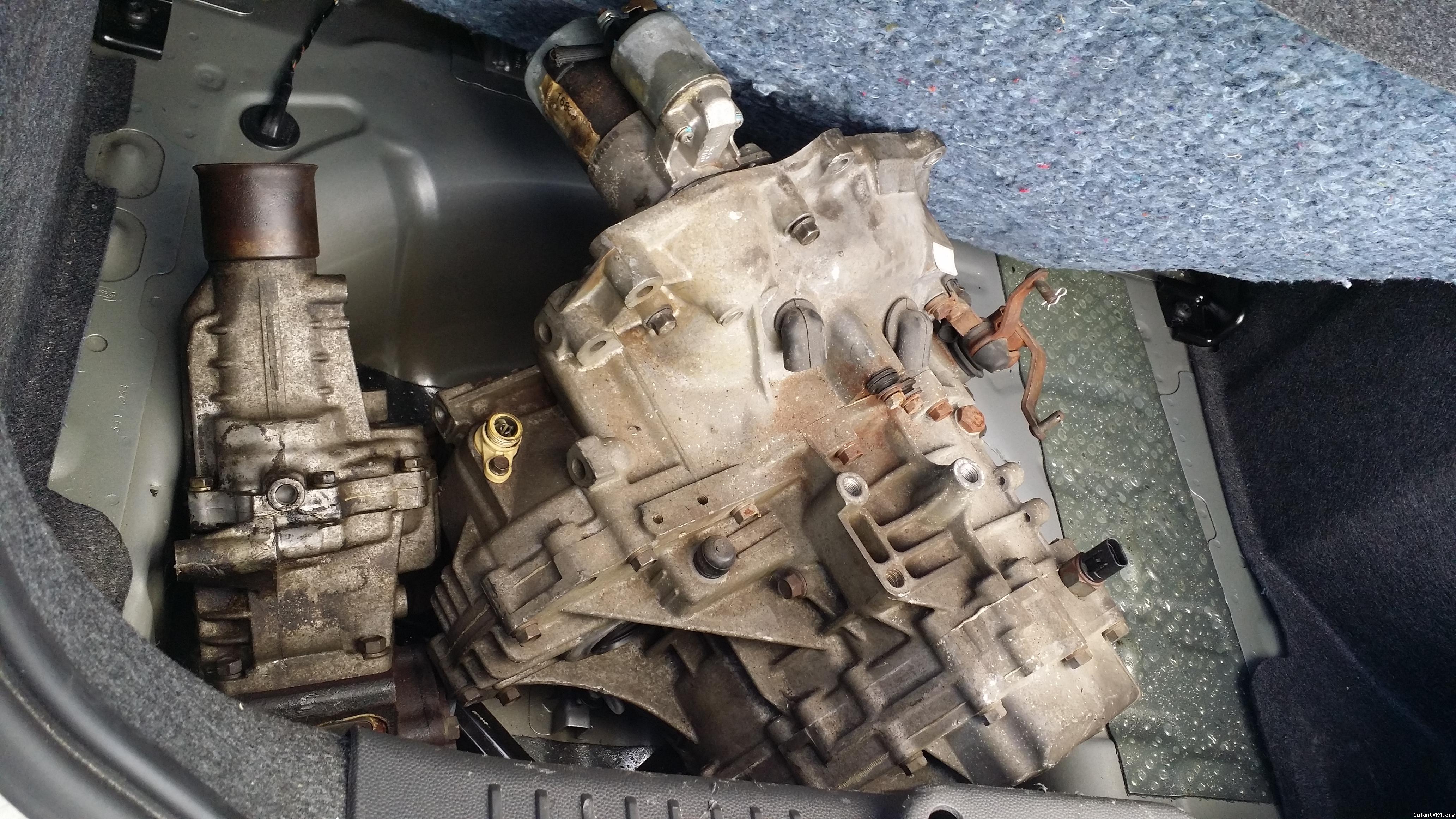

54k miles in known tip top condition as it came from my jdm evo which I drove on the streets for about 6 months before I tore it down to switch directions in my build so now comes an oportunity to own this rare set up which swaps in to any usdm dsm or gvr4 directly but there is a good bit of labor involved mainly swapping the ring and pinion in the rear diff.
this is a little known "secret" in the DSM world but a built trans from Shep or any of the other well known builders in which all the use is early evo bits to build them well here is one better a complete known good low low mile swap.
This will cut a good bit of time from the 1320 as the gearing is short but just about perfect for the track as you will top out 4th just before the end of the traps but if you raise the rev limiter then you are golden.
early evo have the steel shift forks etc etc stock.
What you will get....
known good evo 1 transmission with no issues
known good t-case (late 2g style)
known good rear ring and pinion to match the front final drive
we did this in a gvr4 many many years back and it was killing the streetrace scene and even the track with our little known secret weapon which was jdm gearing /ubbthreads/images/graemlins/smile.gif

Pic added from their stored location, starter not included
This truly is a bad ass upgrade for any usdm car as close ratio gears adds a fun factor and shreds time from the track.
