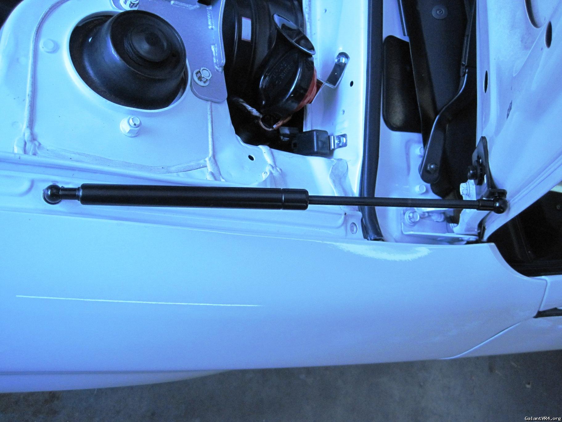

Quoting stealthtt24:
Just got these installed, love em! Here are a few pics.... don't mind the engine bay that needs to be pressure washed. Also I noticed my brackets needed to be angled to fit. Not sure if anyone else had that issue...
"stealthtt24" I seem to remember when I fitted my struts that the instructions do state you should fit the struts the way you have them (i.e. with the piston attached to the fender and the cylinder/strut attached to the hood).
That said ...
If you look at the pictures below you can see that Terry fitted these with the struts reversed which gives much more clearance and allows that bracket to sit straight. This was exactly how I ended up doing this, because I couldn't get my hood to close properly with the struts mounted the way you have them. The thicker part would touch the top fender mounting bolt on my car causing the hood to start to 'bow' as it closed.
In my opinion the way Terry did this is best since the angled part of the bracket with the ball rests on the shoulder of the OEM hinge, preventing it from rotating out of place and placing strain on the joint. Ideally I would have liked to have seen these brackets attach to both the hood bolts so that they were held in place and could not rotate but I suspect that they were designed this way so that they could be fitted without loosening the hood completely and messing up the alignment ... coz then G would get on our cases /ubbthreads/images/graemlins/rofl.gif
