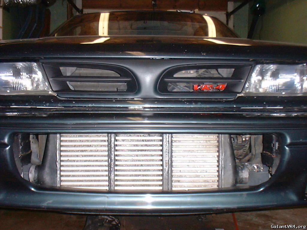

Heres an ancient picture from about 6 years ago
Is that three standard DSM cores welded together? Seen that done a few times.
EDIT: On closer inspection they look to be Bar and Plate cores (not stock DSM) but still 3 welded together. /ubbthreads/images/graemlins/grin.gif
