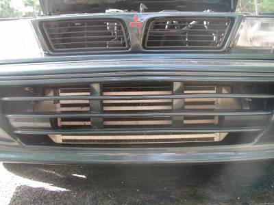

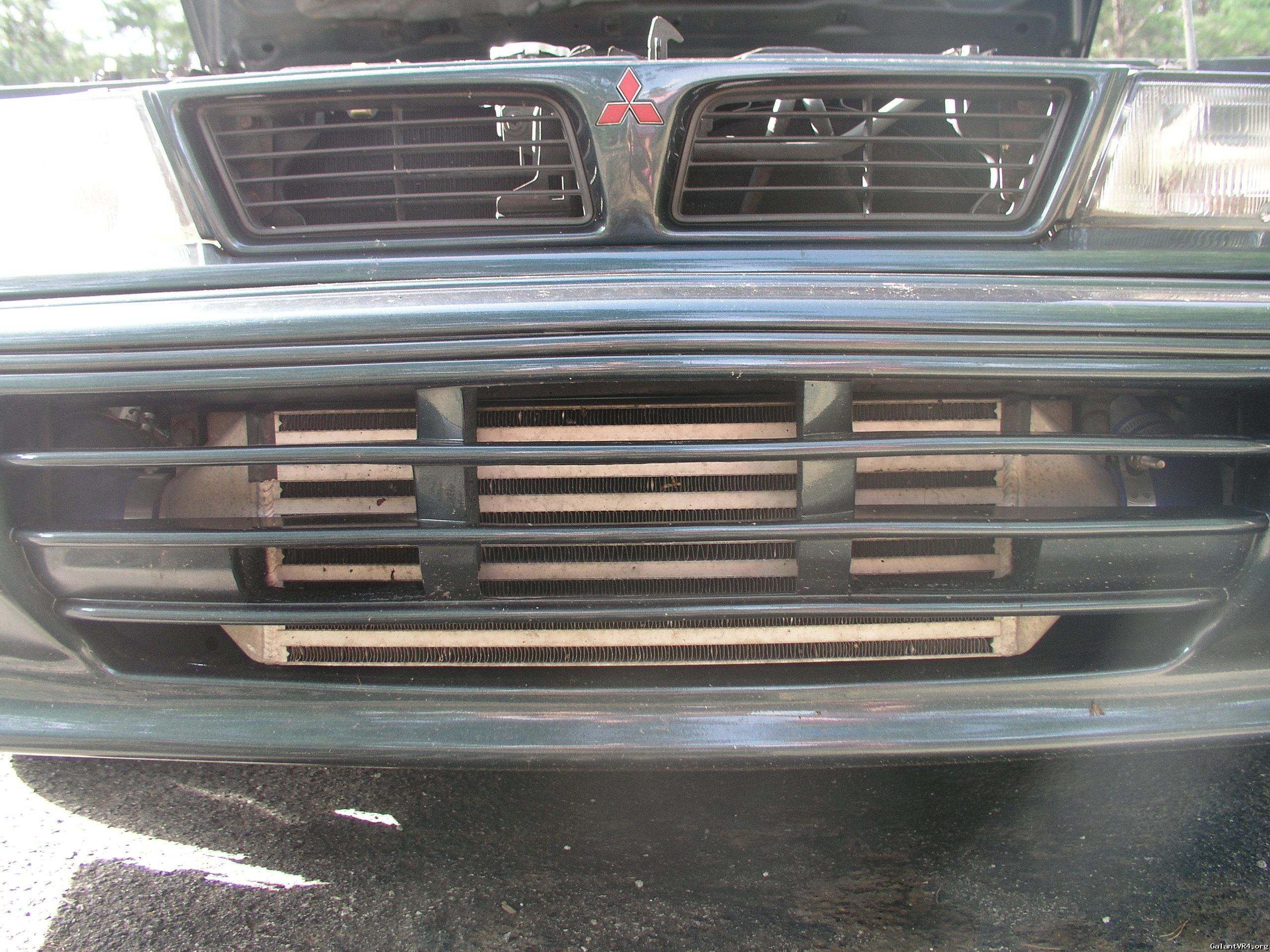

Here is what I did with mine back in the day:
I just cut out the big middle piece. Whatever you do you'll need to touch up wherever you cut with paint to hide the black urethane.

That looks pretty clean, Dave. Enough cut out to allow better airflow, but enough left uncut to keep the bumper looking nice.

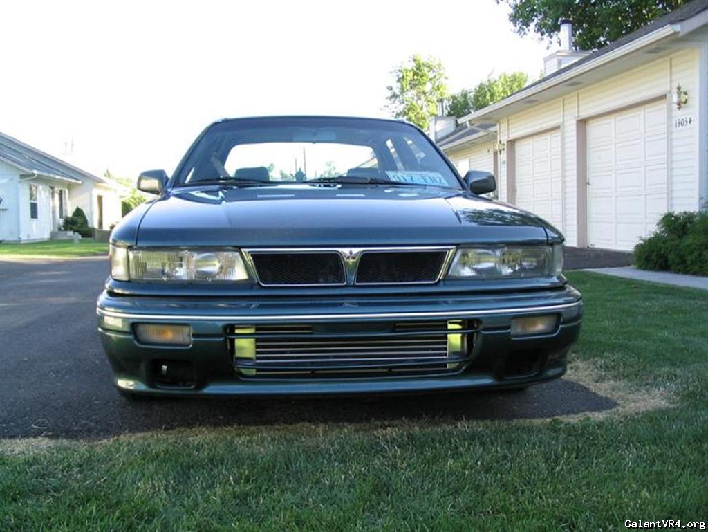

I did something similar to Dave's, but I just left a little less of the upright sections. I just didn't want the bumper to sag in the midddle, which is why I think most people just cut them out.
I like it, it hides the intercooler, and looks better IMHO.

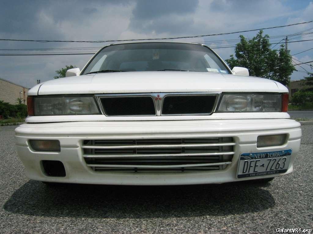

iLLeffeKt vr-4
Jul 26, 2004
2,153
NYC
When I did it on 1759 I used a box cutter with a new blade on it. It cut through the bumper like it was butter. I tried the dremel but it kept melting the plastic and it was a pain in the ass and very messy. The box cutter was very clean and easy but you do have to be careful.

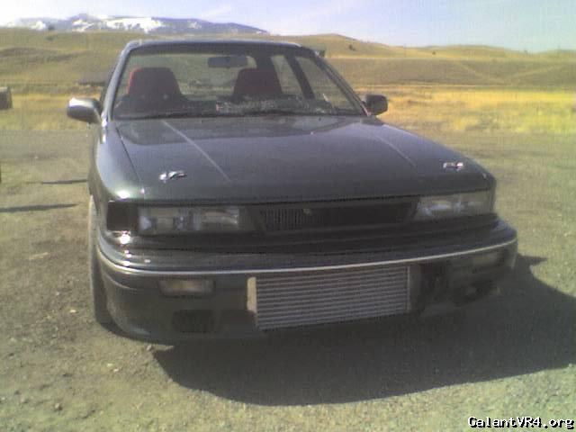

It depends on how "hungry" your car is...we used a recipricating saw...little gnarly as far as control goes but cleaned it up better with a box knife...which as stated above, cuts like butter

Luckily its not a sleeper OR a DD so it works well for its purpose built design...but to each their own I suppose...you really can't see the whole picture due to the quality but there's a chin-brace under the IC that flows into the bumper's cut...it works but once an unmolested bumper makes itself available I'd entertain a different, more OE look...but as is, that's what one gets when they buy a wrecked GVR4...
