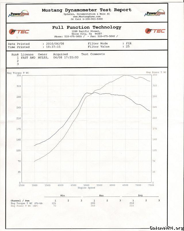

This is on 91 pump and I told him to stop at 21 psi cause I dont need more than that for the street. You cant get these numbers on a green or red without high octane gas or hella boost like 25psi or something is all im saying... Mustang dyno not dynojet...

real street car no issues 100 miles per day. no knock. no problems. Big turbos SUCK. SMALL TURBOS don't suck enough. If your on a dynojet then yea you will get 400 to the wheels on a 16g, I forgot about that scenario.
Woah and you only have to wait until 5k to make 350 wheel horse! Wicked cool. That powerband would make me want to sell my car.

And correction it's 350hp at 6.5k, even less impressive.
