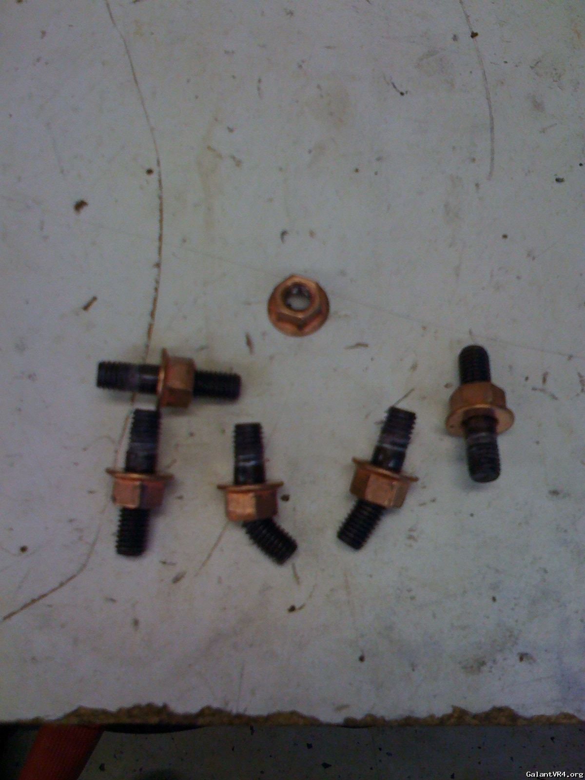

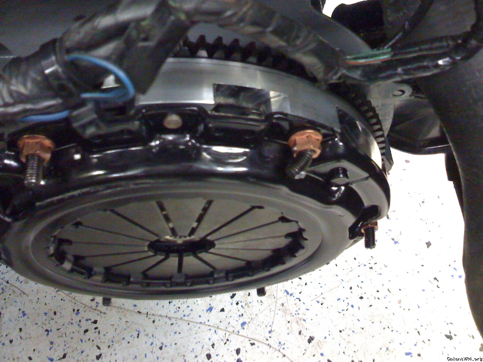

I have always had a good experience with FP. I purchased their hardware kit for aluminum flywheels as I wanted to do things right. This kit.
I had issues earlier and I found the cause. The hardware kit uses studs to attach the pressure plate to the flywheel. The stupid mechanic installed them wrong. /ubbthreads/images/graemlins/banghead.gif The motor wouldn't turn over because the studs hit the bell housing and locked everything up.
Who can't read directions for this hardware kit?
Gary_Chiu
Jan 11, 2004
234
Chicago, IL
I hate to do this, but did you install the bolts correctly?
Quote from FP's website:
"For the pressure plate studs, the LONG thread end goes into the flywheel. Here also in rare cases it may be necessary to bottom tap the 8mm X 1.25 pressure plate threads. "
Judging from your pictures, it appears the short end was installed into the flywheel. /ubbthreads/images/graemlins/frown.gif
Brianawd
Apr 18, 2005
2,117
Portland OR,
Who designed this hardware kit? I would think a 1G awd application would be pretty common. I think it's pretty crappy that they don't mention possible issues. I was always impressed with their service and products until this point. Sad.
It was not the design. It was you installing the studs backwards.
