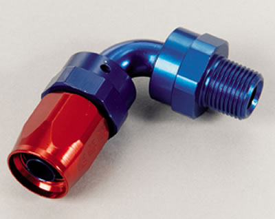

i used hose barbs instead of braided an ends and adapters. if they dont fit but you still want to use braided an you could use something like this:
bazeng
Feb 6, 2003
2,520
Melbourne, Australia
in that case, it should fit =)
they wont fit if you use the adaptors i used..
which was a male to male fitting and then a female fitting on top of that..
