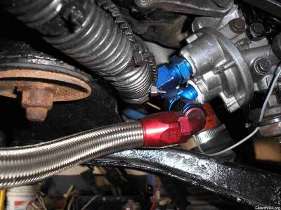

The forward facing housing will not allow you enough space for a oil filter relocation kit.. i have tried..
The bend off the screw on adaptor fouls the brace underneath..
even if you could get one that would clear just enough, the movement of the motor will probably crush the fitting...

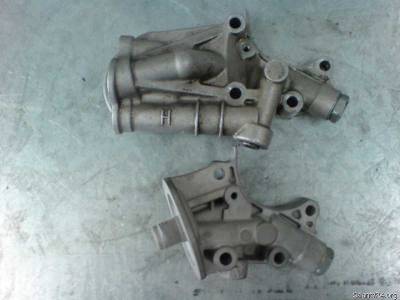

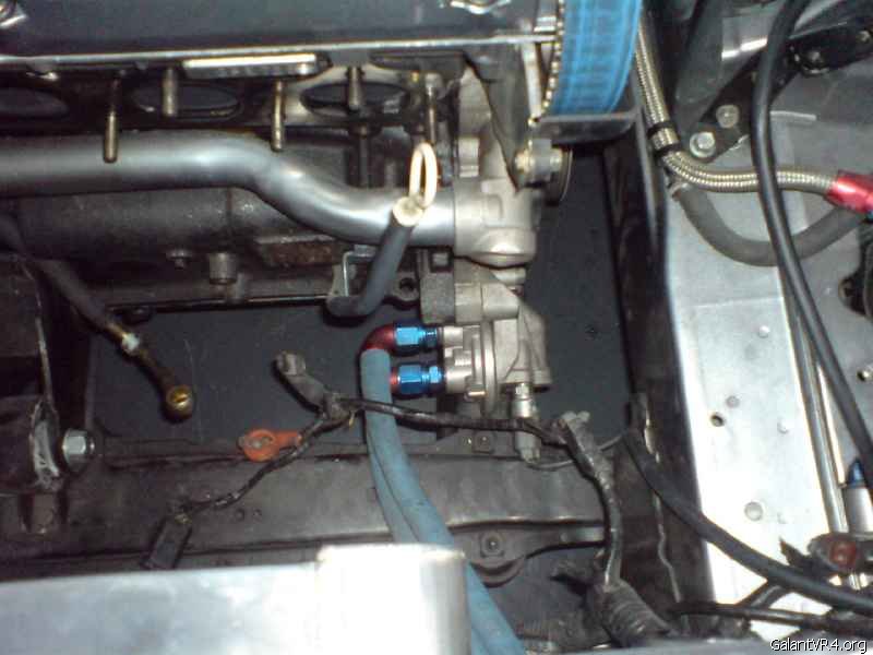

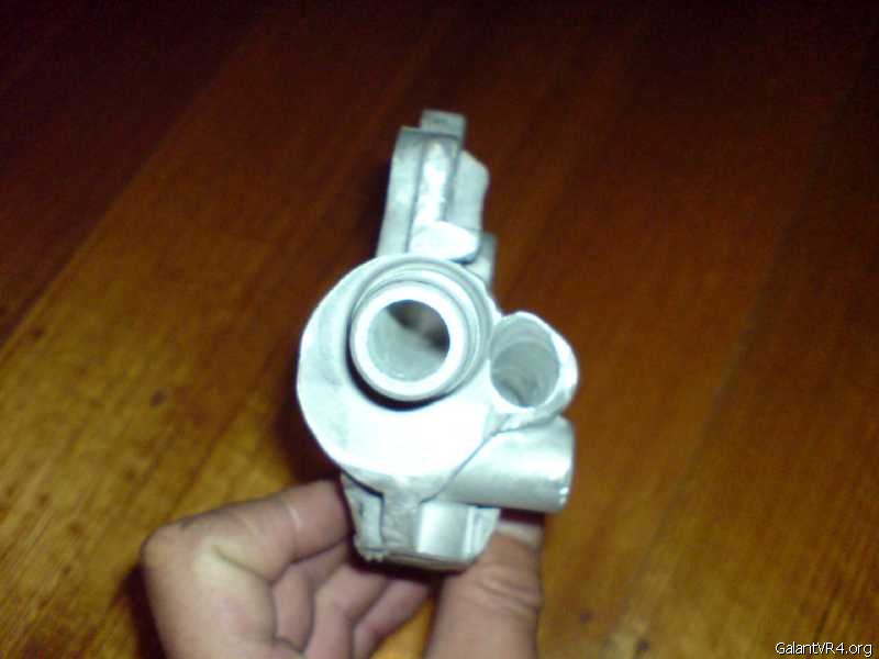

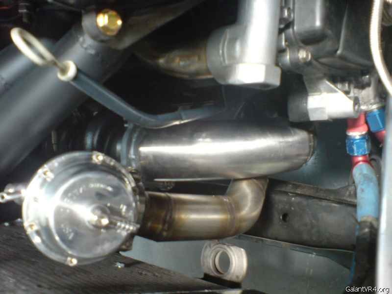

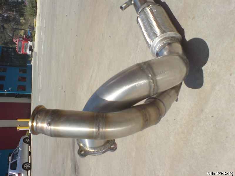

I chopped my forward facing filter up and welded on some -10 AN fittings onto it to allow for a better dump pipe..

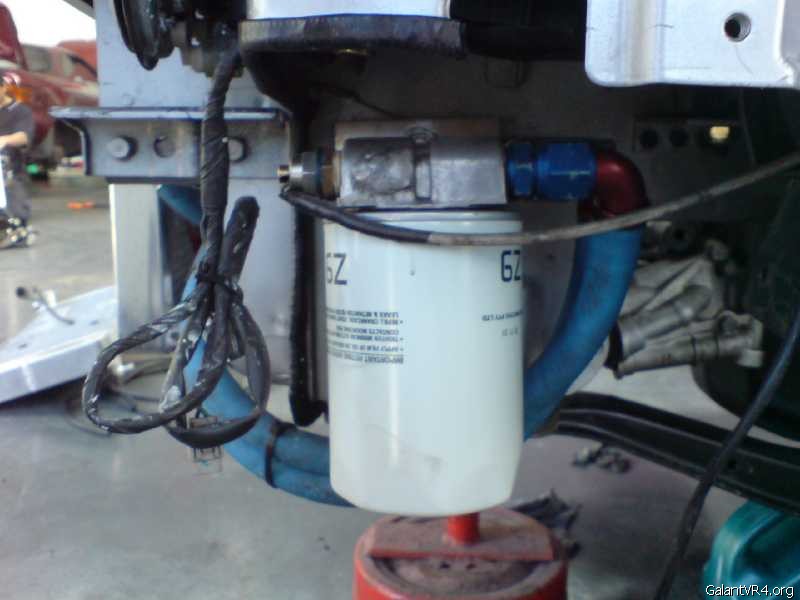

The use of a relocation kit with the stock oil filter housing doesn't really give you all that much room either...
To get the most space, the alternator and oil filter housing has to be moved..

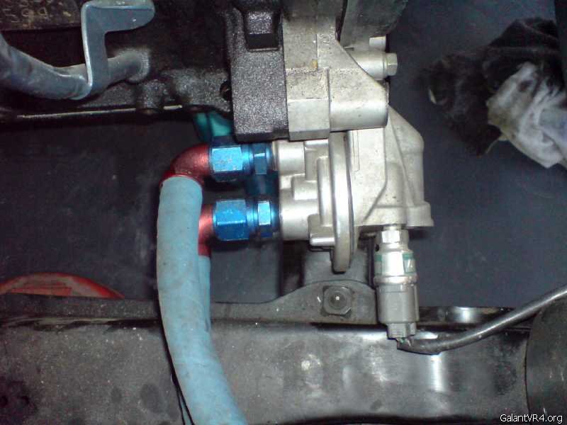

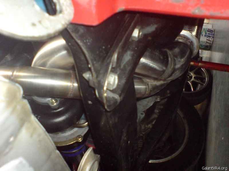

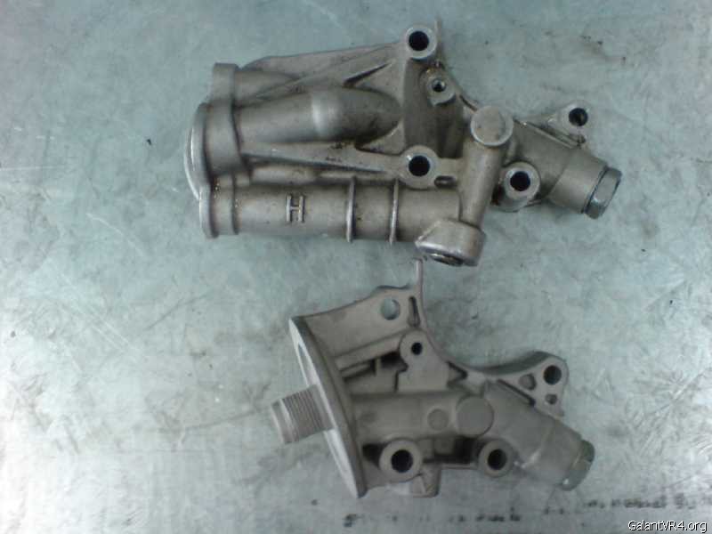

here are some pictures of my setup.
STOCK HOUSING WITH RELOCATION KIT

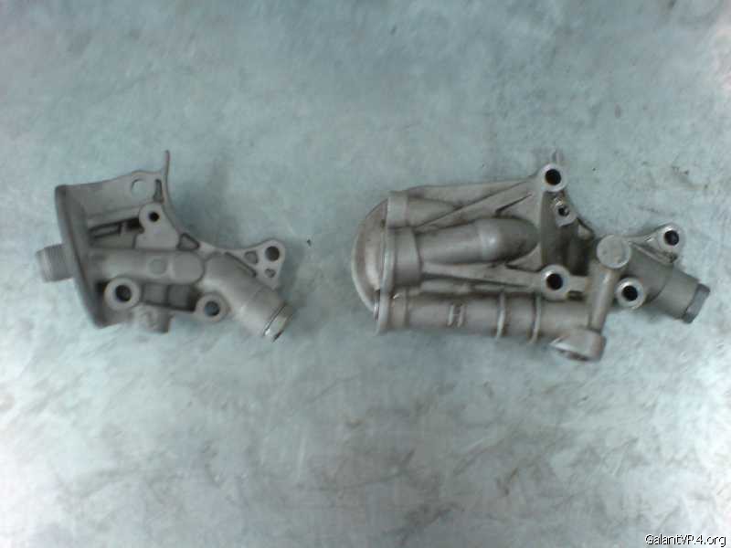

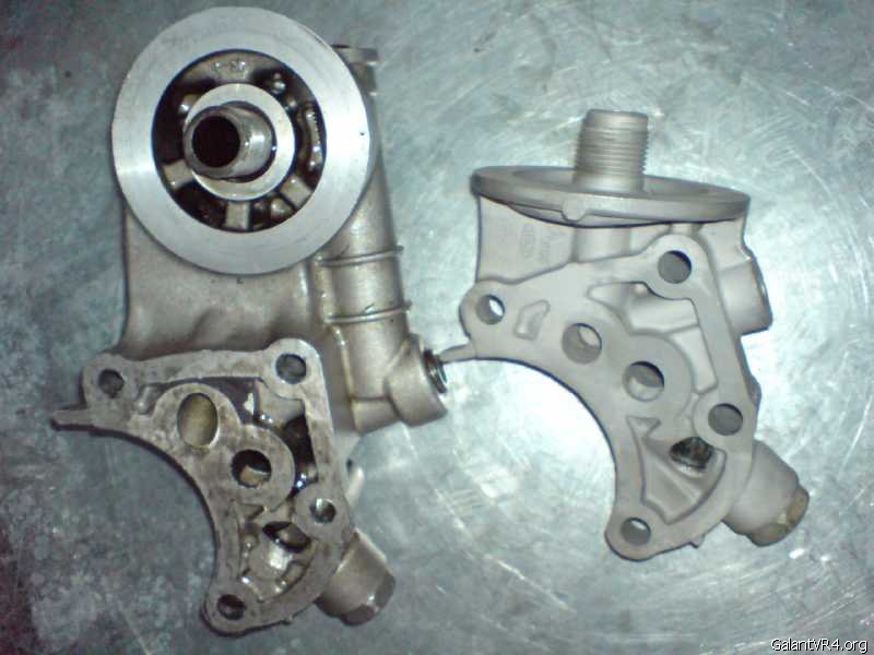

STOCK VS FORWARD FACING

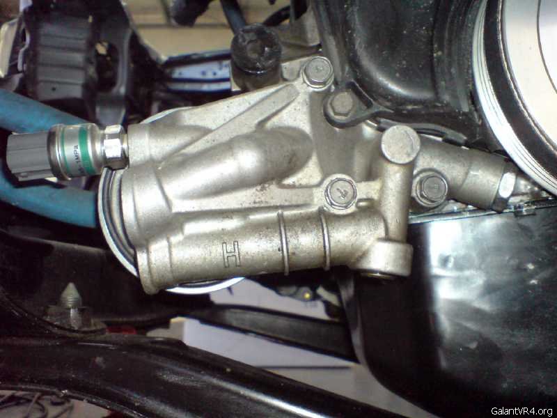

MODIFIED FORWARD FACING

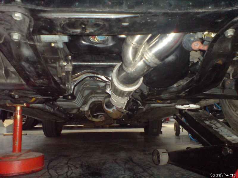

Exhaust with new setup
So the anwser i would say is NO the forward facing will not allow an oil filter to clear with the engine movement etc..
the only reason the relocation kit did not clear on the forward facing filter was because when full tight, the fittings would be verticle, not horizontal, if horizontal, the fittings would clear the sub frame..

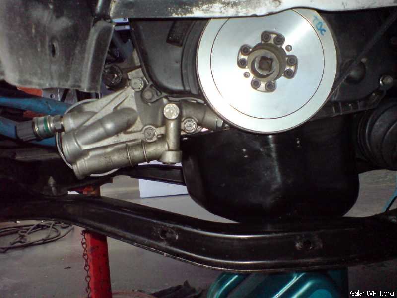

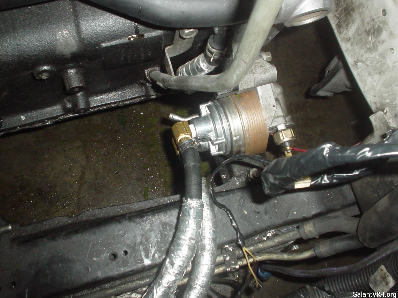

I guess you all didn't look at the link I posted.
Here is as picture of the forward facing housing, installed.
