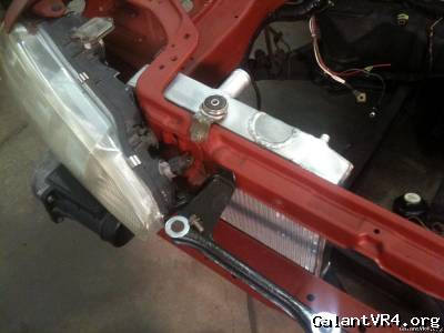

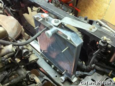

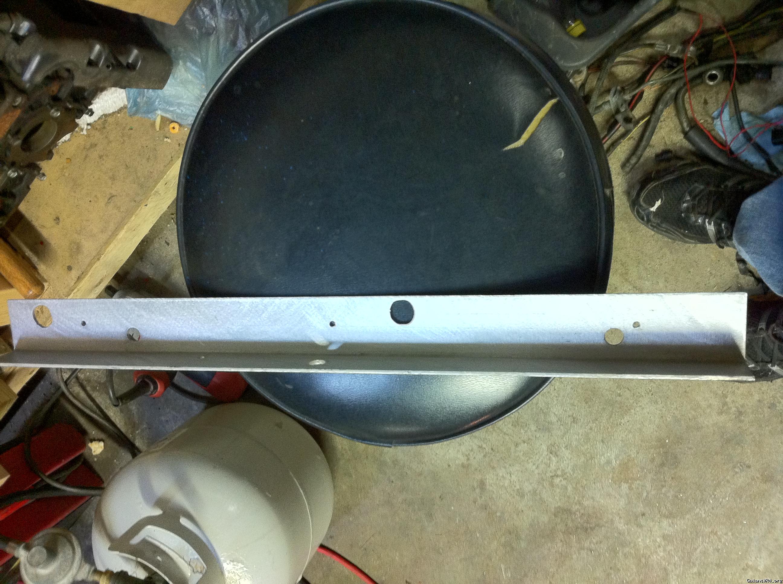

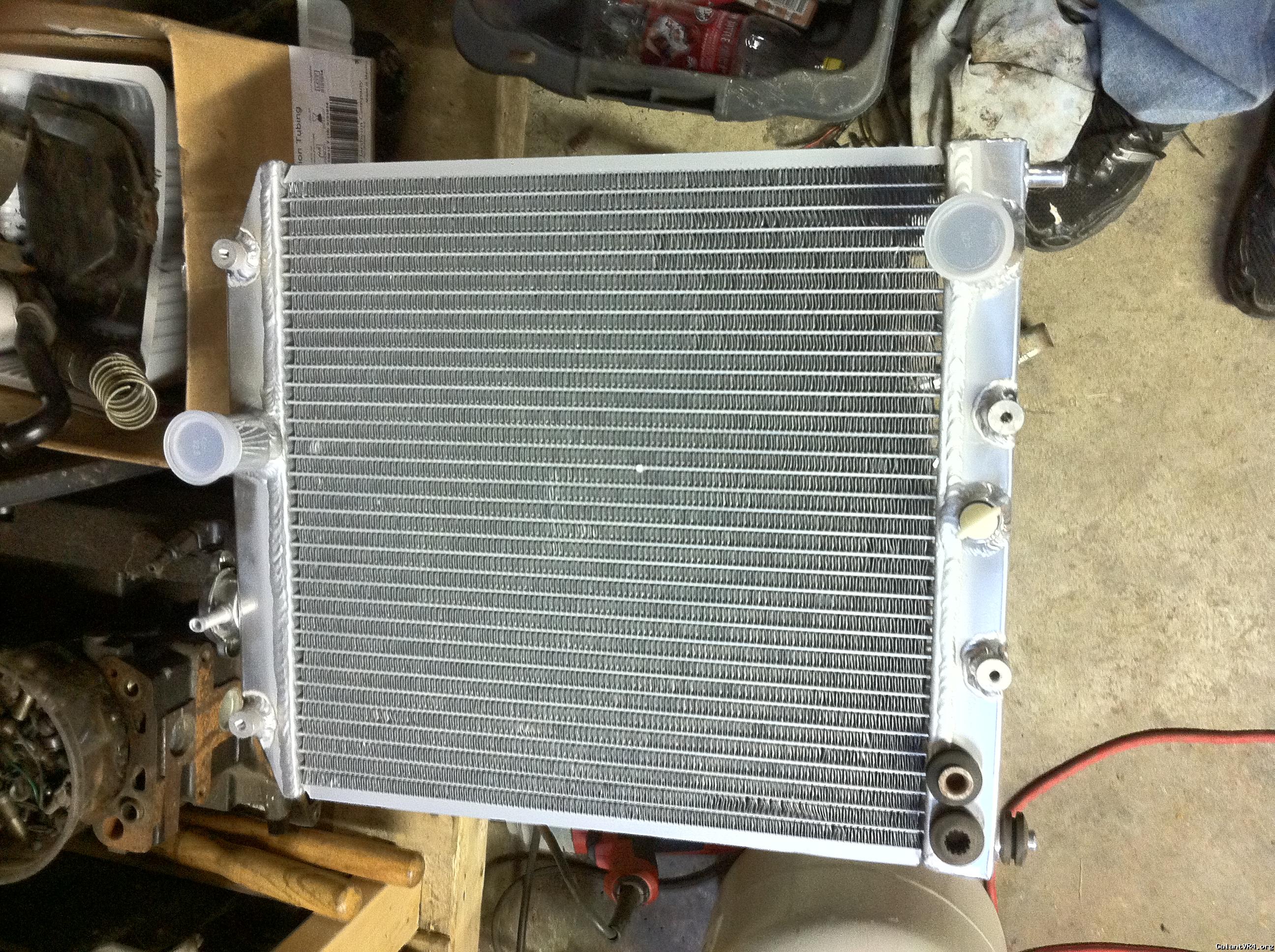

That bracket looks nice. Makes it easy to lift out while doing work, cool.
For some reason I thought Id make my half sized rad. bolt-in. lol.

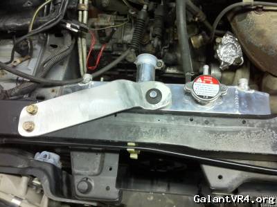

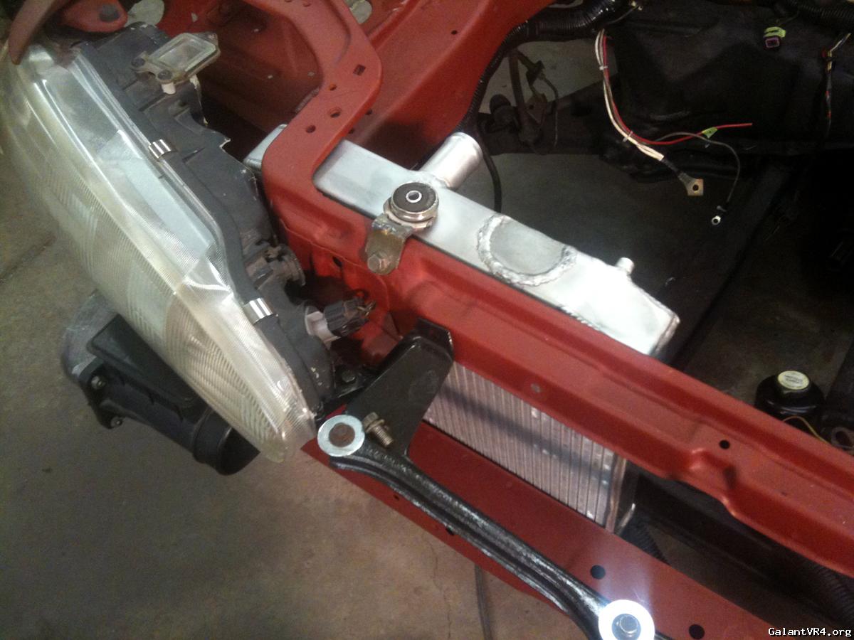

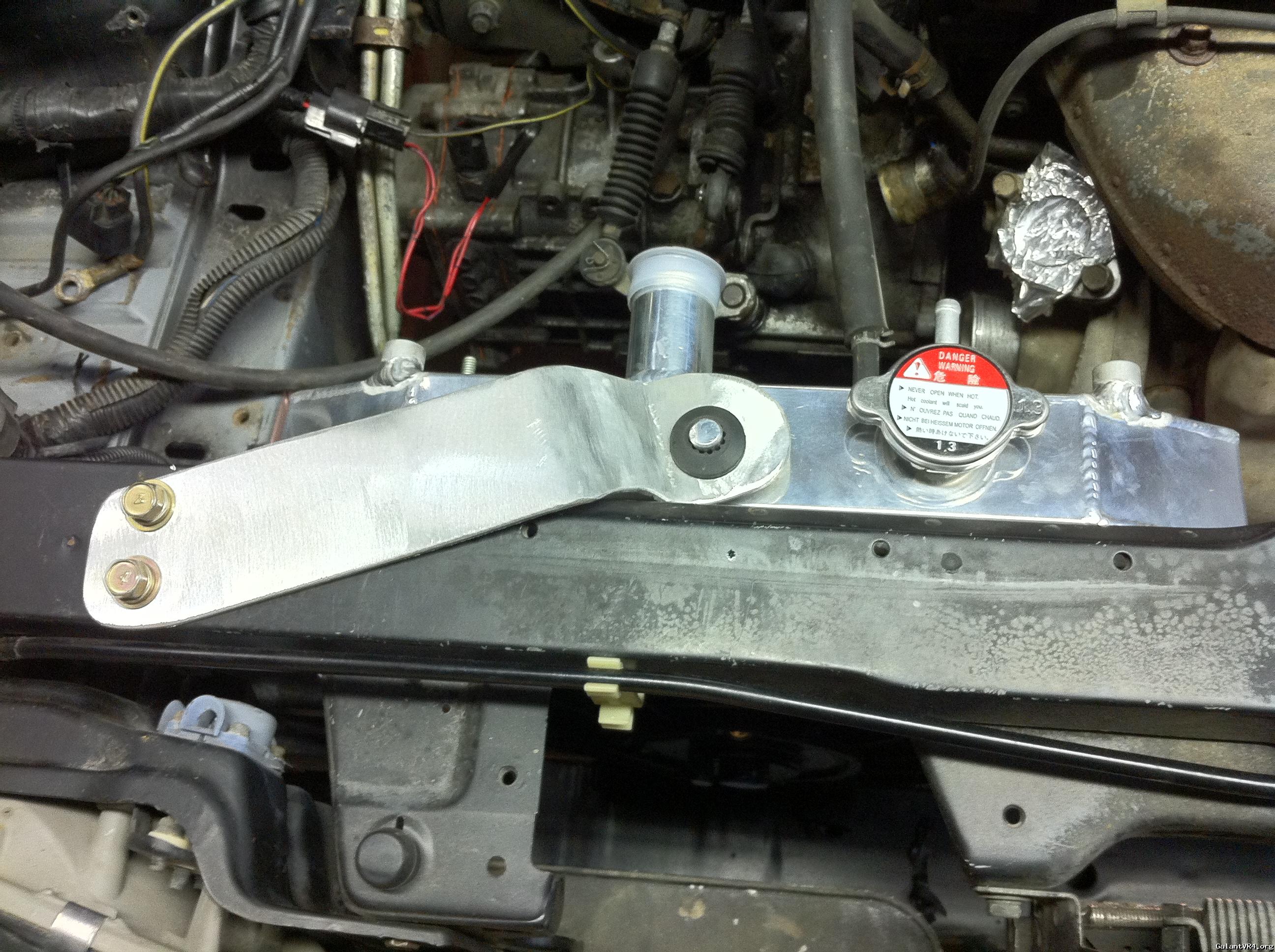

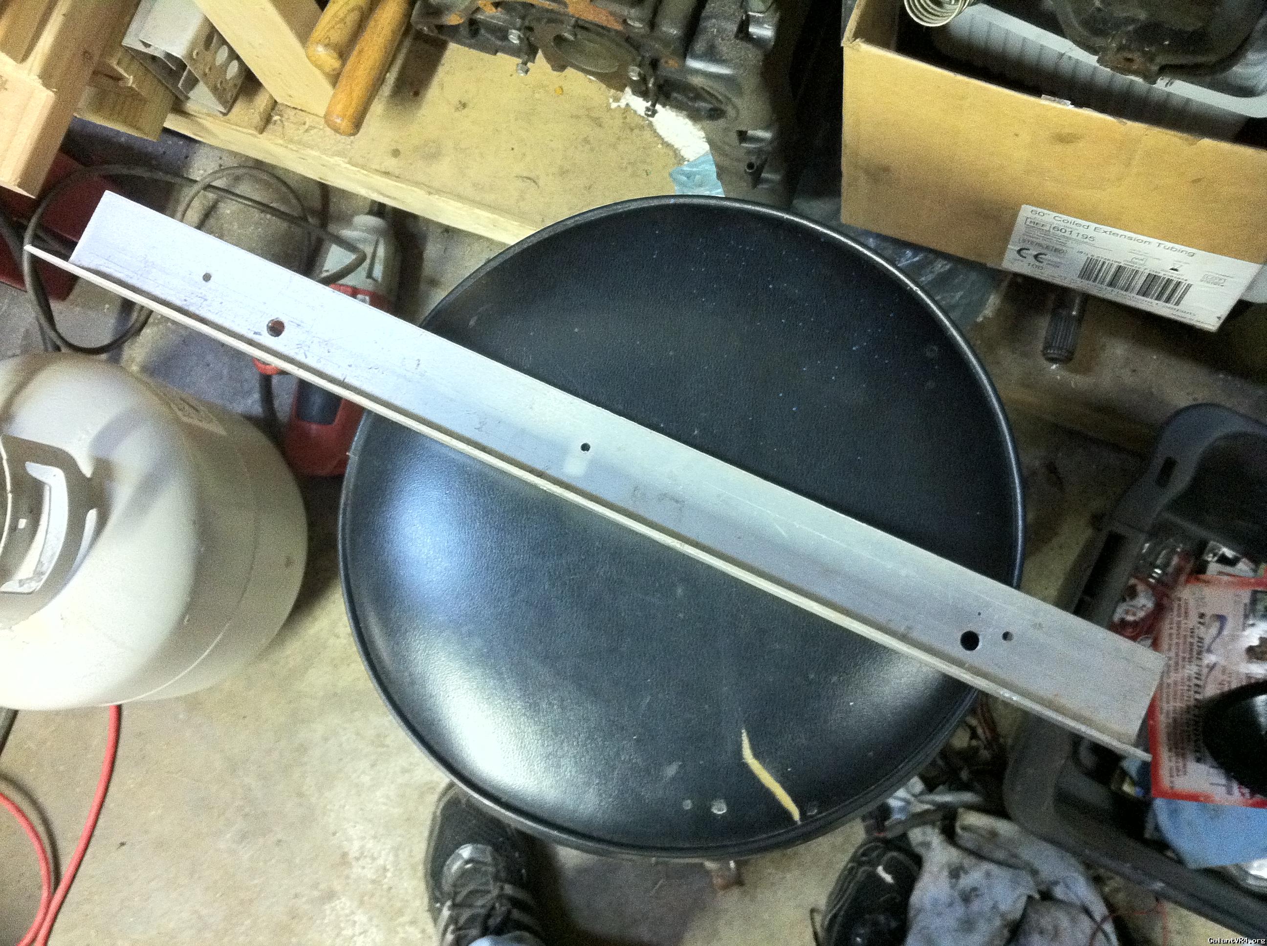

I like the top mount bracket, custom work I presume... /ubbthreads/images/graemlins/smile.gif
14u2nV
Jul 22, 2004
9,398
Agency/St. Joe, MO

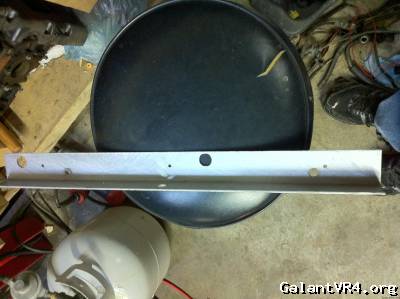

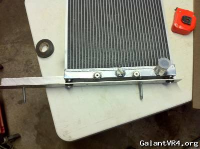

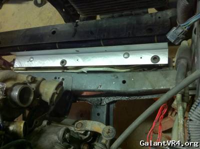

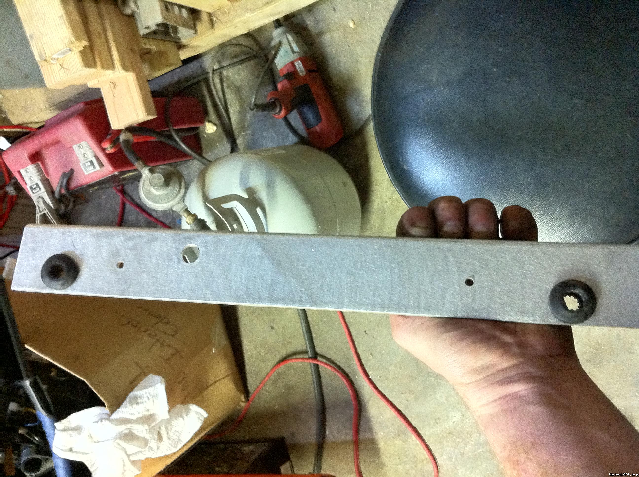

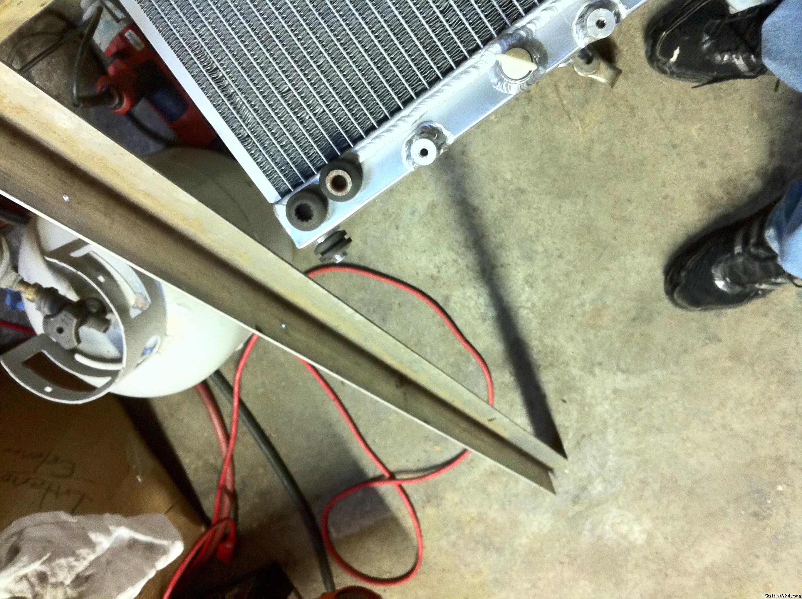

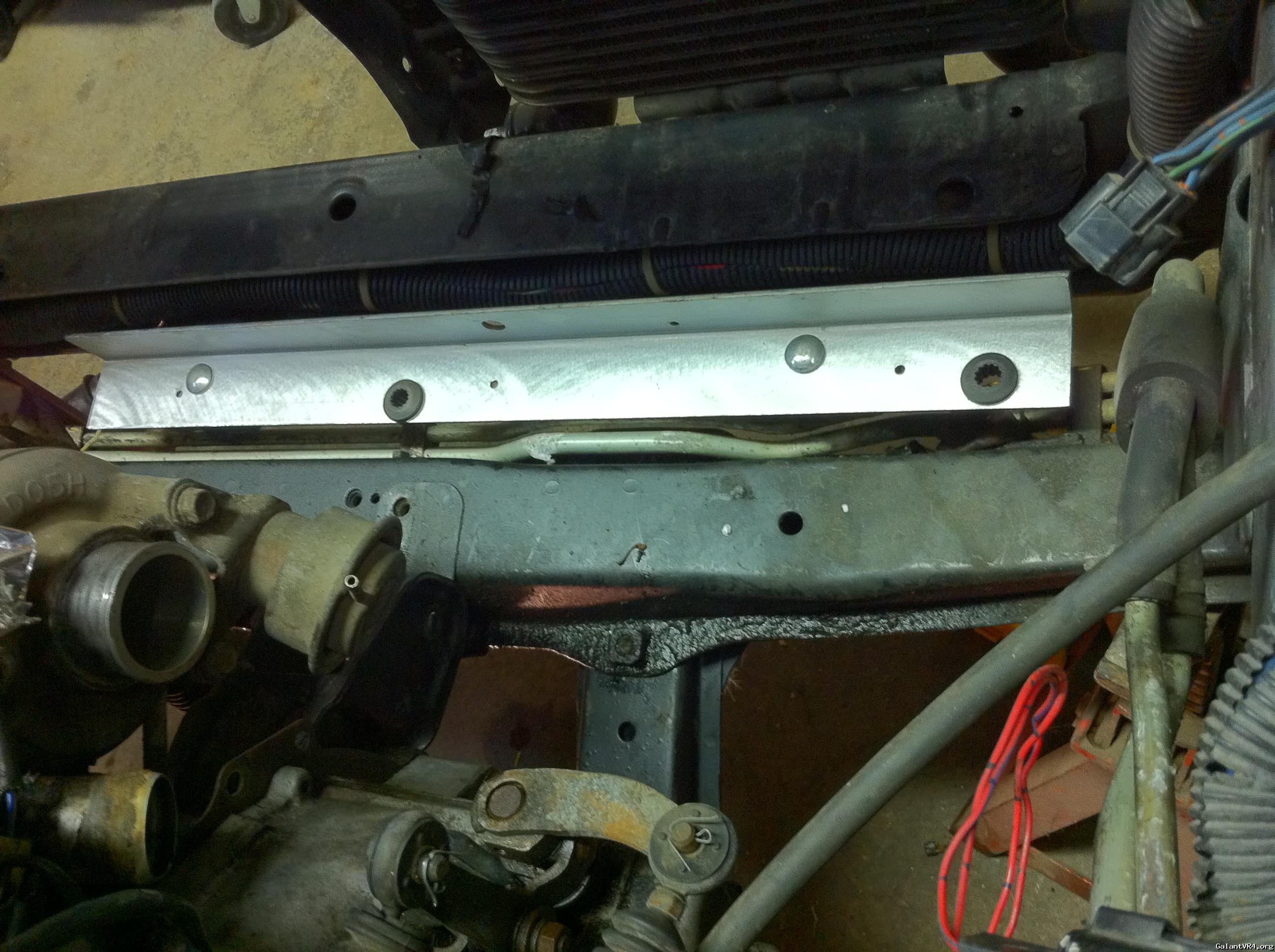

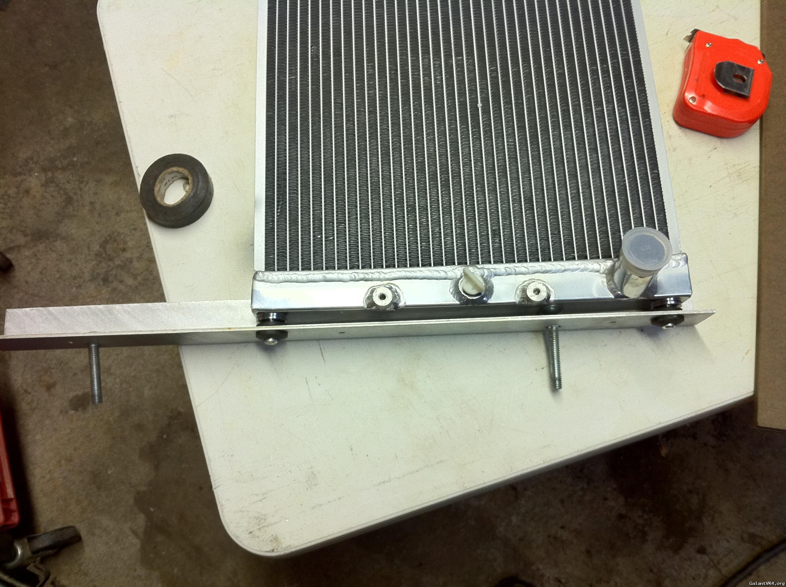

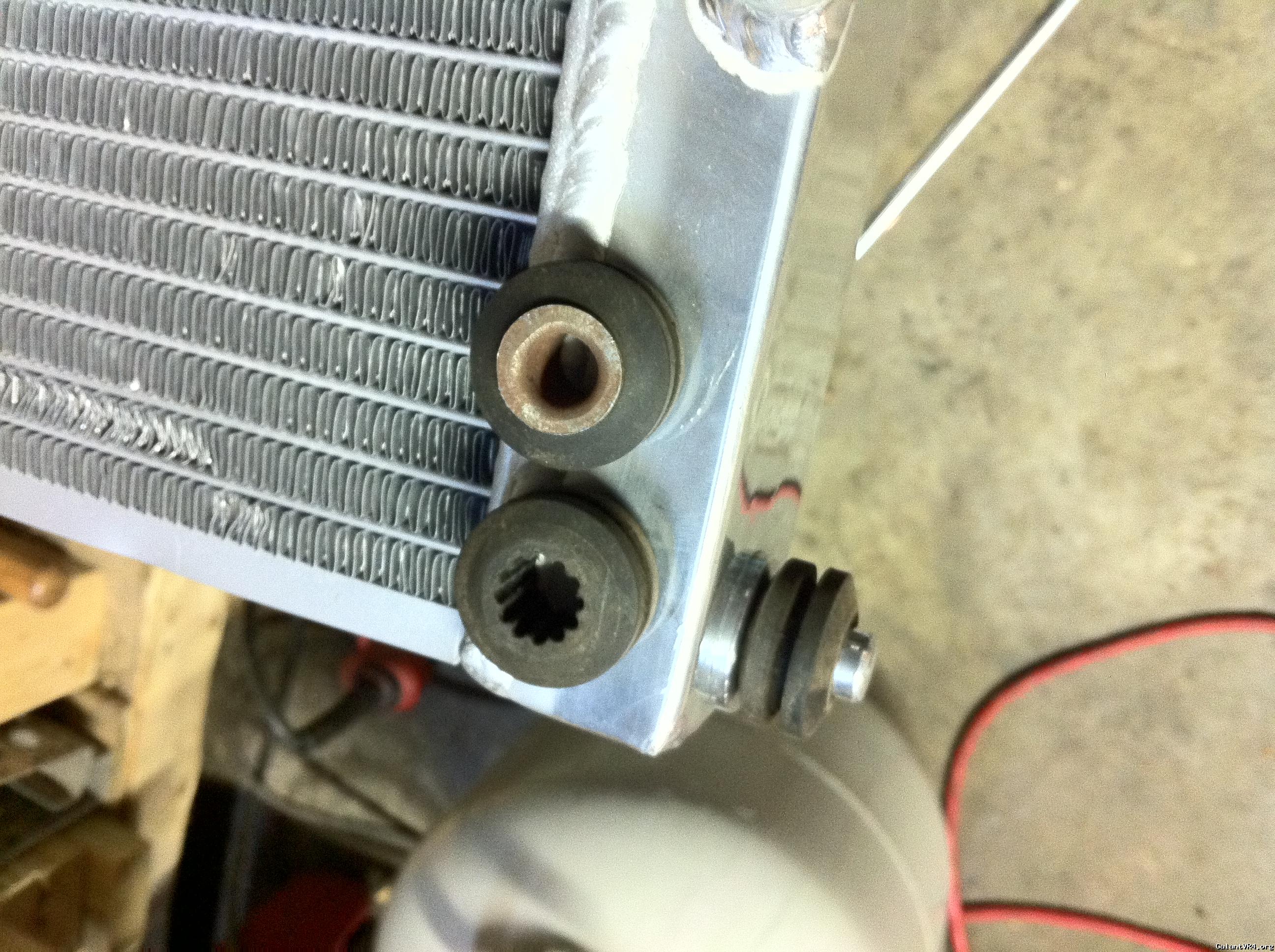

Thanks. Yeah, having the bottom bracket makes it sooo much easier to get the radiator out. The bolts in it go thru the stock radiator bushings and have a big washer on the bottom. I made the top bracket cuz I hate to make new holes in the car when I can use what's there. My I/C bottom brackets look similar, I'll try to get a pic of them tomorrow.
