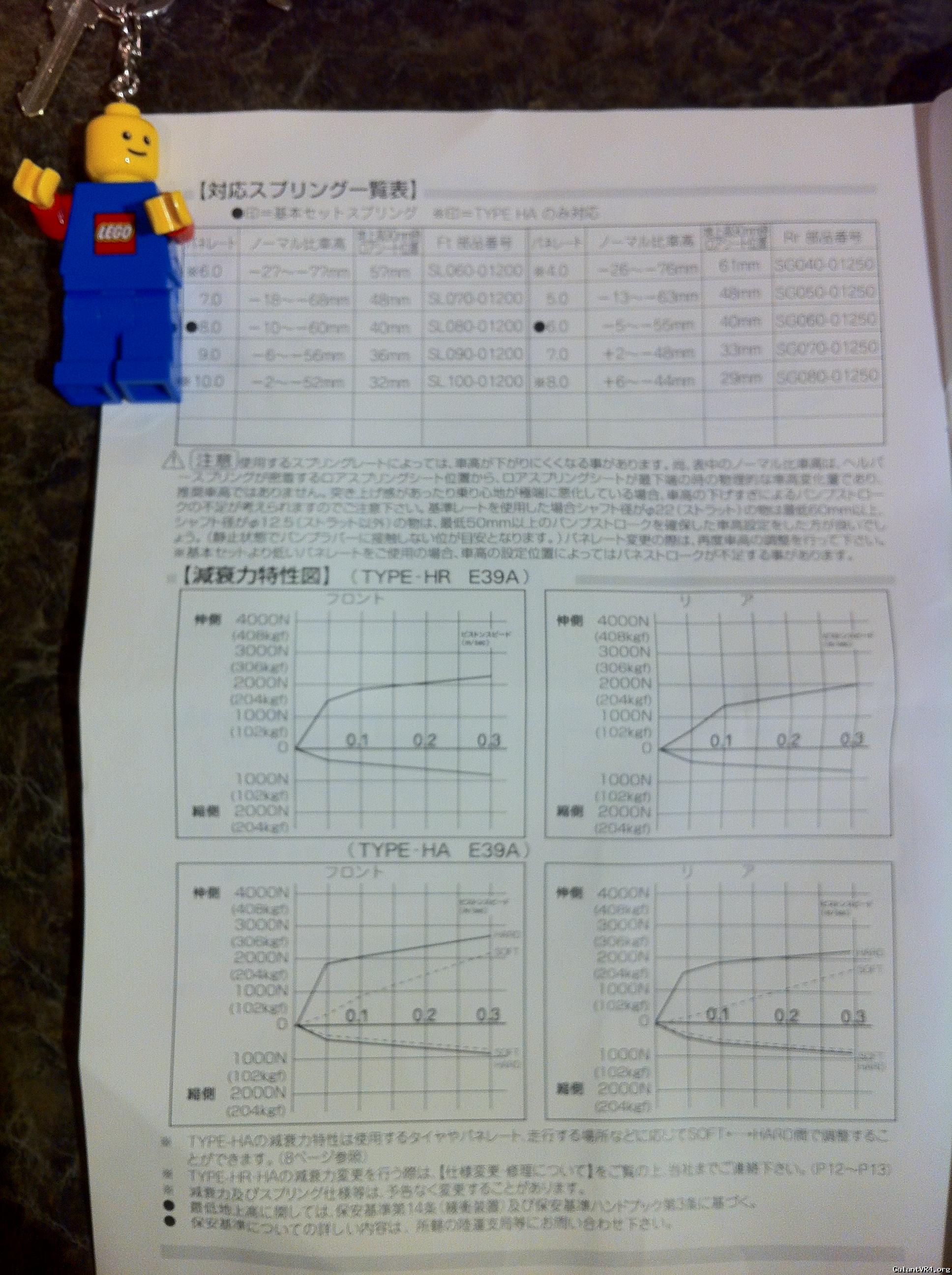

Ill pull out the Tein book later on and see if I can see those spring rates.

I got ahold of the guy that sold me the JICs. He says the springrates are 8k front, 7k rear. Or 450lbs/393lbs. I don't think that's far off of what the spring rates were for the Teins, but the valving is much softer making for a better ride on the street.

Legoman reckons its 8kg front and 6kg rear (but he has been wrong before)
