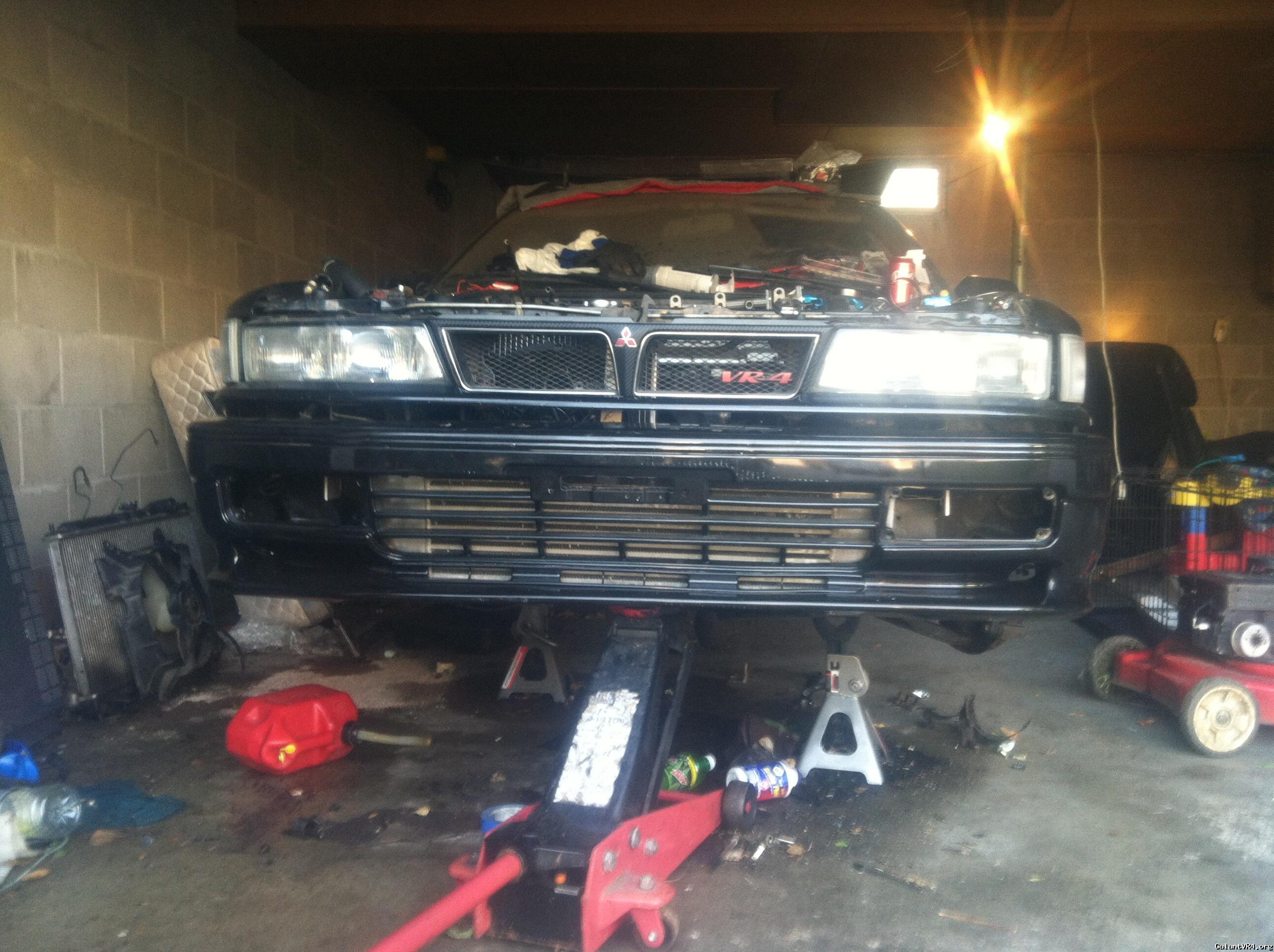

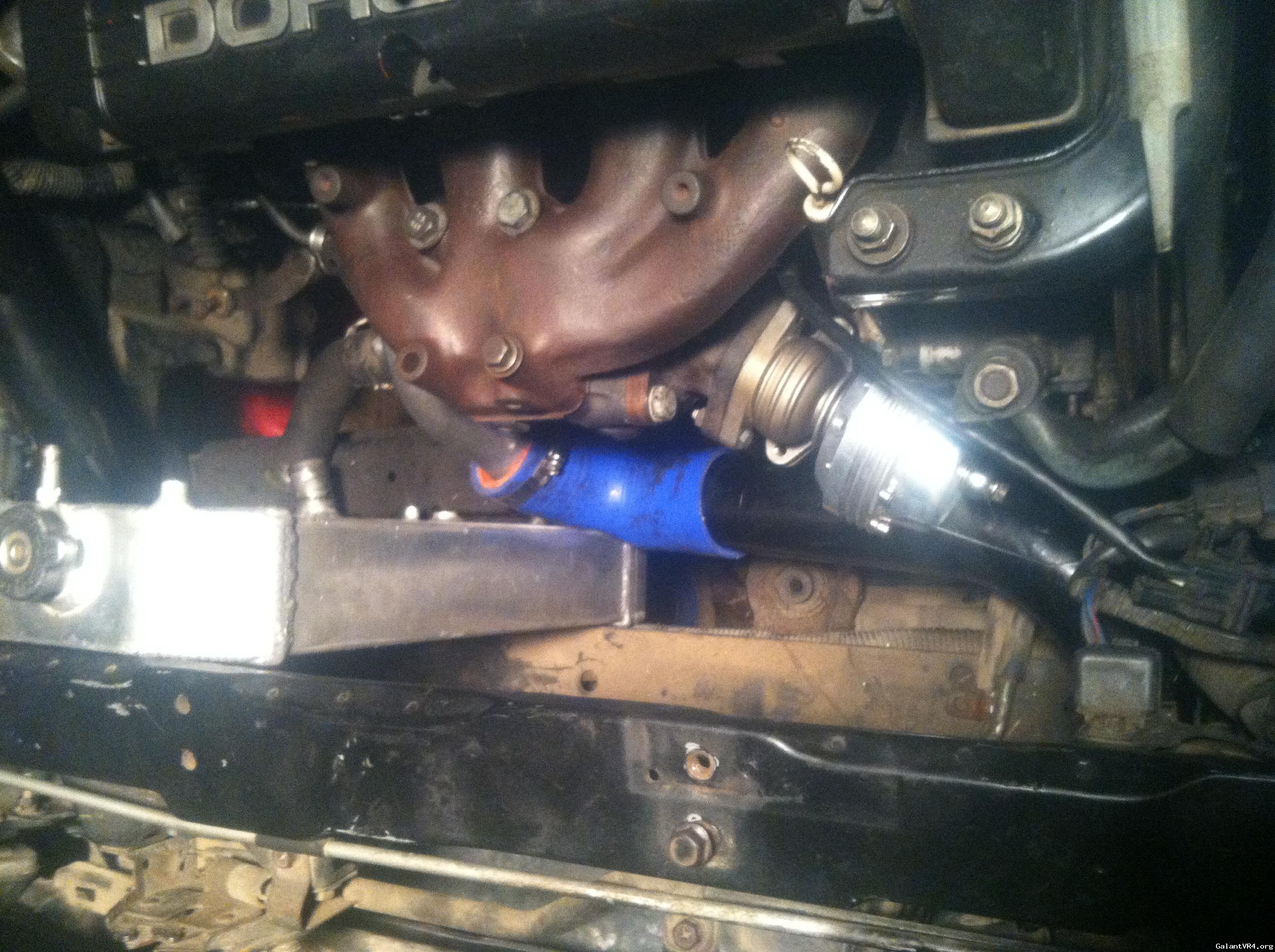

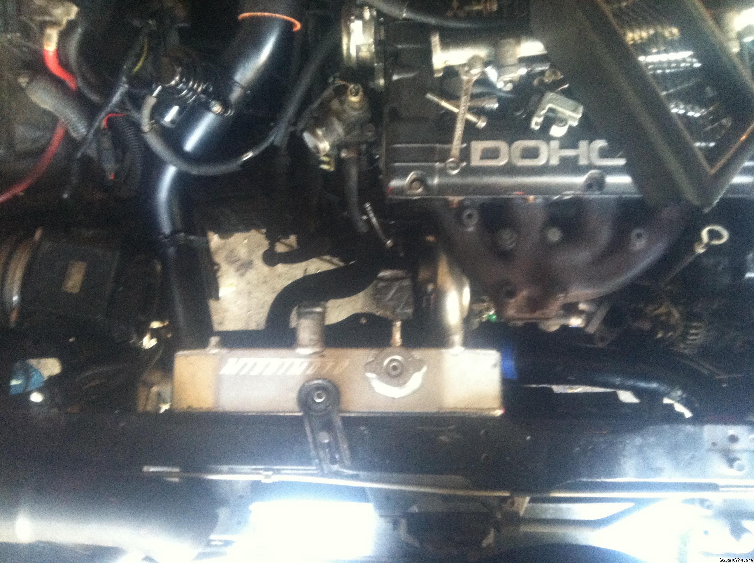

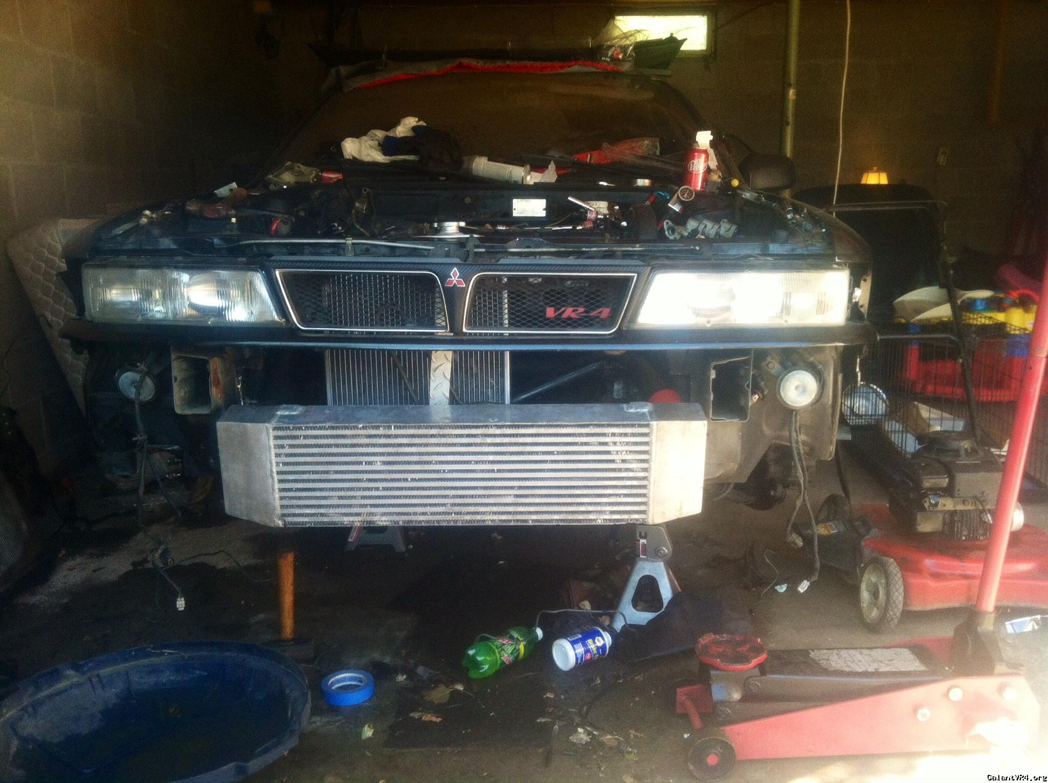

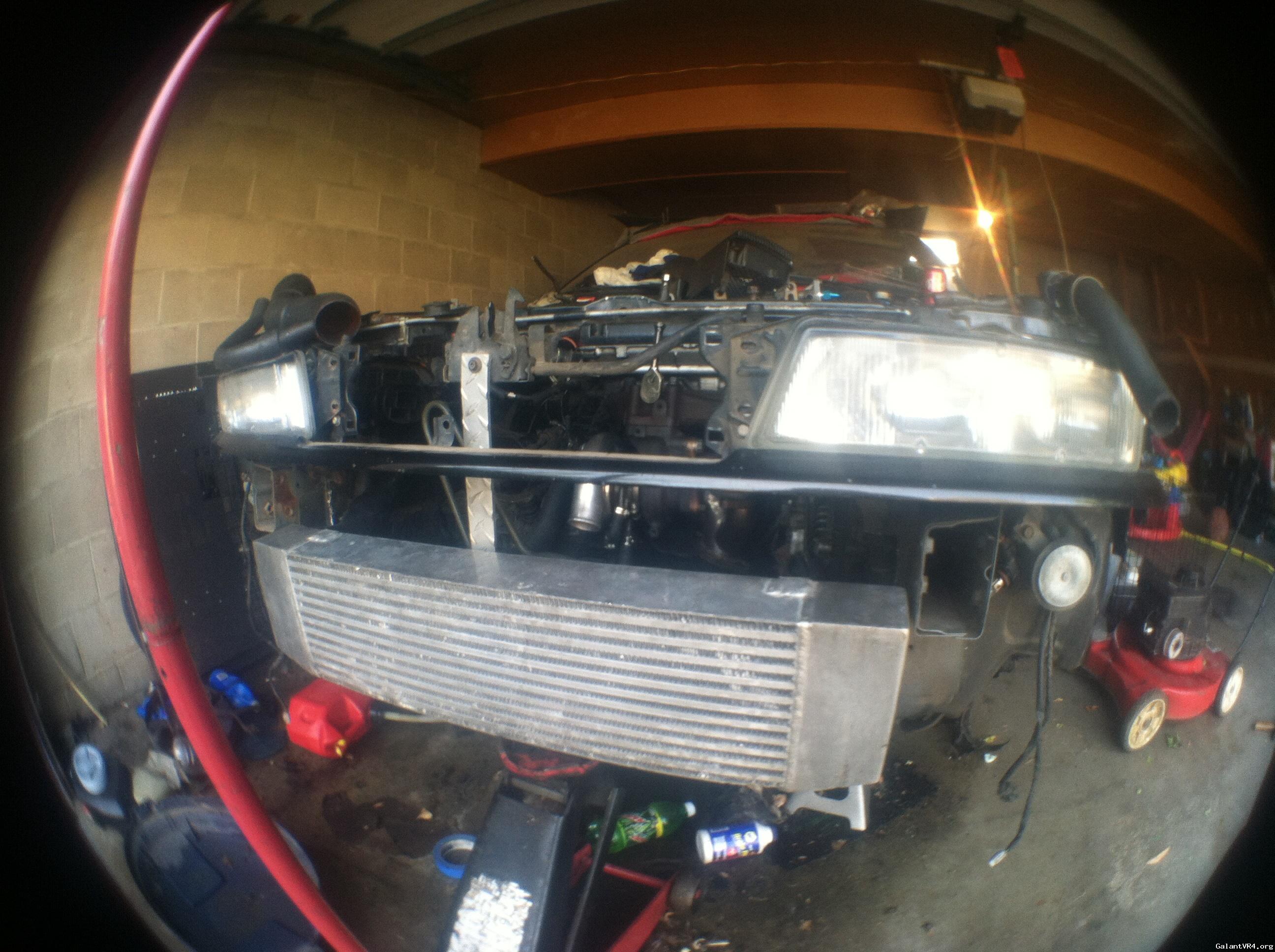

I went for the shortest possible route with an IC. Without an IC it can be even shorter if running E85. But that's another topic.
Here's how mine is routed:
Top fed IC with half size radiator placed in the middle.
All steel 2.5" pipes. No long flexible sections.
