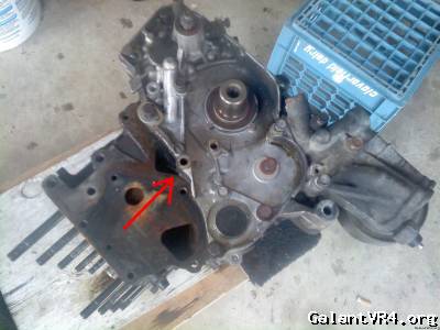

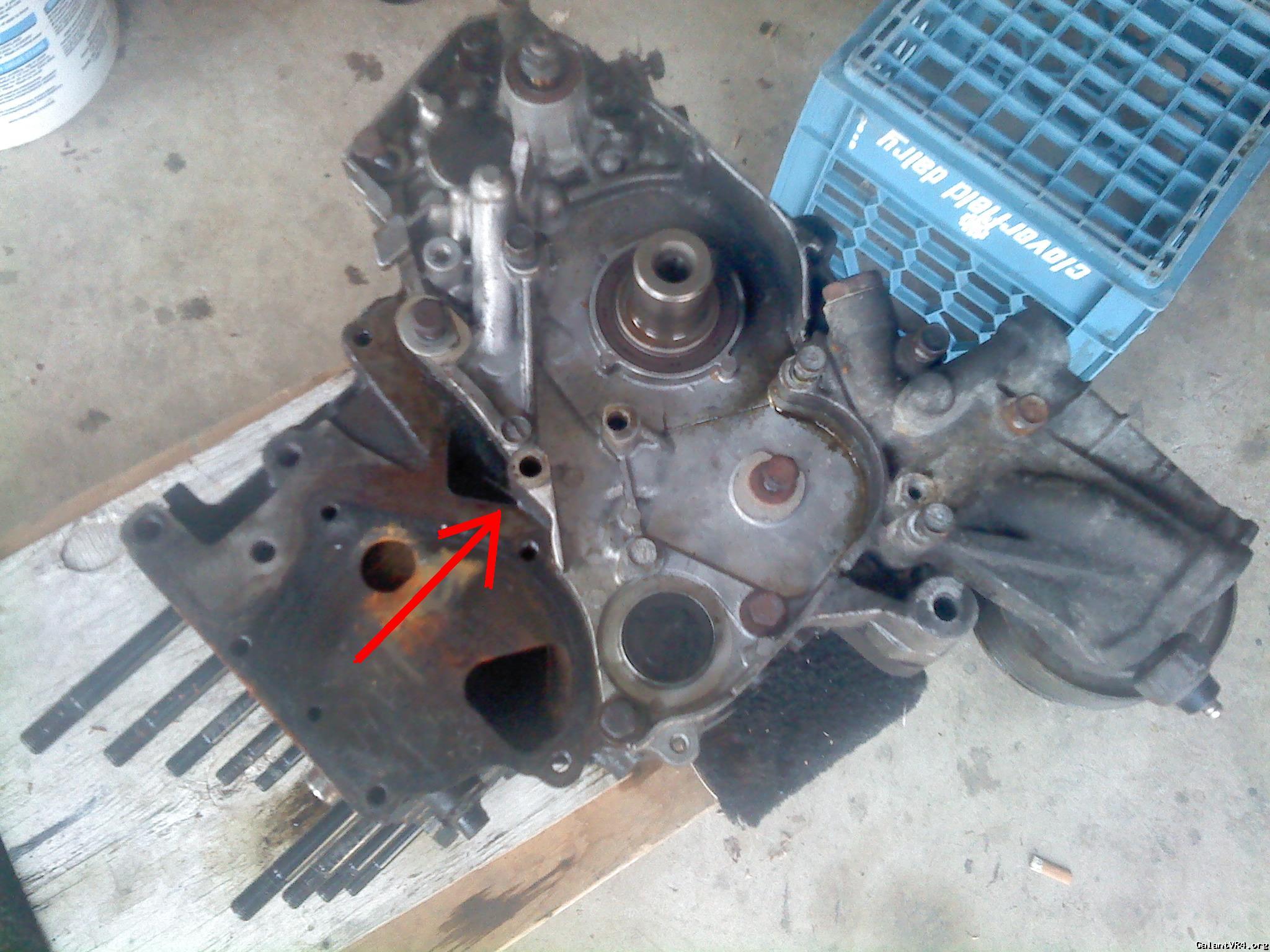

but here's this pic again. the broken bolt that was over torqued into the old block and the head snapped off and needs replacing

hey guys. found the bolt. i wasn't paying attention, that hold and the broken bolt are from the tensioner. dur.

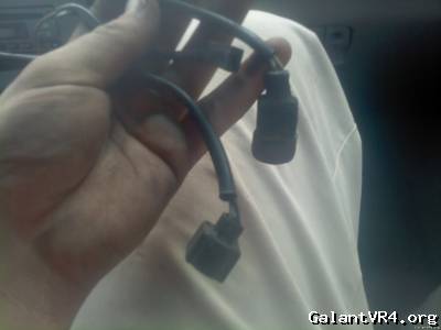

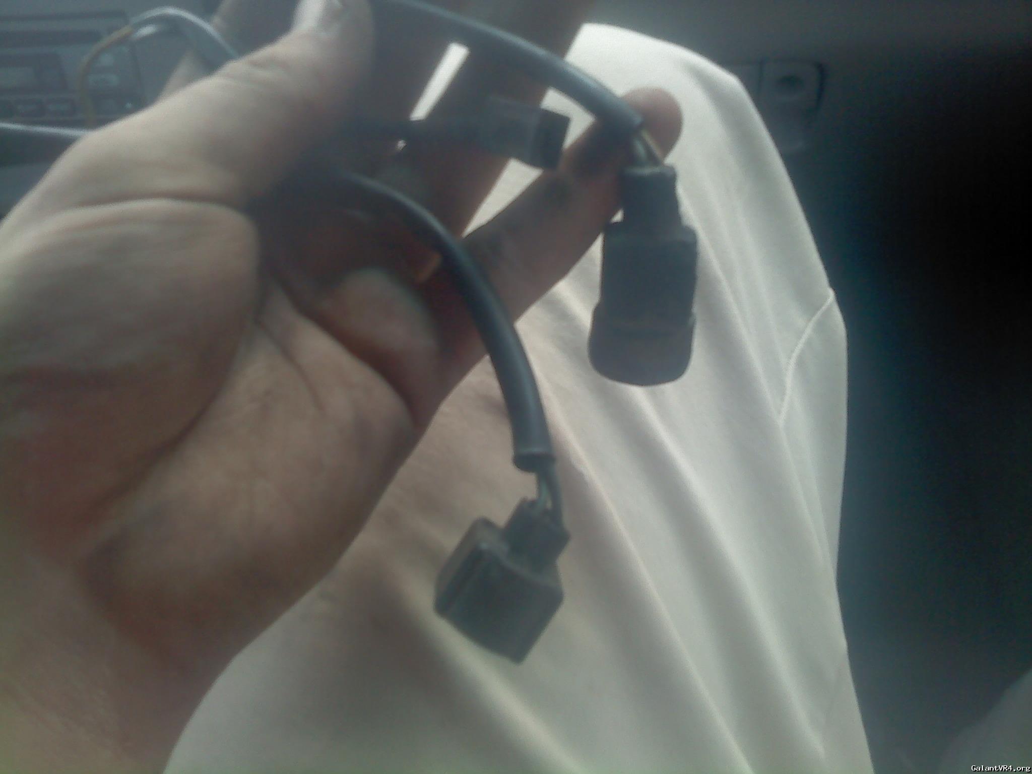

here's some pictures of my only wiring problem. help?! the wires with the missing plug a plug are supposed to go into the top of the thermostat. and the plug you see is frayed and pretty much totally disconnected from the wires
(bottom of thermostat)

hey everybody. hope everyone's week is going well
got off early and made it up to the junkyard in mt. airy with a friend
almost made it through the whole yard before we found the only DSM in the lot, a 1990 or 1991 talon
of all the ganged parts there was a beautiful stock steering wheel and these guys:
no more thermostat plug dilemma!!
