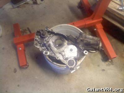

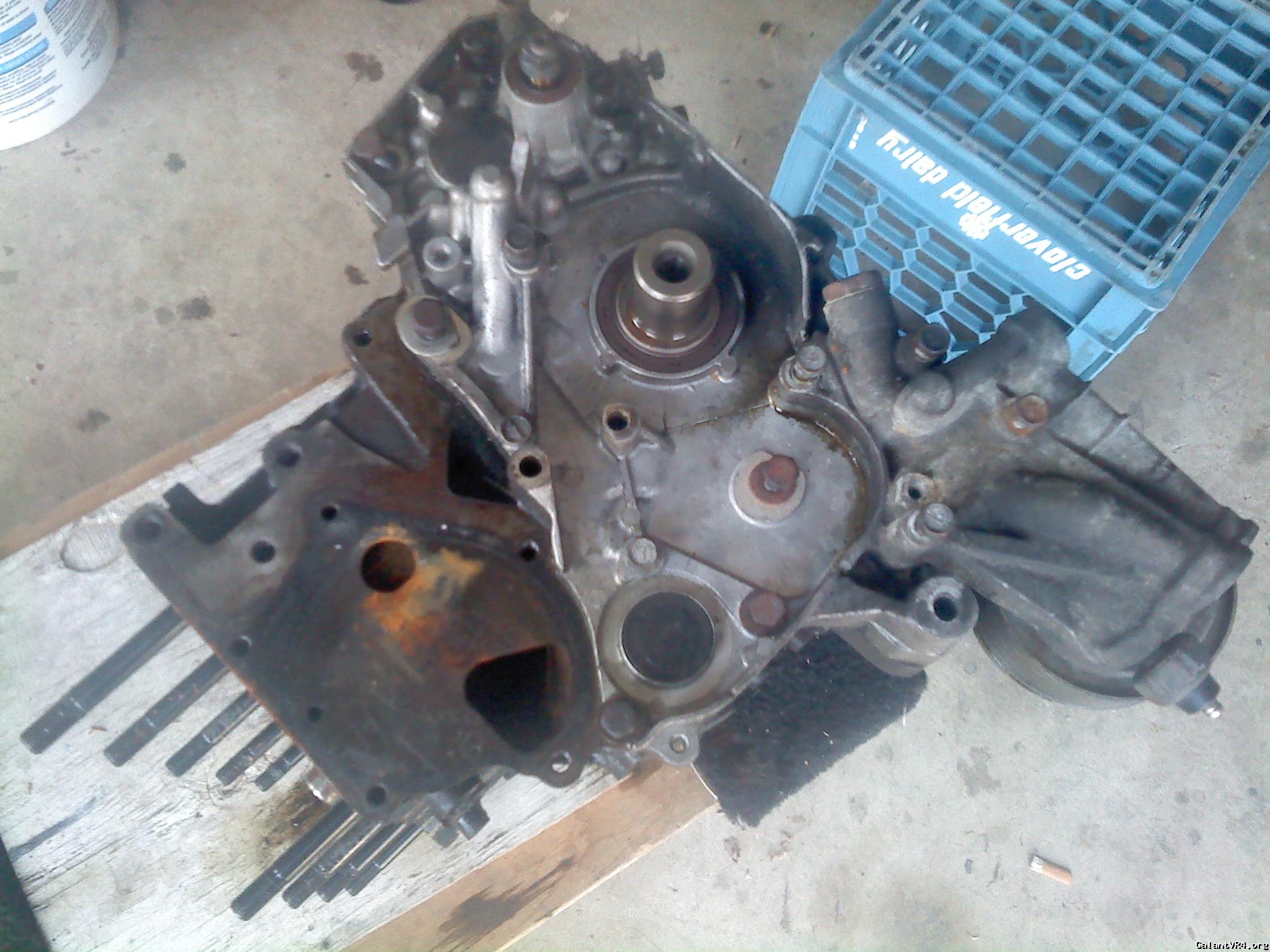

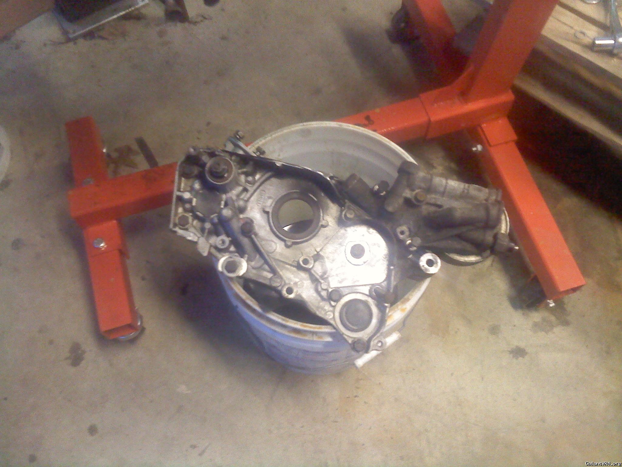

i can't get this bi*ch off. i've tried everything and im about to take my hammer drill out of the work truck (i wont calm down and YES every bolt and fastener is loose they are just in place in the picture) but this has to be gasket sealer from hell or what they use to make sure parts don't fall off of a space shuttle...

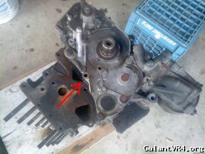

i have to replace one of the bolts on the front case that came broken when i bought the car, will post pics of it tonight. but my friend was telling me that with a balance shaft delete, there's a screw hole that needs to be blocked up? i tried looking around the forums but only came across your typical balance shaft delete kit (which is already installed on me front case and i'm reusing the front case), does anybody know what he's talking about here?

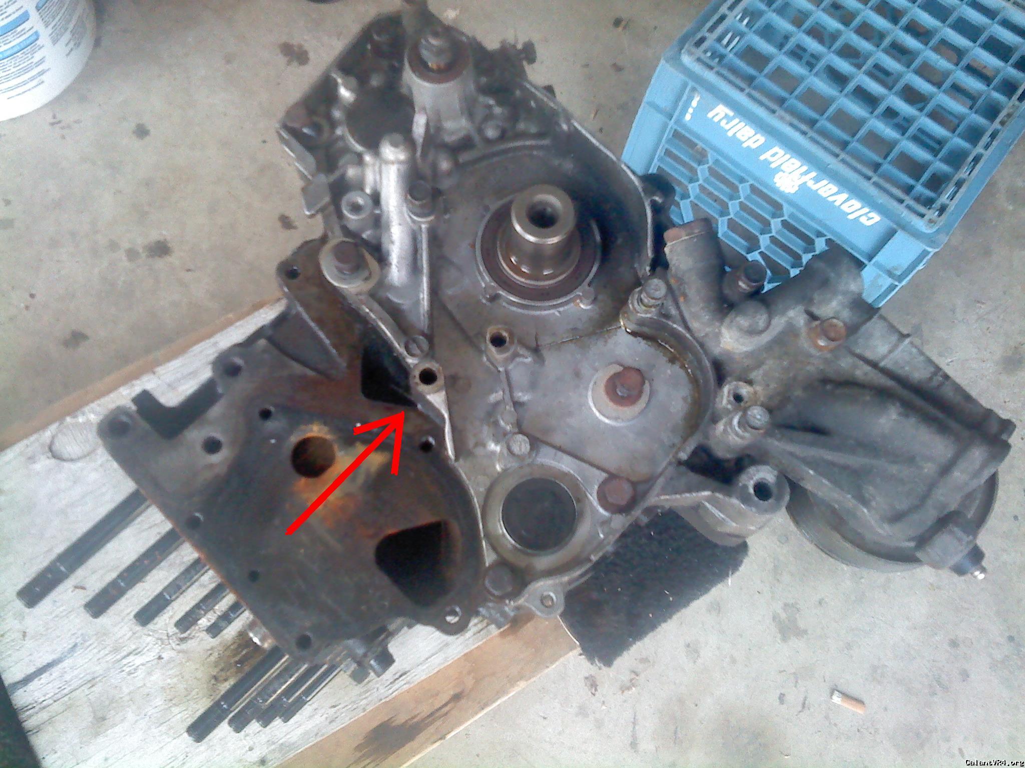

here's some pictures. i'm having trouble finding part numbers for specific bolts

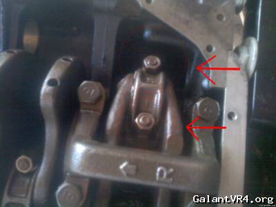

the red arrow indicates the bolt that's broken in the old block, previous owner may have over tightened it and broke the head off it looks like.

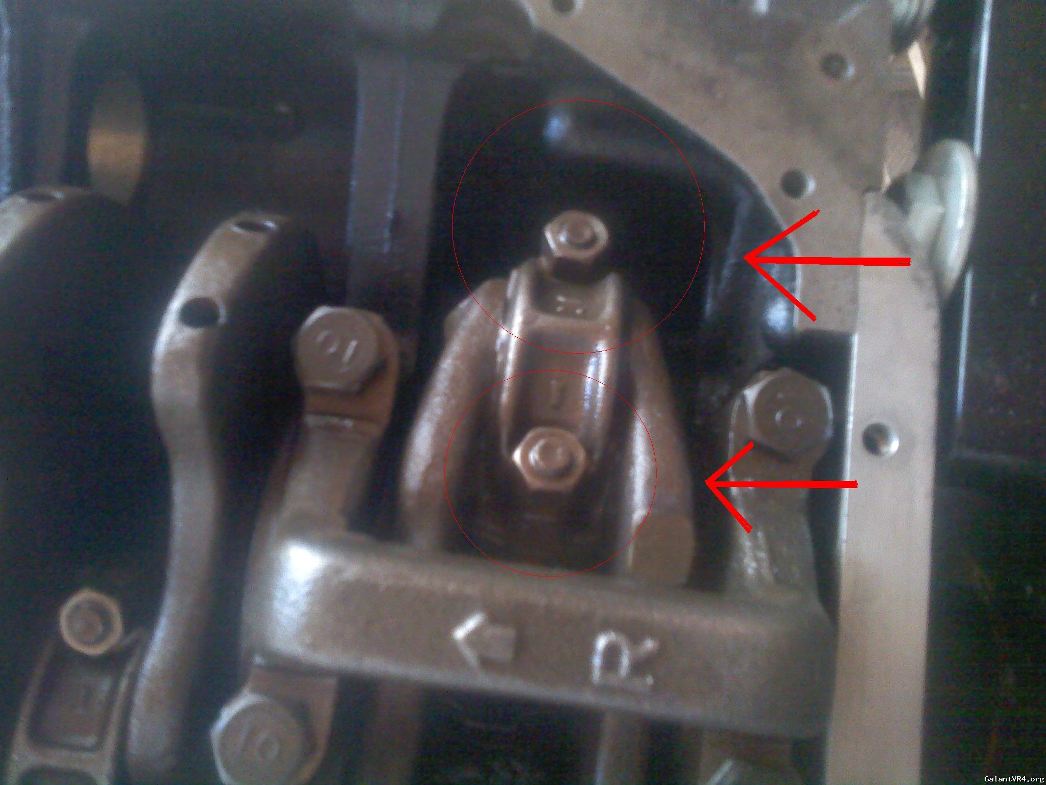

my only major concern at this point is in the block. i purchased to block from a kid who builds 4g63's so it eased my mind i was buying it from someone who had 3 other blocks and misc. parts laying around. but after i bought it he text me saying he totally forgot to torque the bolts to the rod arms (i know my terminology here is wrong) and i should torque them down to 38lbs.
i did this but for a couple nuts right before i was expected the torque wrench to click, (and forgive me if this depiction doesn't make sense) the spinning almost softened up like a had stripped the threading. when this happened because they were tight i just moved on to torquing the next nut. should i just throw the engine together or further investigate, keep in mind i bought this rebuilt block i didn't do it myself. i would hate to put this engine back together then have internals on the block go bad...

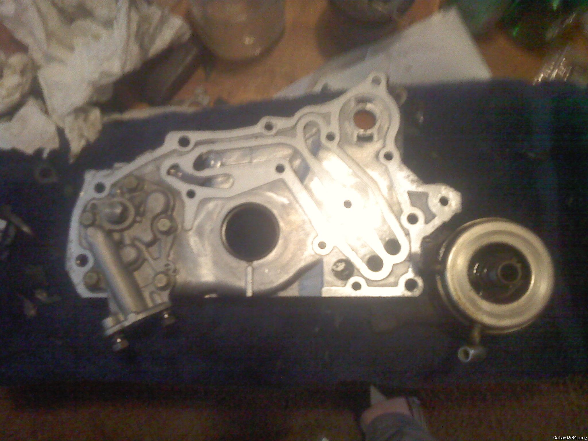

clean and ready
this is what he text me telling to torque down to 38lbs. im just a space cadet right now with allergy meds in me. so when i went to torque them i think maybe 3 of them? never two on the same cylinder, would tighten up and right when it felt llike the torque wrench should click, it kinda just ever so softly gave way instead, hope that makes sense

im trying to go to advanced like right now but im having trouble finding out what part number those nuts are. are they the rod connecting nuts? turns out i stripped the threading in one of the nuts

ok so i think the nuts indicated in this picture are called the connecting rod cap nuts. and they're supposed to be torqued to 14.5lbs. i stripped a couple torque'ing them to 38lbs as directed from person i bought the block from (this doesn't inspire confidence in the block at all) so now i have to get all new ones. i'm having trouble identifying the size and threading of the nut. i believe its m8 x 1.0 or m8 x 1.25

Quoting Number996:
hope that's not the connecting rod nut, just looked it up and it's supposed to be 14.5lbs?
According to the factory service manual, the correct torque for the factory connecting rod hardware is 36 to 38 ft pounds.
