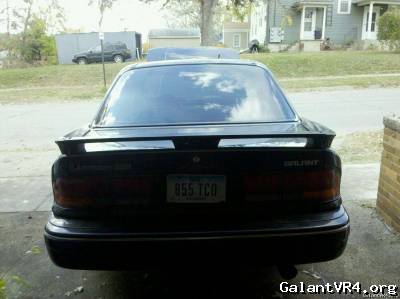

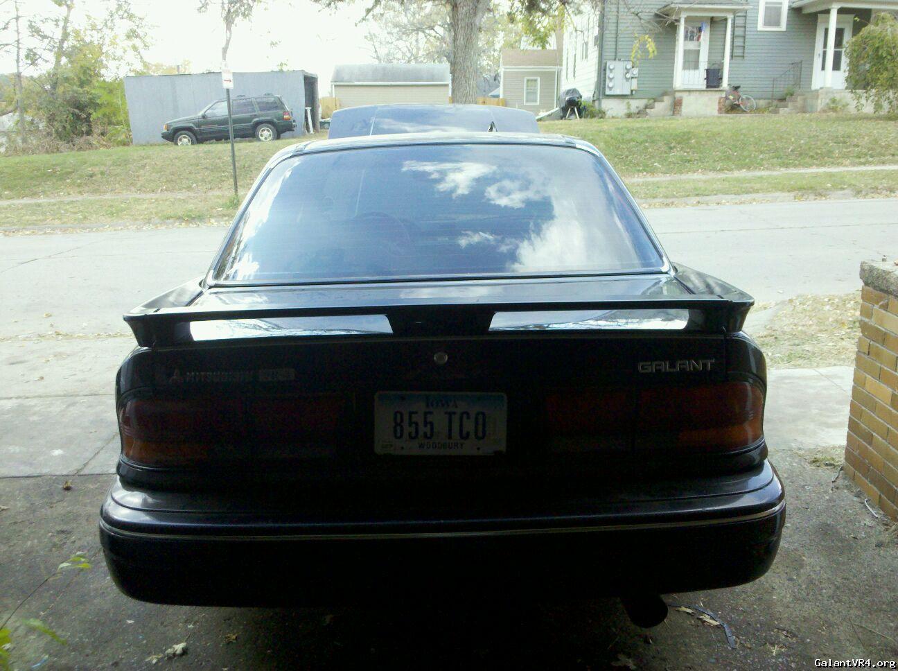

finished installing my AMG wing today..
Diego
Dec 9, 2007
2,132
and it was a PIA!!!! I can't believe how many time I cut my finger on the DS side trying to get the bolt by the 1/4 rear was the biggest PIA.
but it finished i will post pictures in a few minutes...

Dude, you make a post about an AMG wing which is awesome, but then you eclipse it with that Halloween carving. How the hell do you do that, it looks awesome!
Wash the car and post some more pics of the wing outside in better light. You clearly deserve some appreciation after going through hell to fit it and those pics are not doing it justice! I'd appreciate some advice and pointers too as I am going to have to go through this later on at least one car.

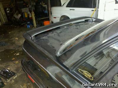

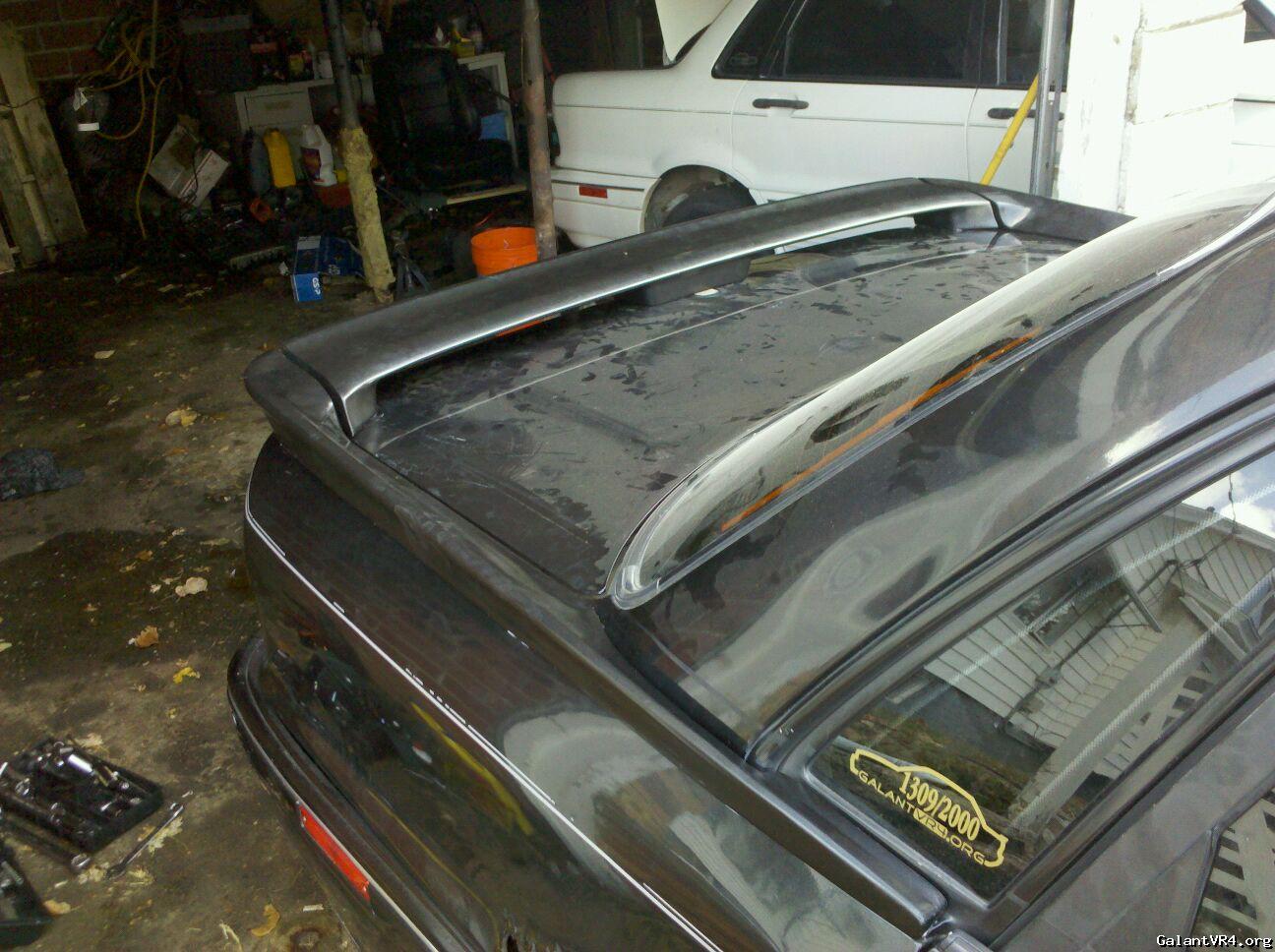

Back of car.

It was fairly easy. We ( me and the awesome neighbor with a 72? AMC Javelin ) taped it off and used a measuring tape ( oh yeah ) traced the outline, measured 2x and drilled once. I need to wash it, take some goo gone to the lid where ther was some residue left from old wing... wash and well I'm going to have to say its SUPER SEXY.

The trunk base and the Passenger side is cake, but with the wiring components on the DS side is a tight fit...
To get the 3rd light to fit you need to file the initial (if you had a wing) brake light hole a smidge to get the connector inside the lid...
