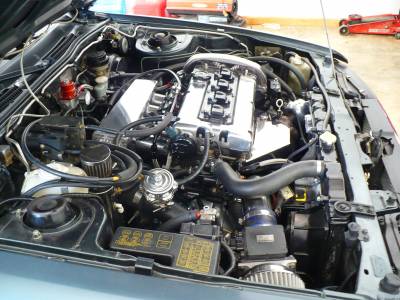

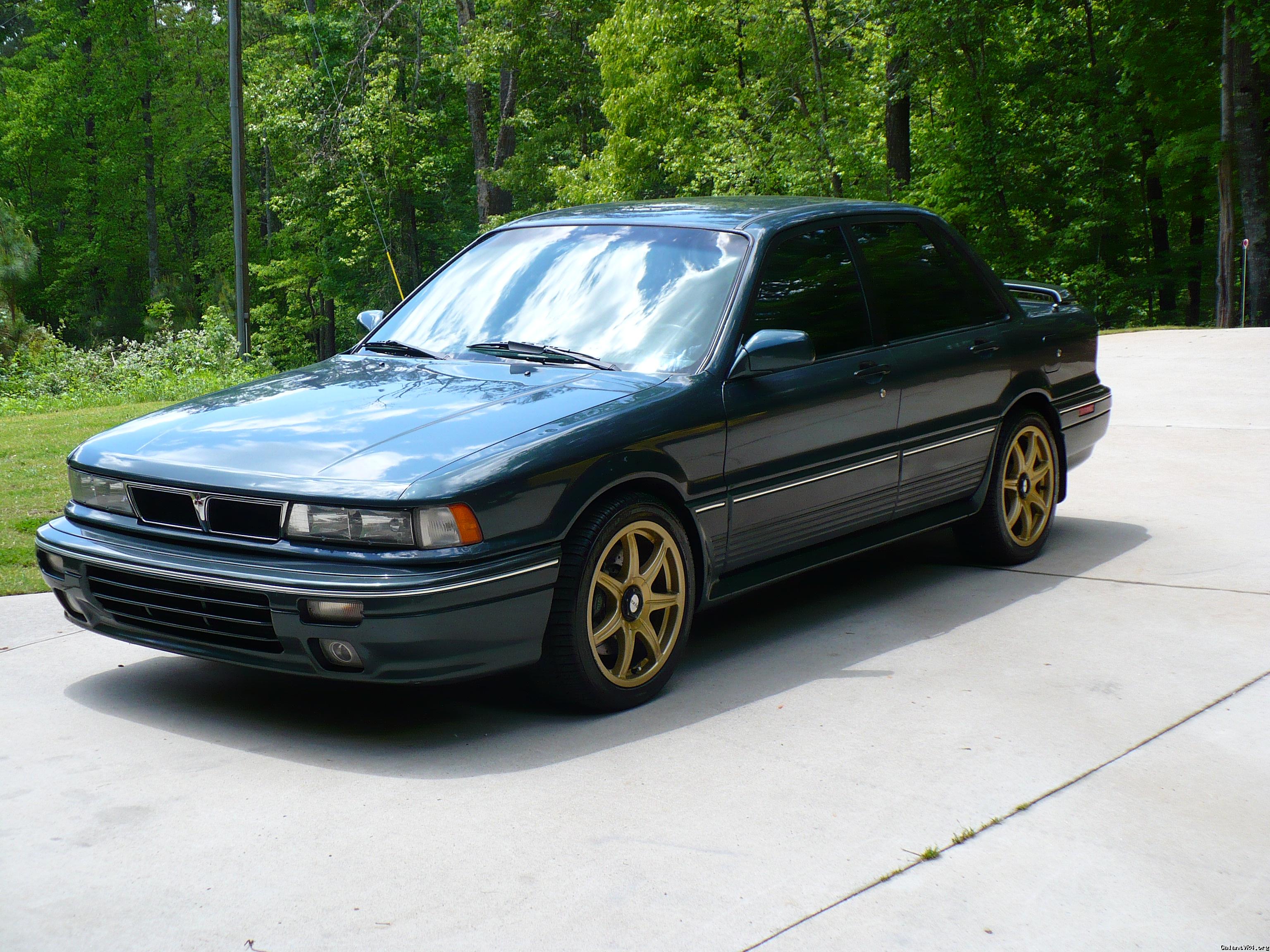

Quoting turbowop:
Like the valve covet and timing cover
The timing cover appears to be a Zacklee Corp. Yes, there are sick. I'm a proud owner of one myself. Worth the $75.

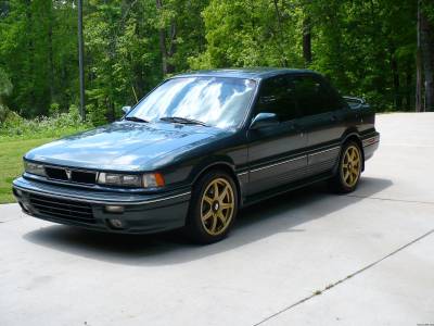

As for the ride, definitely clean, and the polished VC sets off that engine bay. The rims are a little to bright for my taste. But to each there own. Reminds me of sprite.

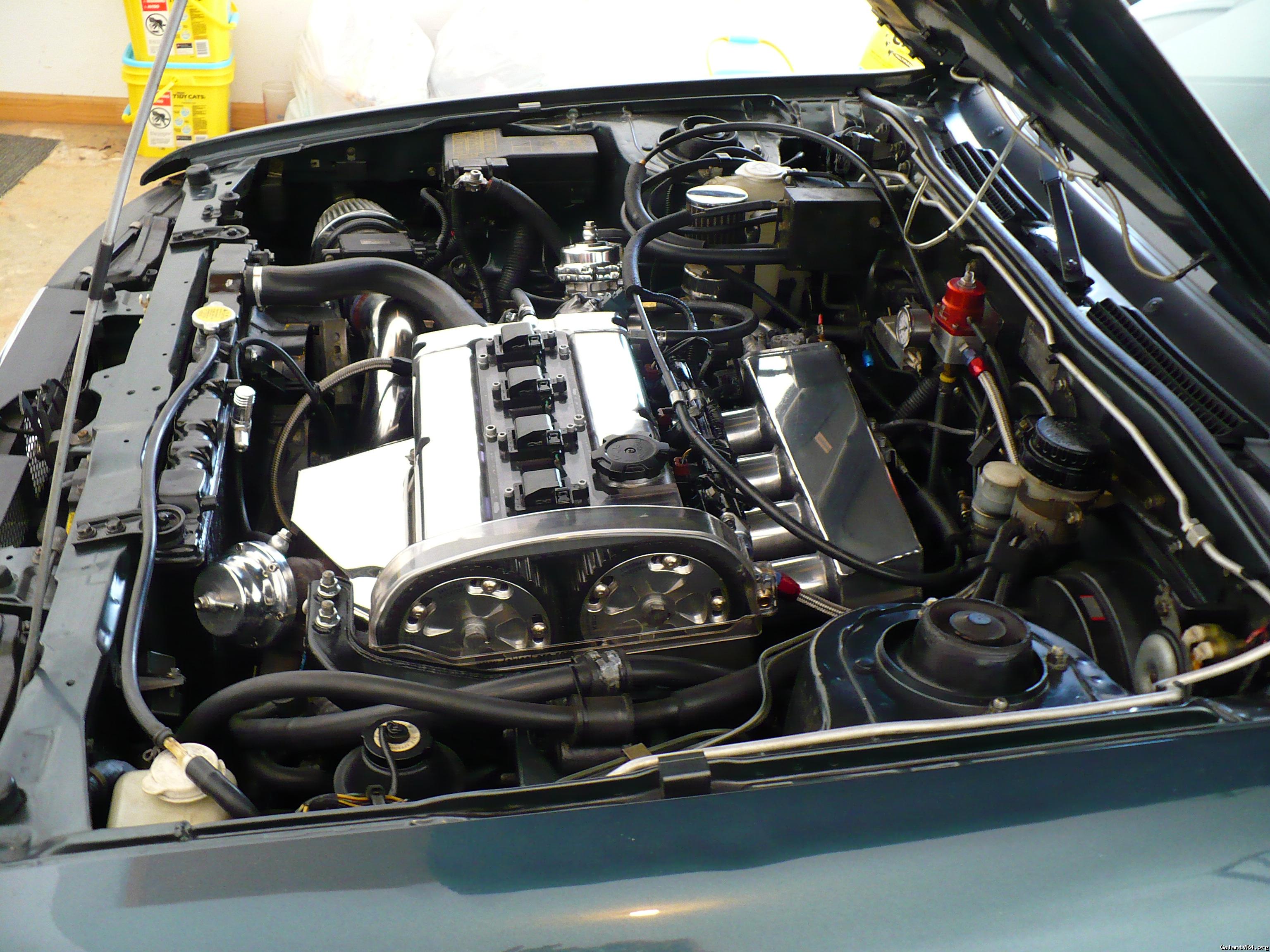

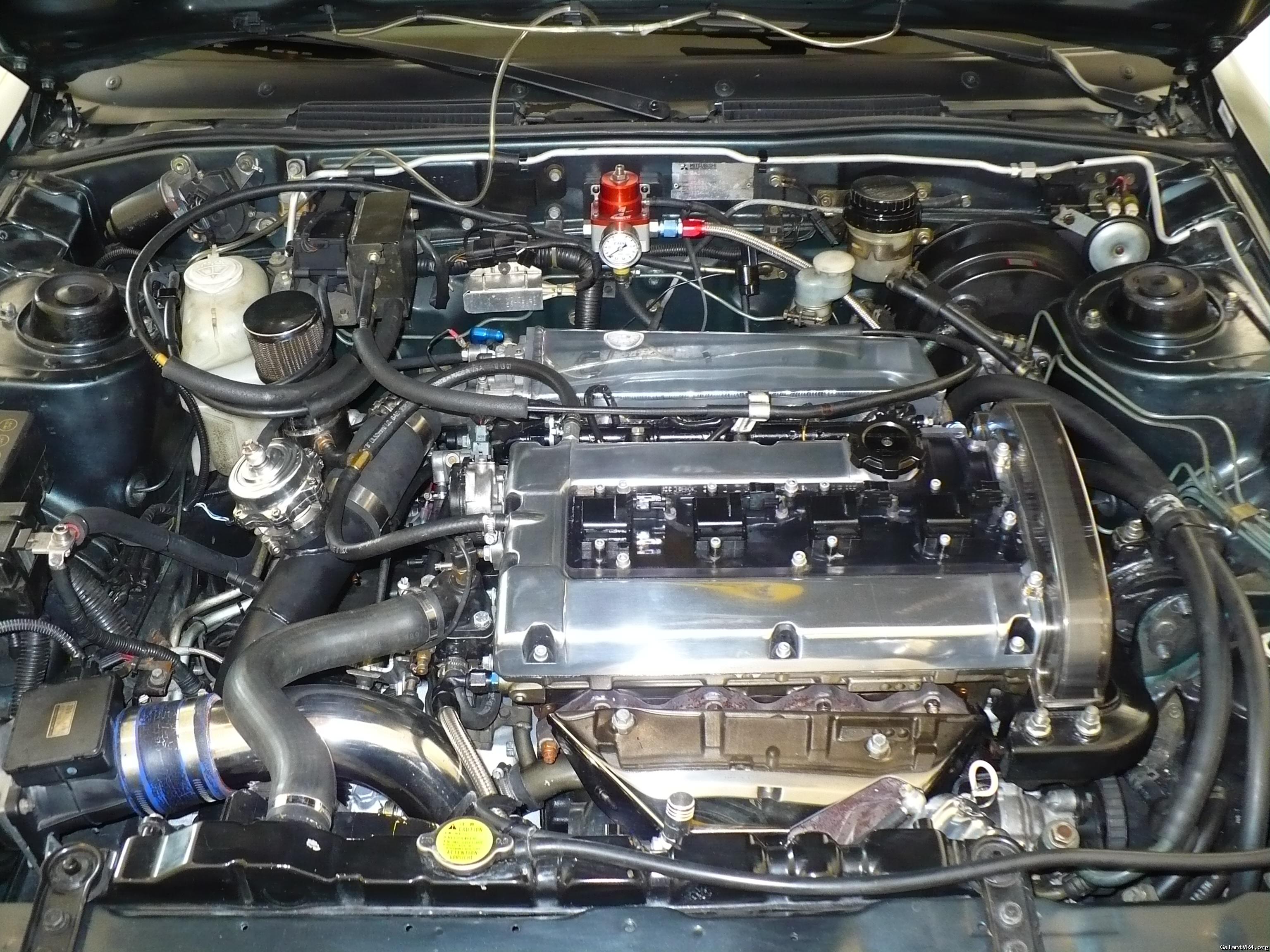

I custom made the COP out out of 1/2 lexan also to match the cover..
Mods:
1G 7 bolt with arp's
Evo8 Pistons and Rods
272 Regrinds, Evo8 springs and ret.
B.R. 20G turbo
Evo8 MAS
Tial Wastegate, Knock off Tial BOV
H&R lowering springs, 17" gold Axis rims
3000GT calipers in front on 12.5" rotors
255 pump, 6an line from pump to rail, Aeromotive FPR, 680 FIC's
Blacked out Powercore FMIC with 2.5" pipes
3" Full exhaust
Evo8 seats front and rear, Evo8 steering wheel
Alumnium Intake
Hafe S.S. Exhaust manifold
DSM link v3
more mods can't think of them all right now.

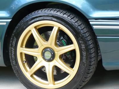

Looks good! Not too far away me too. My only suggestion would be to maybe match the green Mitsu writing on the caliper to belize or white so it doesnt clash.
