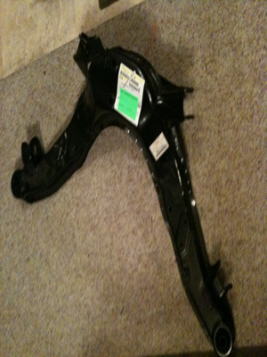

Quoting Romanova:
The last new subframe in the whole country. Thanks JNZ!
Thank you! Sorry about the hold-up on it.
The Mitsubishi delivery guys had us sweating when it disappeared and they said "No, we delivered that...".
Glad it all got worked out since we couldn't even replace it!
