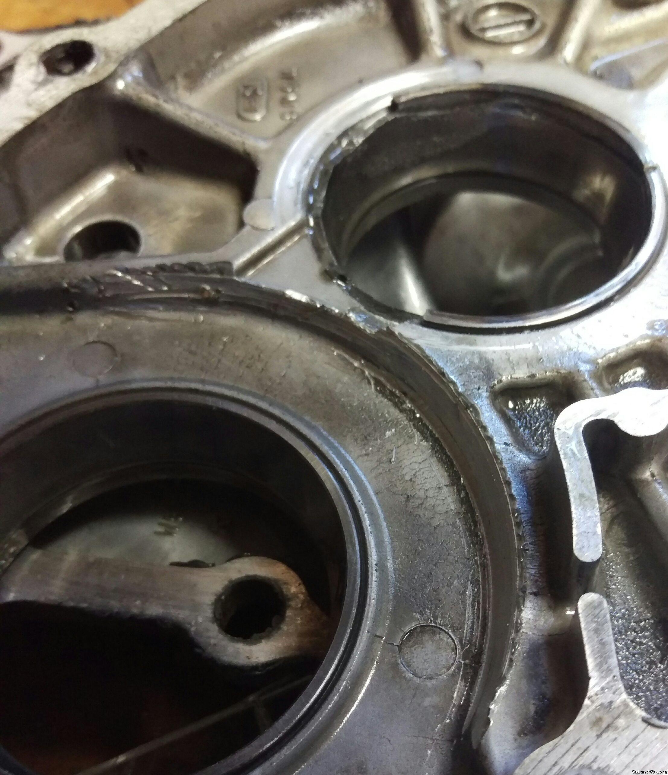

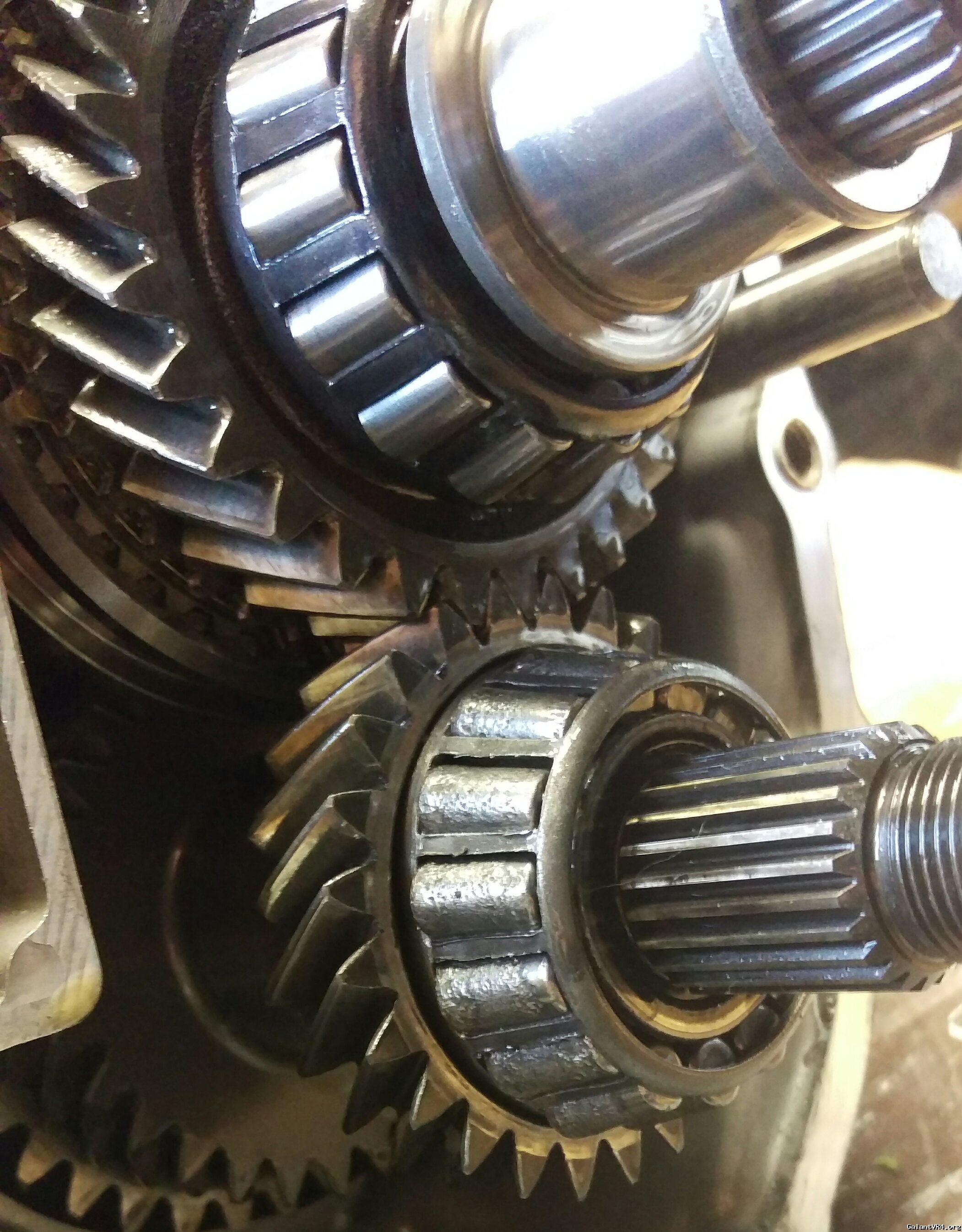

After finals pulling my trans apart I found the source of my drive train noise.
The section of the case is chucked and bearing and race on here are toast.

Definitely check the gear teeth if that bearing is that toast. When the shafts walk like that, they tend to get weird wear marks in them.
