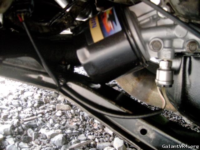

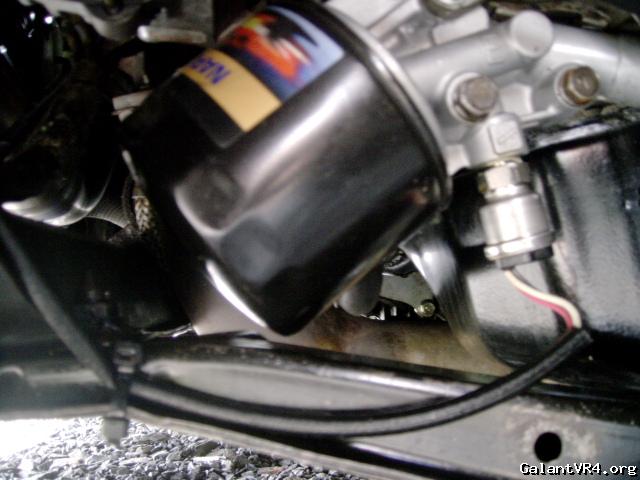

I know alot of people run them and some galant guys are running them as well. I bought one cause i was in a hurry to get my car running again for E-town. I knew it would be tighter in the galant than in 1G's but i didnt know it was gonna be so tight to where i can't get the oil filter off. Luckily i put the oil filter on before i put the housing on but how is everyone else running these? As u can see there is just no room. I don't wanna have to remove a bunch of stuff everytime i wanna change my oil.

Is it contacting due to engine vibration/movement? Stiffer motor mounts might help.
If it's just an issue of removing it, you can unbolt that sub frame brace. I usually do it anyway just to avoid spilling oil all over it.
Hmm yours sure looks tighter than mine.
I can get the filter on and off. (pretty sure I have the same filter)
Will take pics when I get home.

no its not contacting i dont believe when its running, its just that i dont wanna have to remove the subframe piece everytime i change my oil cause that will eventually strip those holes out taking it on and off that many times. Im just gonna have to switch to a different housing or relocate it.

Why? Go buy an OEM 3000GT VR-4 filter. If it is good enough to filter a 3.0L Twin Turbo engine, it should be able to filter the oil for our cars.
GVR4ZUM
Jul 8, 2002
1,455
SoCal, USA
Chris, just jack up the engine a bit, just make sure you put a block of wood or cloth so you don't dent the oil pan.

yeah i neve really thought about that. Ill have to try jacking the engine up and see if that gives me enough room to pull it off.
