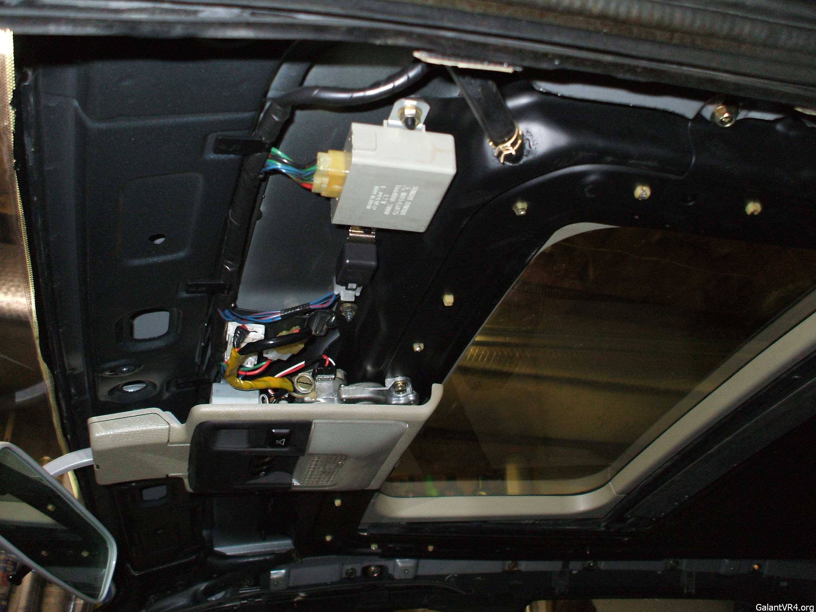

Removed the headliner today. Sorry it took so long but the tranny/clutch was the priority.
Carried over to him and put in the truck so he can take them tommorrow.
I removed the switches, visors, handholds and anything else with a screw driver first.
Then the side pieces on top and then the rear seals and then the A pillars. Becare and take your time they all come right off. Slide the liner down forward and its out throught the back doors.

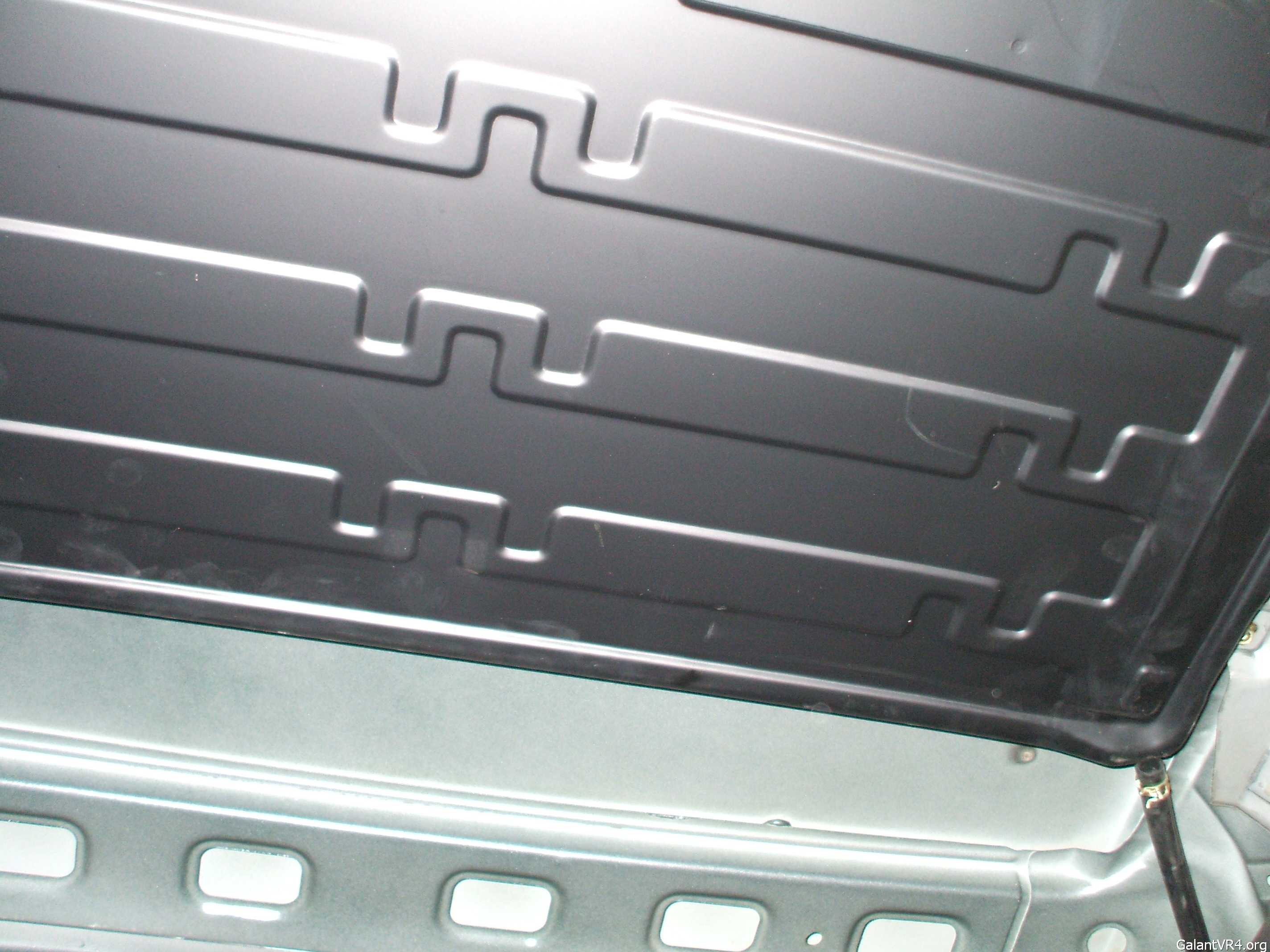

As for the sunroof damn its heavy. Had to remove the side supports 4 or 5 6 mm bolts each times 4 then the wires to the motors/relay etc, 4 drain tubes then finally was able to remove it. You'll need a friend to help. It has 4 nuts in front and one on each side. Remove the front ones first then as some one help remove the sides and lower. Now the fun part the cloth covered tray has to come out. I removed the rear most screws and clips and pulled it apart as I slid it out.
He said the ring around the sunroof hole could be dipped in die or replace with a black material I'll see it tomorrow.

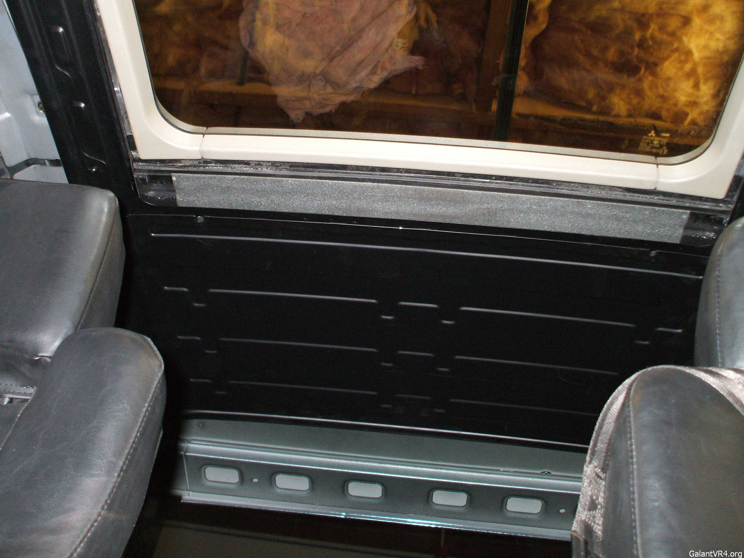

Here's what it looks like without it.

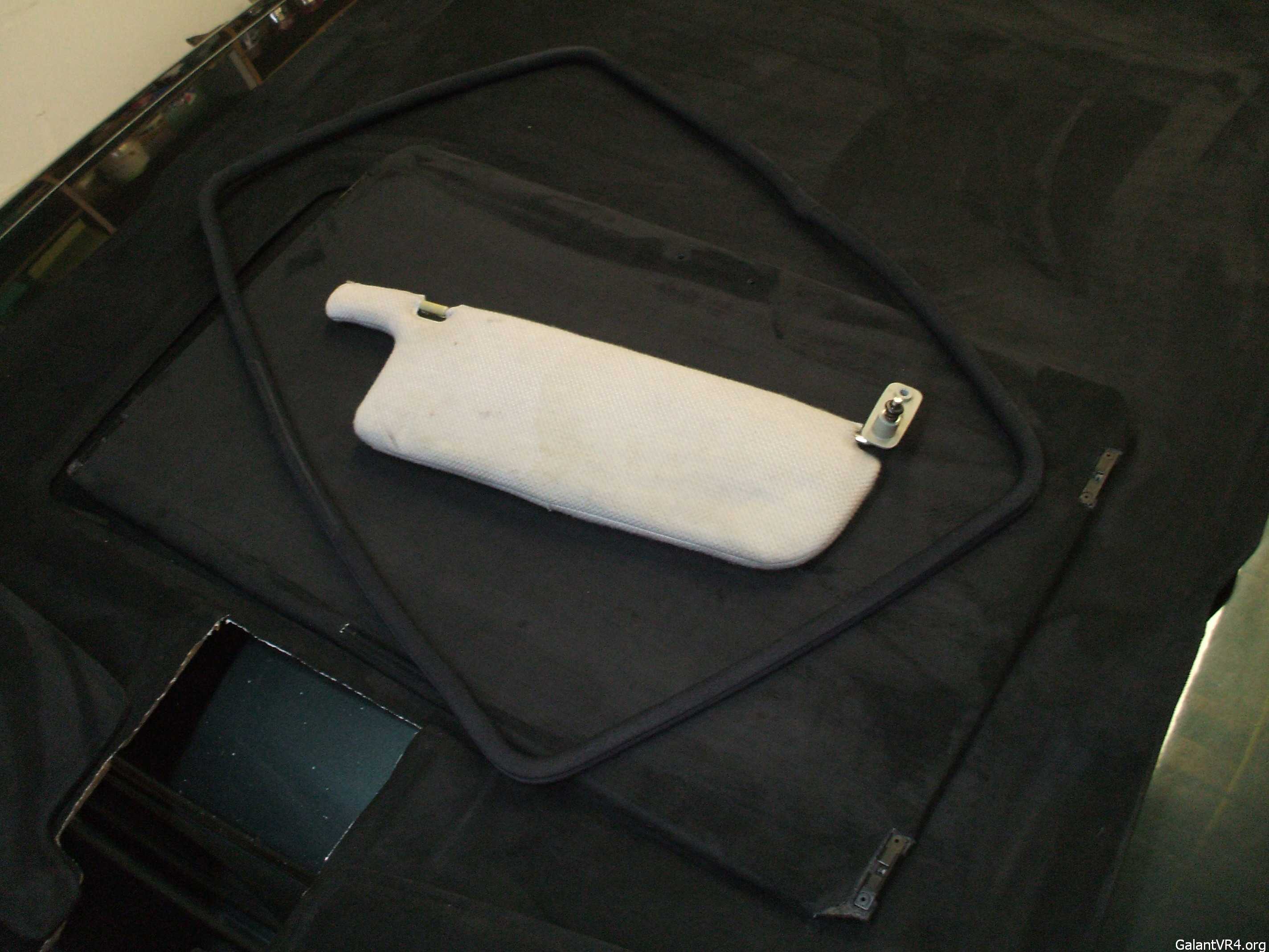

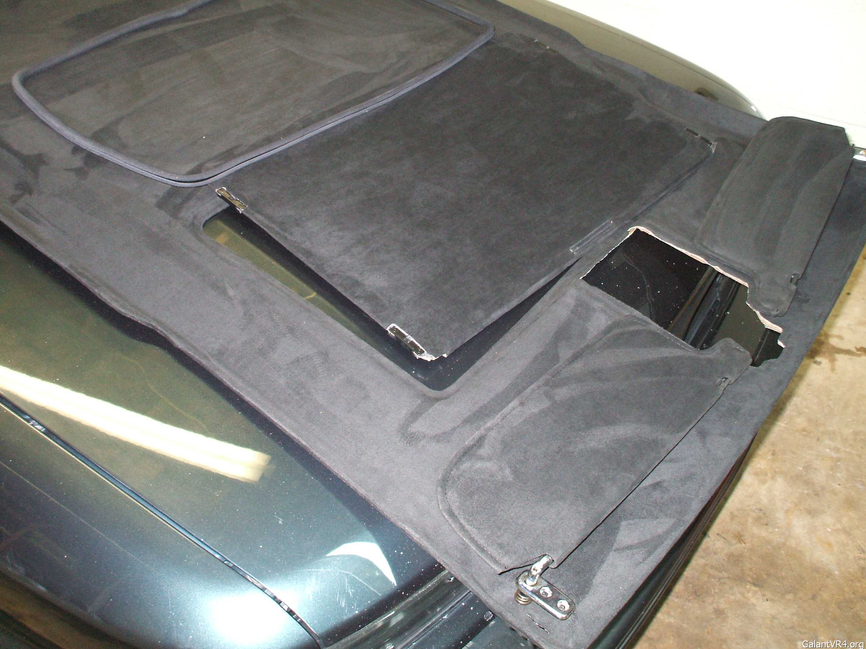

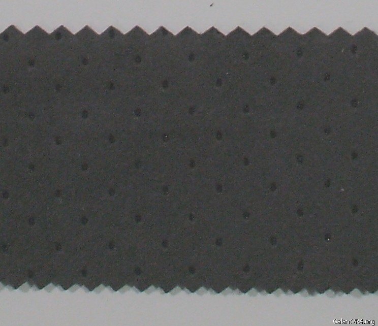

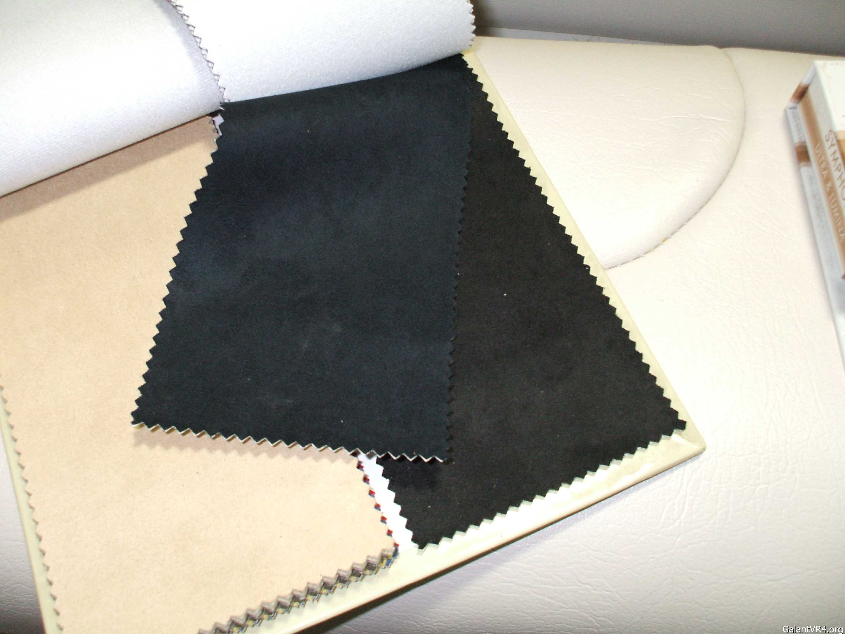

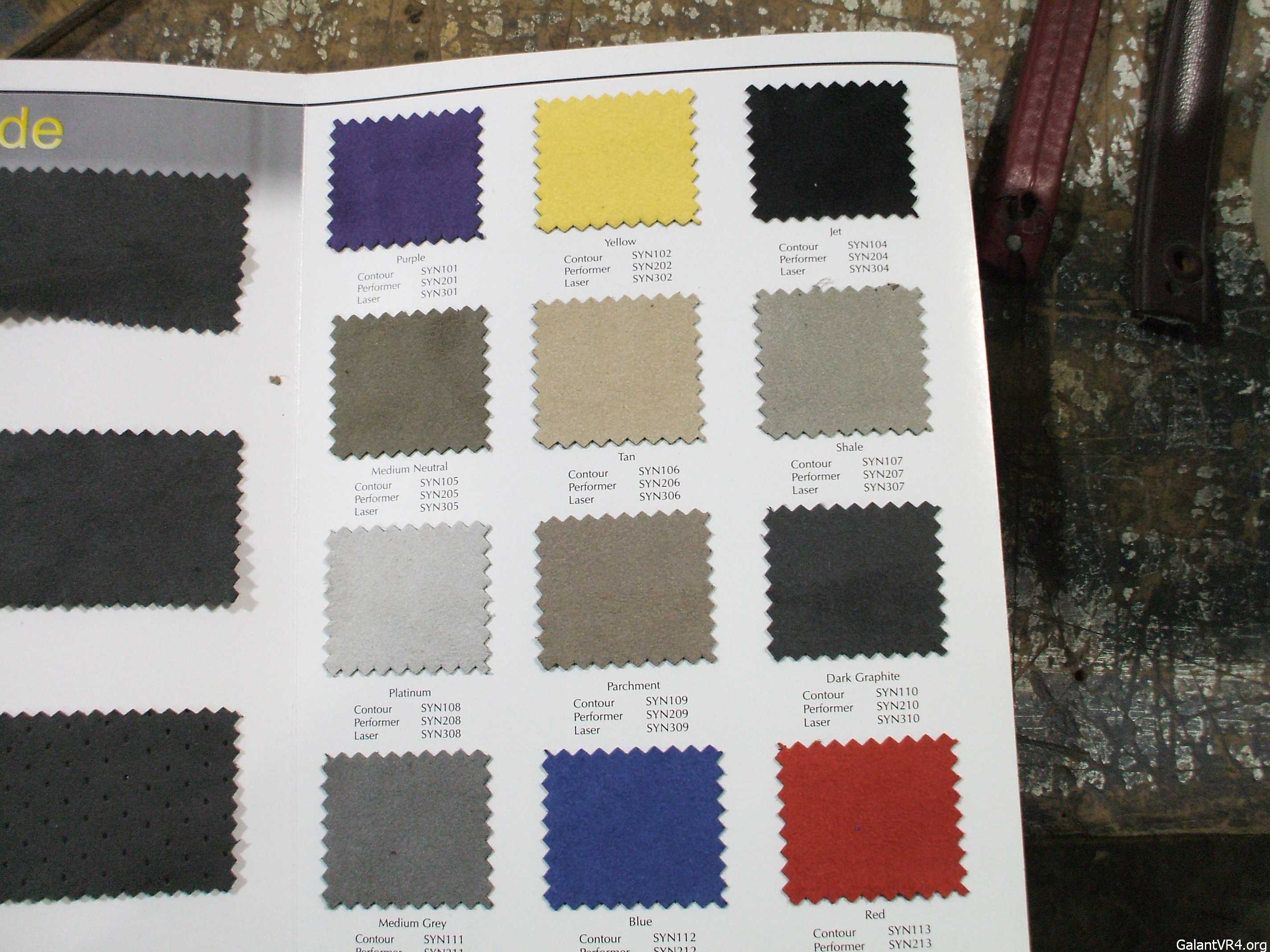

These are some pictures of the materials
The last one shows a black and then an onxy which I picked for mine the black looks like a dark blue like the die that comes off a sparco wheel...(paul has heard my rant)
The other flip open books shows different colors and also types. There is an un-backed , backed and also a laser cut perferated which would be sweet for the sunroof slider but I'm probably just going with the standard stuff.
He said he buys it by the yard and it would be cheaper on everyone if he could buy a roll. Also the other color that looked good is the graphite grey that are the three large pieces on the flip open book. Unless you want pimp purple or rally red.

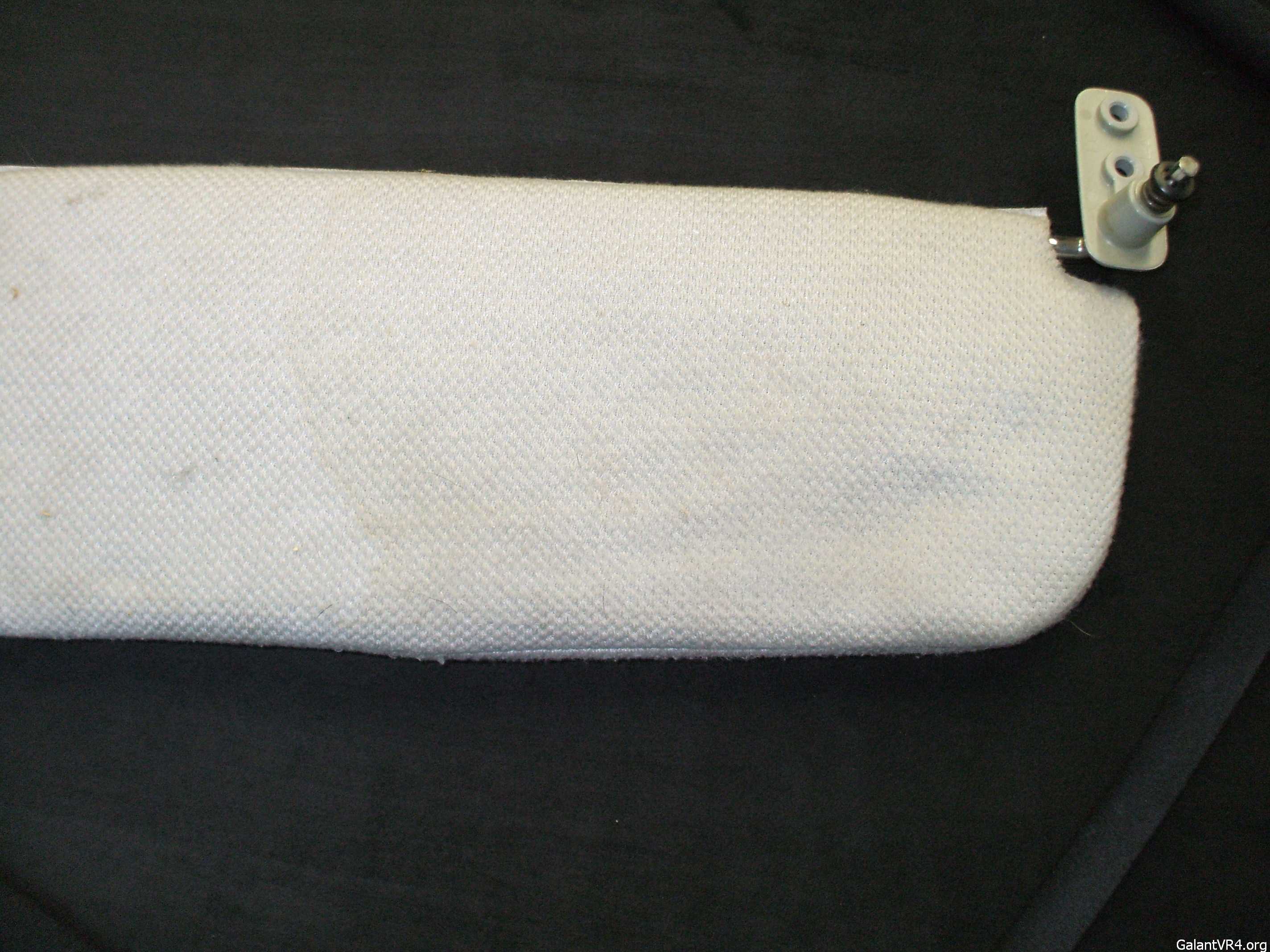

Anyway he was sewing up a visor for an 02 Vette that the guy had installed a garage opener into, looked really clean but was being a pain to do since the size was so thick. He hadn't called on prices for my material yet. Not sure when he'll have it done but want be long now. Its amazing how dirty it was when its flipped over so sunlight can hit it.
Picture enjoy the camera is a 6.3 meg so yo can right clip save as and enlarge to see.
I'll keep you guys informed when its done I'll post pictures of it installed. Curtis

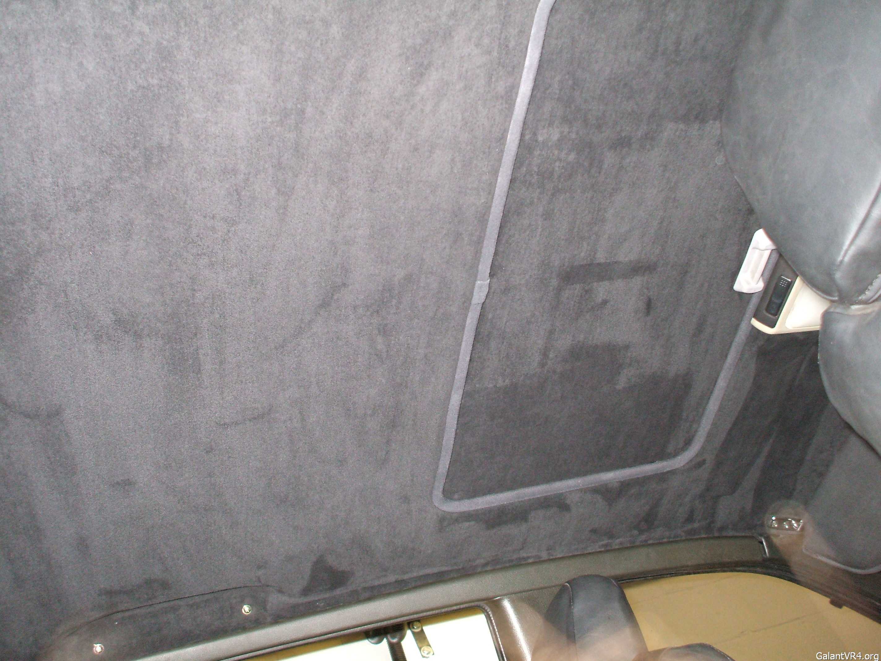

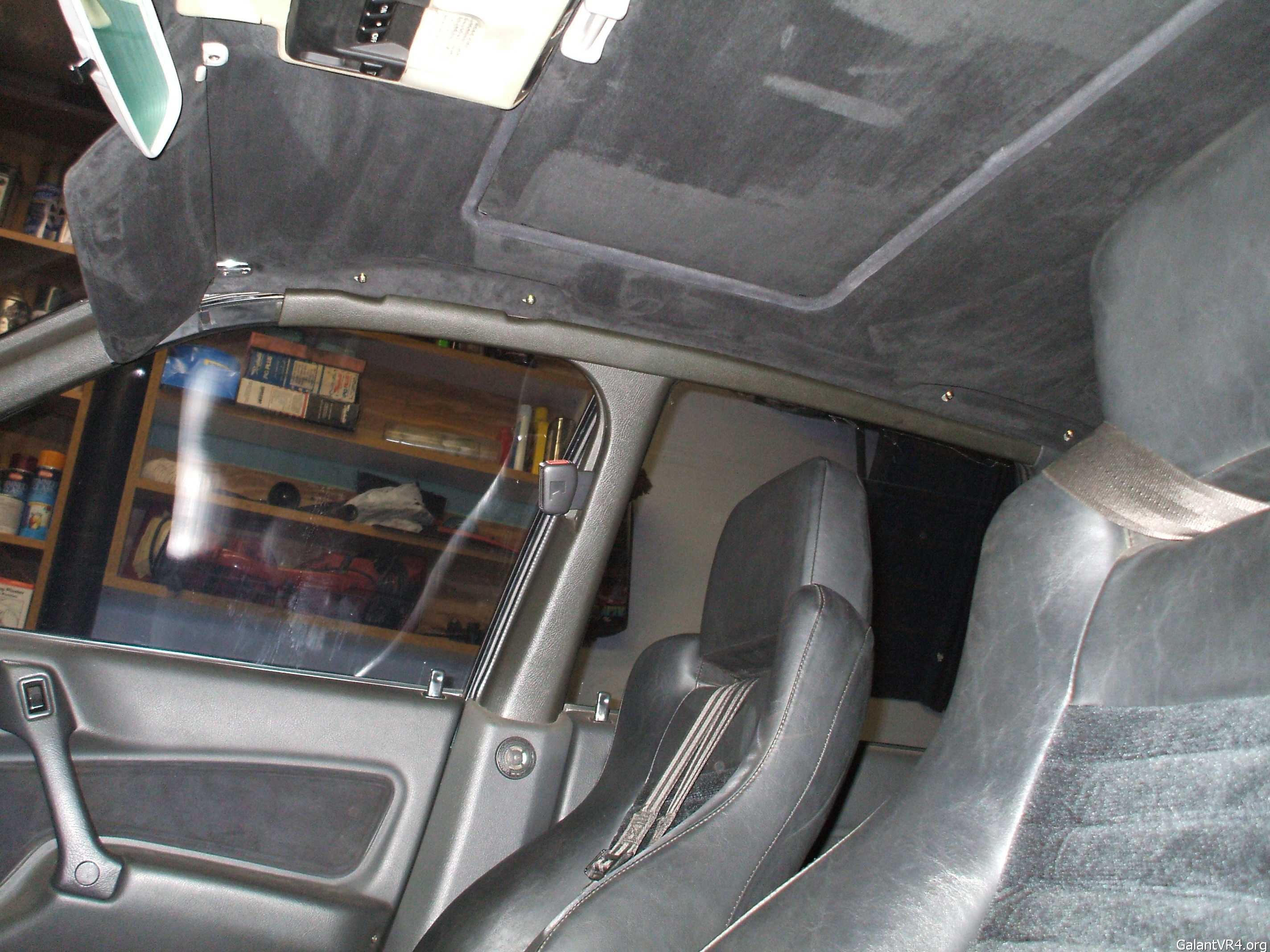

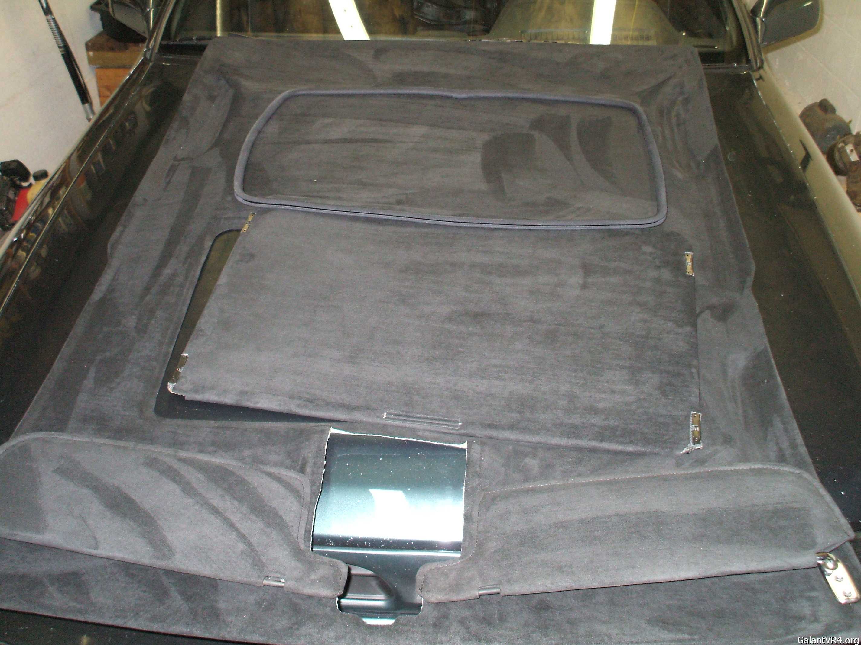

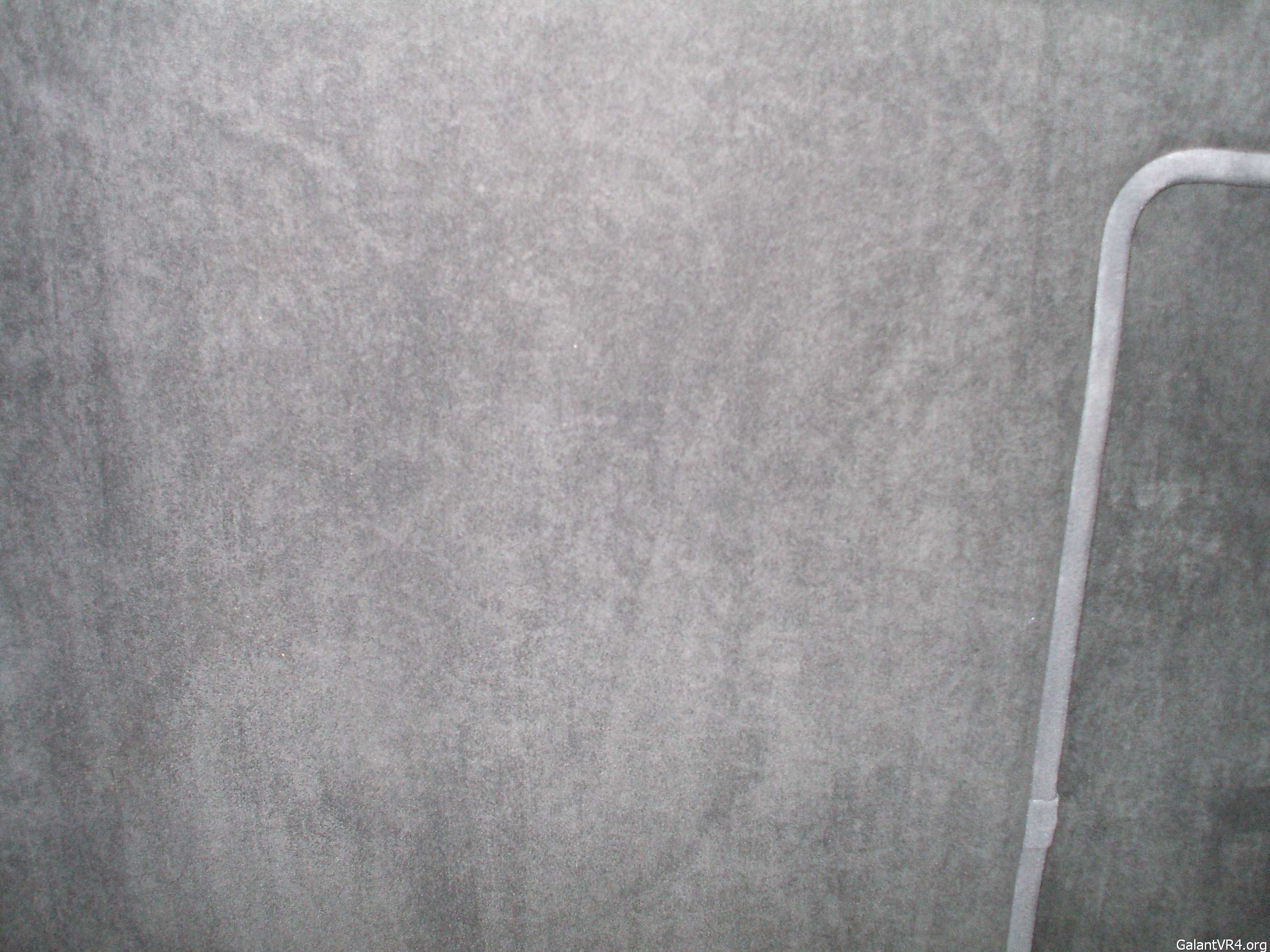

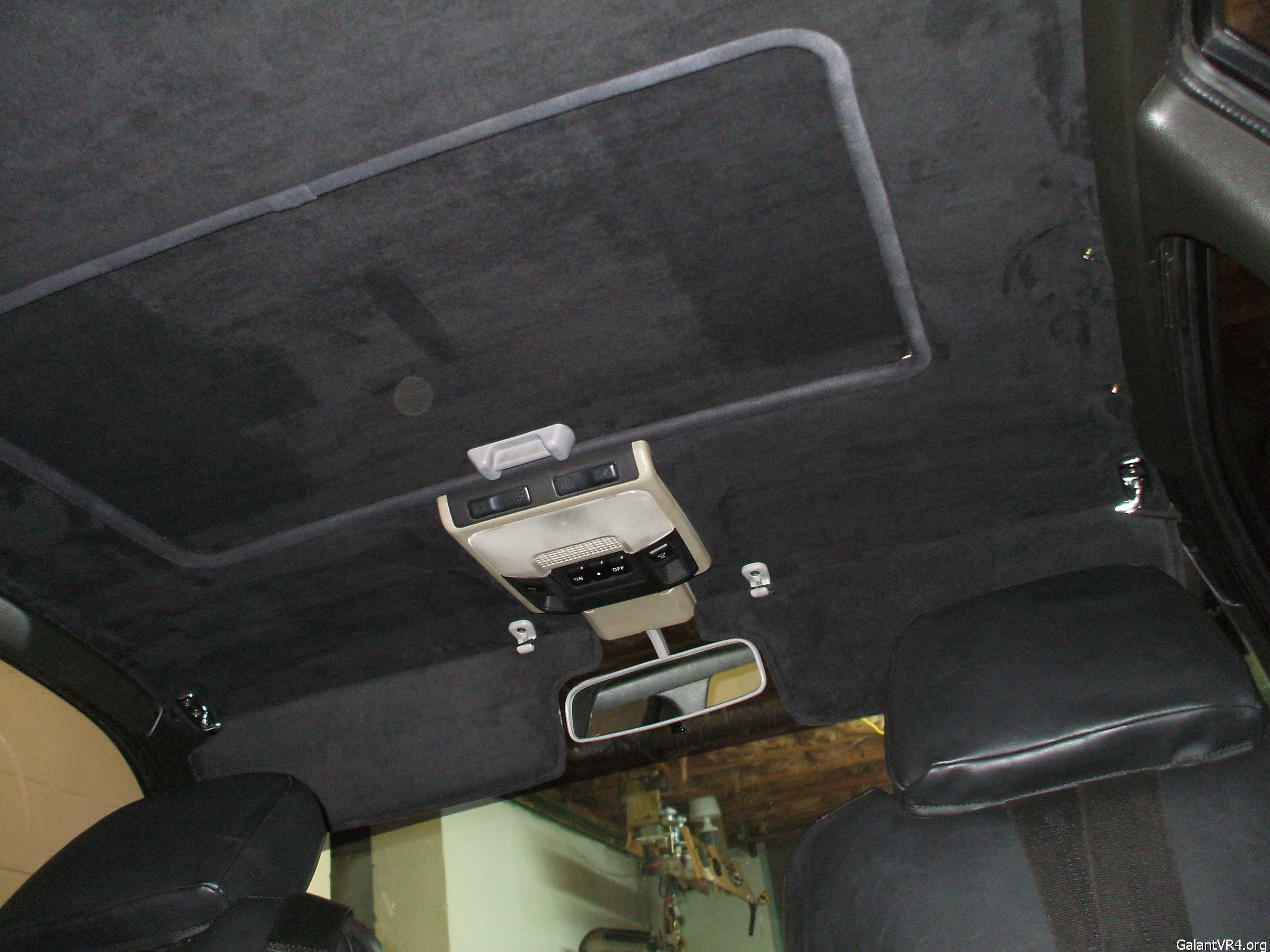

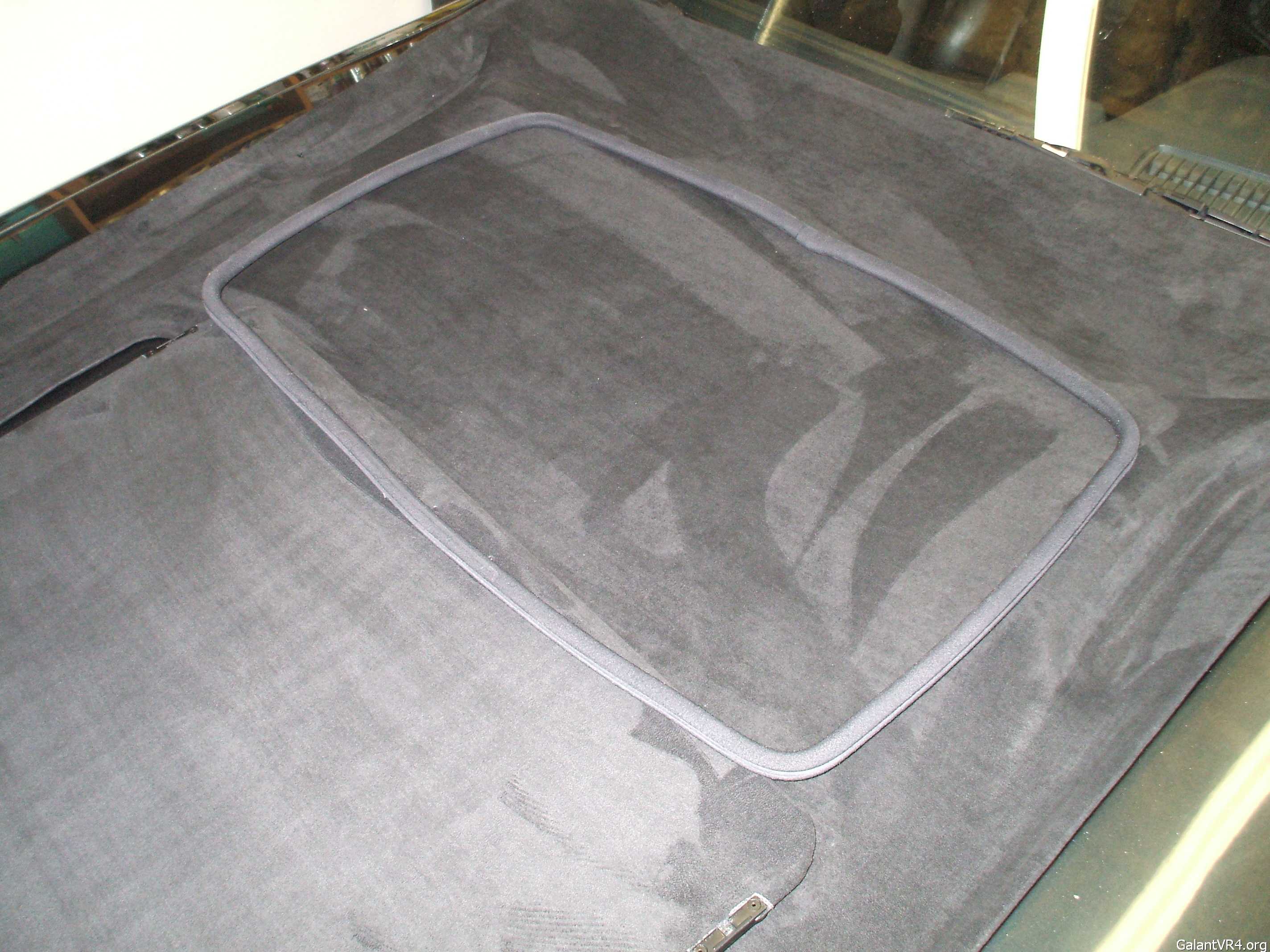

He had them done last Friday so it didn't take long. But since I was gone he ran them by this evening. I'll probably get them installed tonight and post pictures and prices later tonight or on Friday. This stuff turned out way better than I thought it would.
Moderators please sticky this for me.
May 4, 2003
11,892

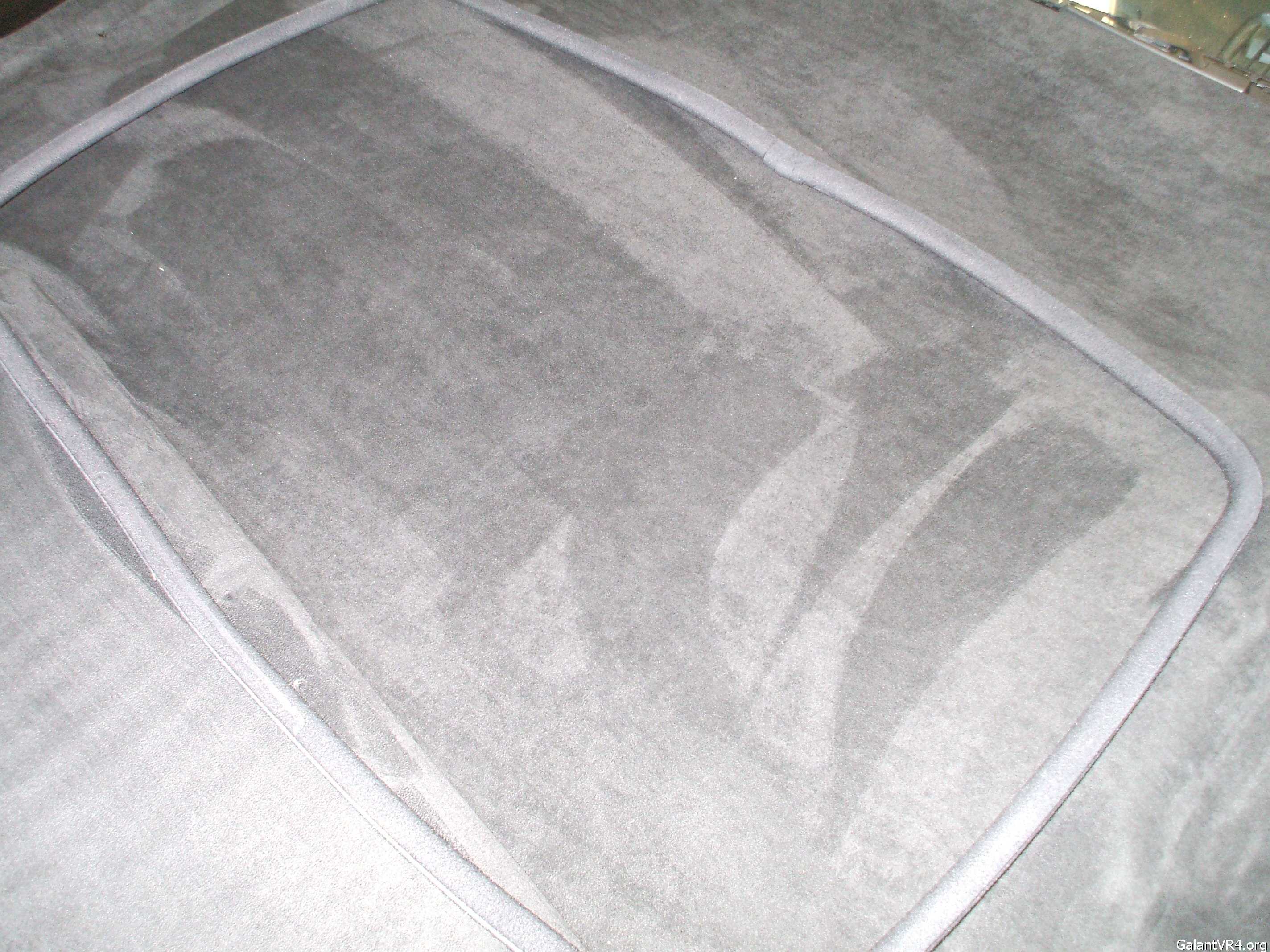

Clarksville TN
I couldn't wait until the weekend. /ubbthreads/images/graemlins/devil.gif
I'm not going to use the the hand holds so I'll find some covers for the screws or something to fill the holes with and I'm going to paint the light sunroof switch assembly, sunroof board slider and the visor clips.
The third picture down really shows the color, the flash keeps washing out and turns it a grey color, This stuff looks just like suede in the doors.
Also for all you guys that don't have a sunroof......I HATE YOU. Those are no fun pulling out or putting in also they weigh to much.
Before anyone says anything yes I broke the a pillar on the pass side. I was going to use one of Pauls but its for a non power belt car.
Enjoy
