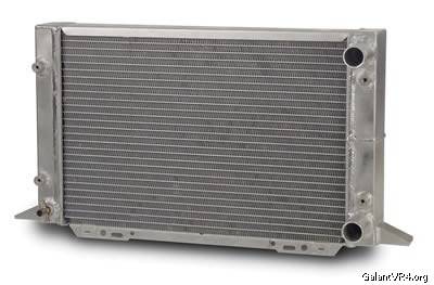

anyone use the AFCO Scirocco Style radiator in their Galant? im in the market for a new Radiator and i wanted some opinions if anyone has used one and how it works.

Here is the AFCO Radiator i purchased through Summit Racing last night, i purchased this one cause it didnt have the radiator cap on the DS like all the other ones did.
Good choice, I think that one was 60-80 dollars more then mine. That lip on the bottom will sit nicely up against the cross member.

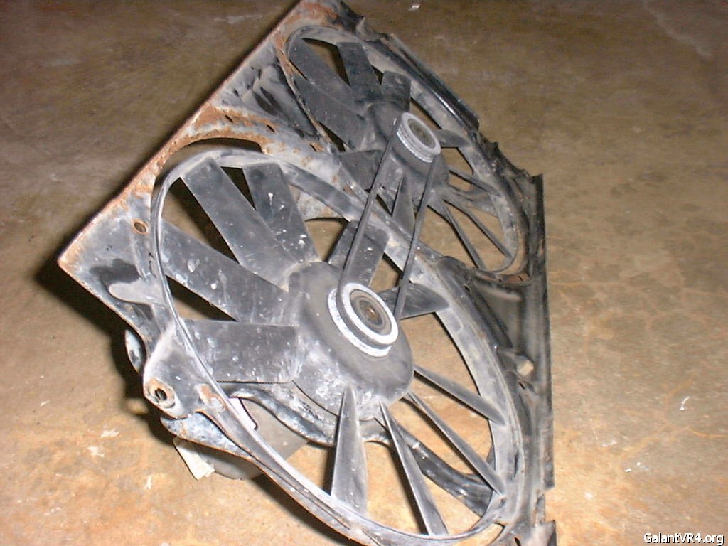

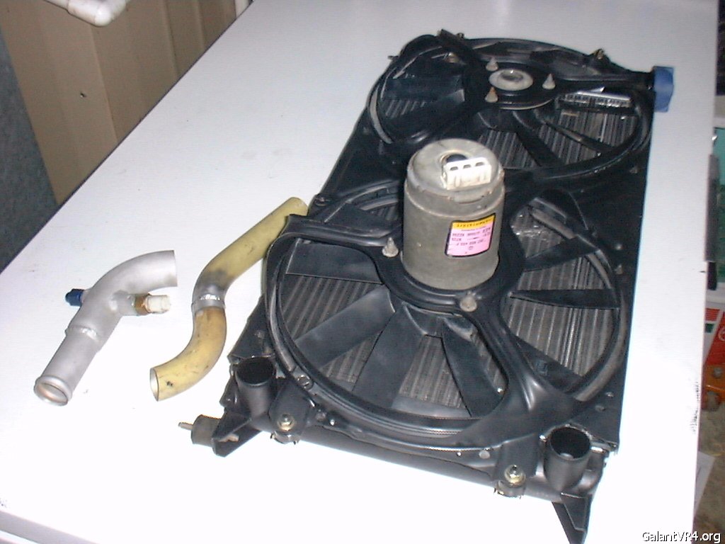

Any here's the fan I'm using. You can get a fal set-up that is a direct bolt on or grab up a Passat or Audi dual set-up like this. Belt driven. Only problem is the motor is large...I've been told the corrado motor is thinner and runs the same rpm and pulls the same amps but haven't found one yet. I used nissan taillight install goo strip around the edges to seal it up and trimmed to fit and the cadmium plates end brackets are from a rabbit fan. Had to stay brand specific. /ubbthreads/images/graemlins/grin.gif
To mount it on the bottom I used rubber isolator vibration mounts from a 87-93 mustang 5.0 airbox and fab up brackets for the two top corners using chassis welded in nuts that we're already there. the drivers side is on top of the core support and the passenger side uses a nut that is under the core support and beside the light.
The pipes are the upper and lower radiator hoses. Tig welded aluminum the bottom one uses the factory thermo switch .
