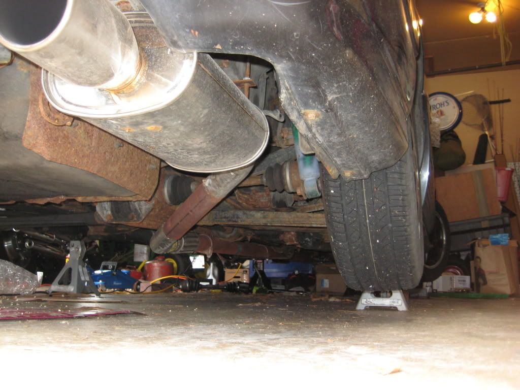

I tried to do mine as absolute budget as possible.
I did the whole thing with:
-Turbo flange from RRE
-90* bend for the DP (which I kind of cocked in the flange..complete pita to make it work right)
-10 foot stick of aluminized straight
-Ebay flex section
-2 45*s to get around the pumpkin.
-Cheap OBX muffler
I think I had it done in the 175-200 dollar range.
Dont mind the WI rust, and the gobs of weld...Thats a different story.

^ Thats an interesting spot for the flex section. How is your weld at the turbo flange holding up?

My whole exhaust didnt quite fit like I wanted, and that seemed to be the best place for a little wiggle to make the rest work..As you can see, its a little bent there.
The weld is fine, but its only got 300 miles on it.
And those welds are the love child of a REALLY crappy surging, and studdering welder, and a guy who had been out of the game for a few years.
