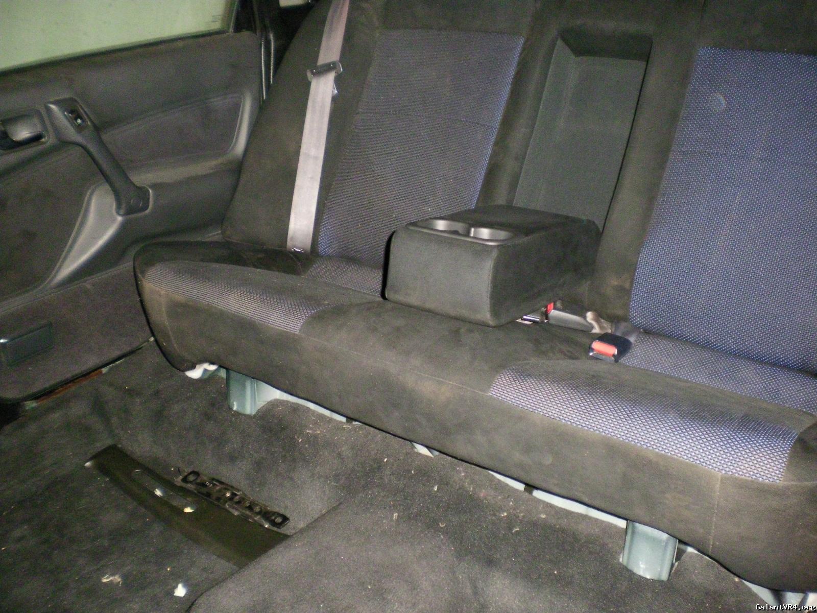

On mine
Havent been fastened yet, I just put them in loosely to see.

The lower right corner of that photo is what i'm talking about. This seems to confirm my suspicion that the seats do not cover all the way out to the carpet, and leave sheetmetal exposed.

What you normally do there is you cut some of the foam out of the seat so it will cover it.
on that pic I havent installed the lower seat porperly, I just layed it there for the picture.

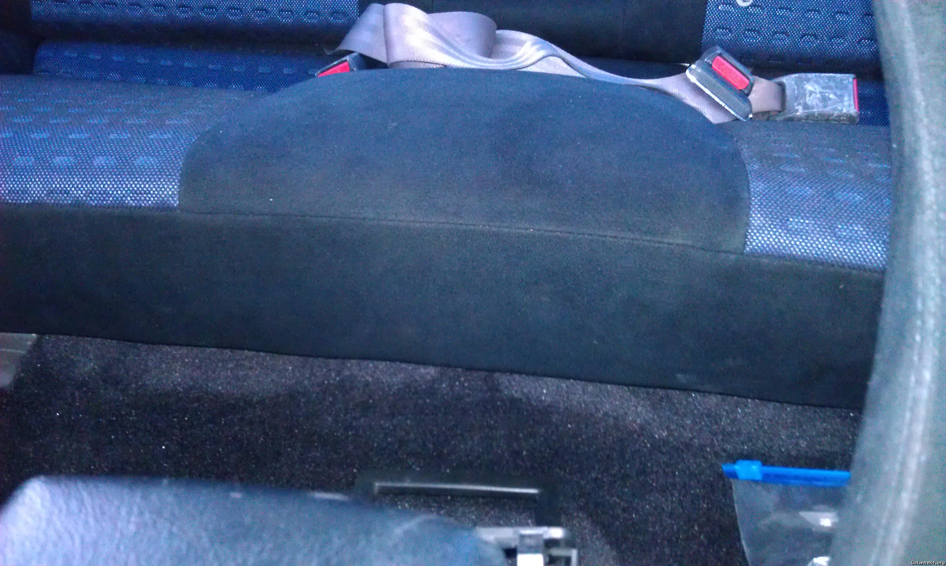

I just did the rear seats. I cut out the three mounts on the hump and its sits a lot lower just from doing that.

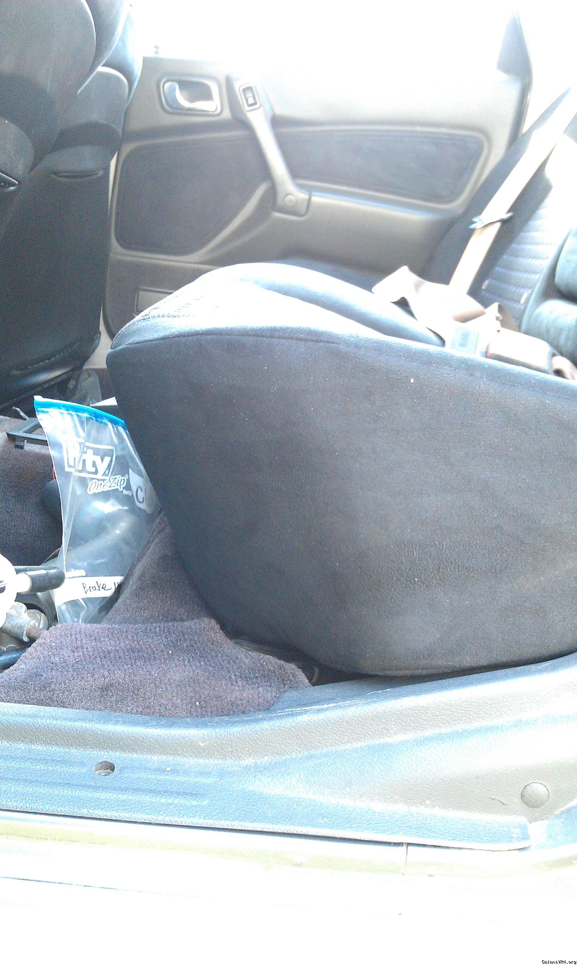

I just read stealthtt24's how to on the rears. I didn't weld anything. I didn't cut the foam under the seat either. For my car that would've put the bottom seat too far forward. I also took Broxma's advice and drilled a hole in the hump on each side and put a bolt and nut through it and made a stud like that. So a bolt with two washers and one nut to attach my "stud" to the hump, then another nut and washer to bolt to the seat.

did mine the way you did Marin and mine looks awesome just like your does. It shows the plastics a little more on the sides then stock does, but looks amazing reguardless

Cheaper, faster, easier for me to do it my way. At least for me. Took about 1 hour to complete. And I must say that the evo cushion is softer/more comfortable than the stock bottom. /ubbthreads/images/graemlins/dunno.gif
