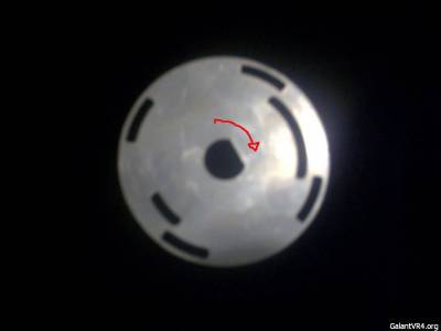

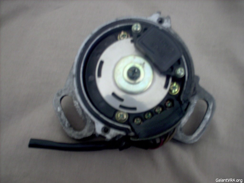

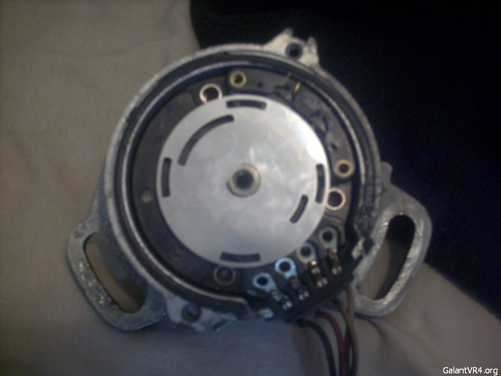

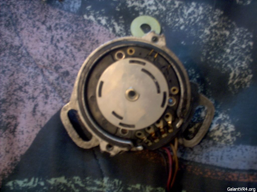

well i have been checking in on this thread for quite a while and so i thought i would just crack open on of my spare 90 style CAS's that i cant even give away.
here it is with the cap off
here it ise at TDC

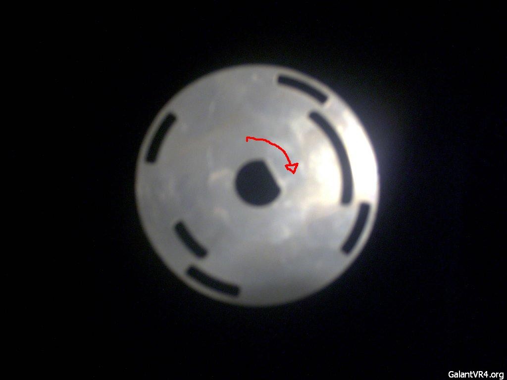

here it is clocked for the evo cam 90' off
if you get some one to machine you one of these (cough curtis cough)
with the this hole rotated like so 90' then that might work, or even just cutting the remainder of the circle in the center, rotating it 90' and tightening that might work also.
just food for thought
