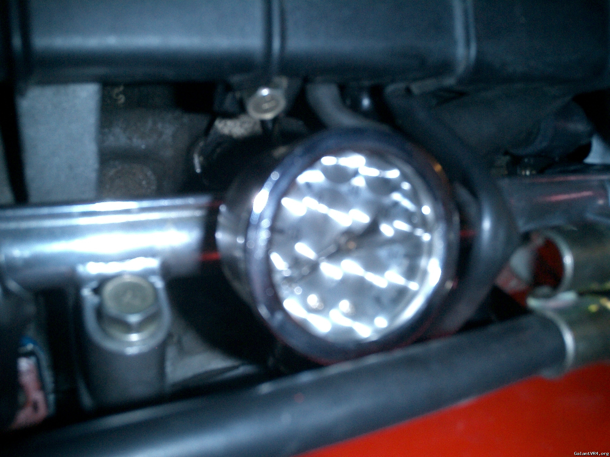

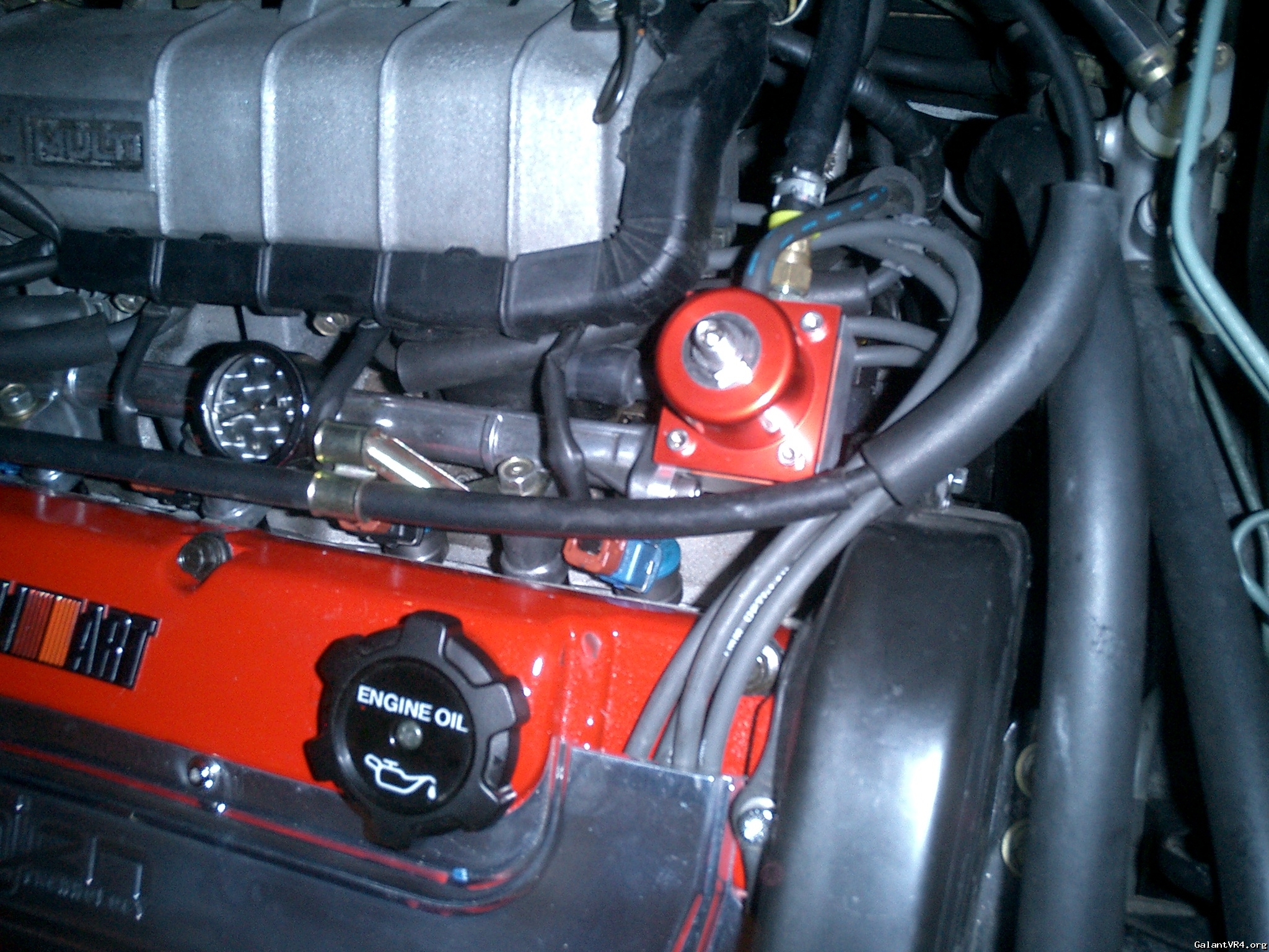

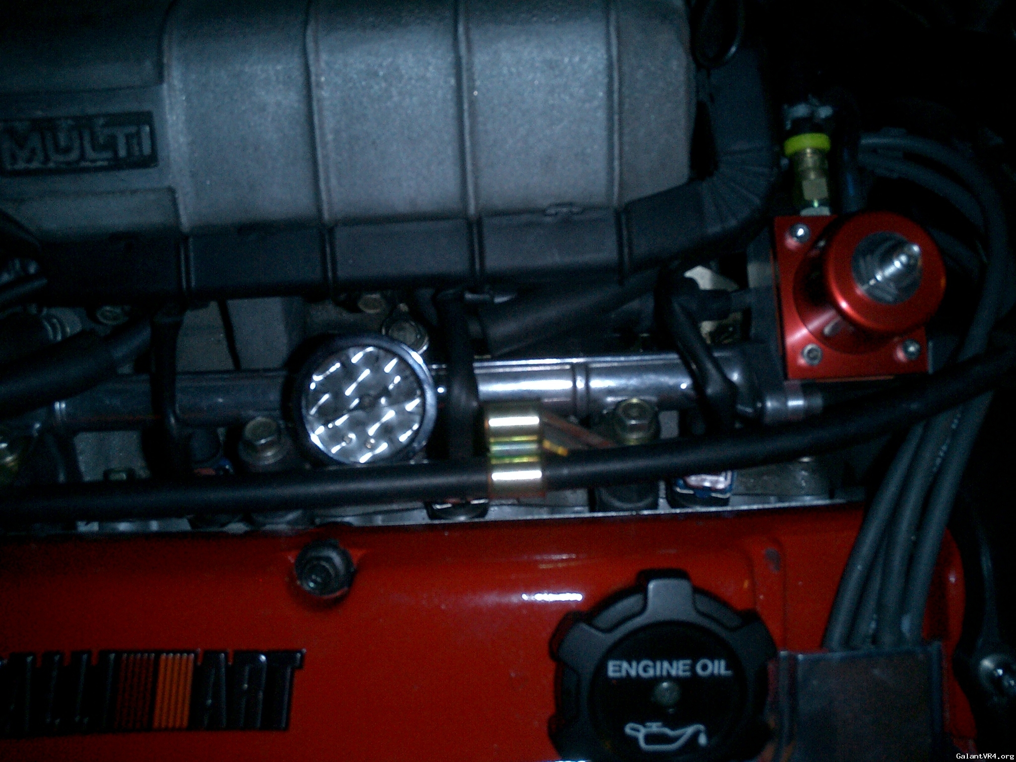

no need to change rail ,you can polish the stock one ,I even tapped mine for a fuel pressure guage.The 1g/vr4 is the best rail
save your money for something that needs upgrading

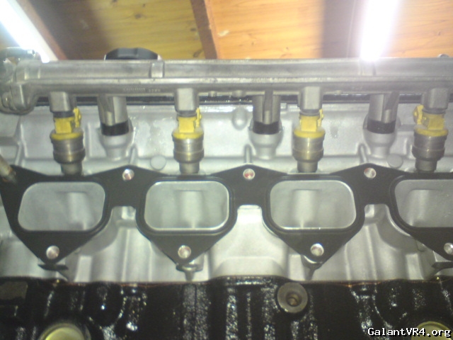

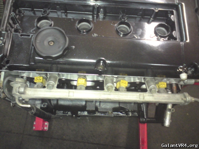

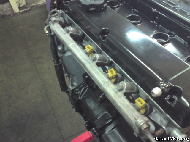

The injector spacings (along the rail) should be similar.
If you align it so the 2 bolts that fix it to the manifold/head you'd only have to worry about the fuel line fitting and the FPR fitting being the correct diameter. And if the diameter of the rail is the same at each end, and both fittings are the same dia as the rail....
That being said, the VR4 fittings have a smaller dia to the Evo 1-3 fittings and most likely the Evo 4+ fittings too. Can't see why the Evo 4 fuel rail, lines and fittings wouldn't be too far off from fitting, just have to put the fuel feed and fuel pressure reg on opposite ends from the factory evo 4.
Bimmubishi
Jul 15, 2003
5,704
Boston, Massachusetts
Evo 4-8 manifolds have two mounting bosses for the rail to the intake manifold. Galant and Evo 1-3 have three.
The Evo 1-3 is a confirmed fit on the Galant head. I had that last year.
4-9 is a no go without mods at least. (or if the outer two holes are in alignment and you skip the middle mounting hole.)
