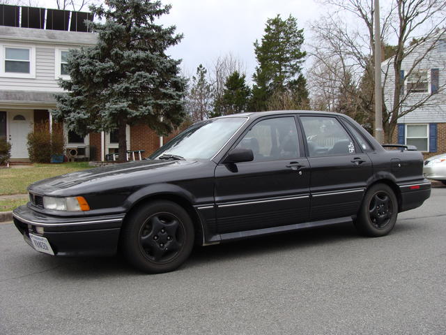

I use the ASD springs on my Evo8 struts in the front only. Since the stock Evo springs in the back were already stiffer than the front and sit pretty low I left them alone. I can grab a pic later if you want to see what the ride height looks like with this configuration.

Yeah, would be nice to see that height and how the rake is on different setups.
Just took this pic. Car is filthy due to snow from last week but you get the idea. I wouldn't want the back any lower than the stock Evo8 springs already make it.
