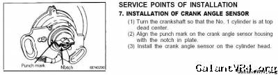

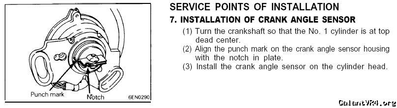

Injectors might be gummed up, inhibiting movement. You could put a few drops of injector cleaner in them, then with alligator clips/lines connect the injector to 12v via a pushbutton switch. Tap it repeatedly and hopefully it will begin to move again. But depending how long they have been sitting, they may need to soak overnight before the gunk is loosened enough for them to move again. Anyway, here is your CAS alignment info.
