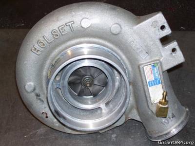

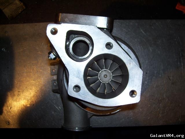

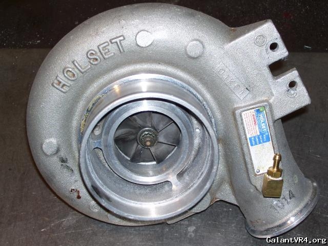

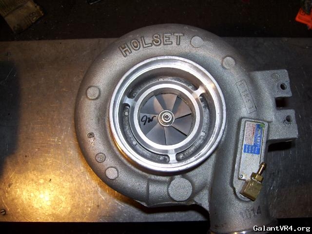

well i think im going to bite the bullet on this one. Got it fairly cheap. the holset hx35 can do 60lb/min of air, has been proven to spool to 20 psi at 3500ish!
here are some pics. I have to swap the turbine housing to a BEP mistu housing though in order to fit our stock intake mani.
If im not mistaken this particular hx35 variant flows nearly the same as an FP red!
Have to clean her up i know /ubbthreads/images/graemlins/laugh.gif

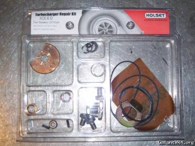

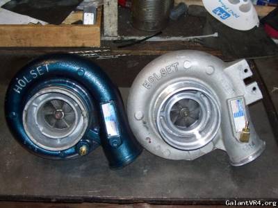

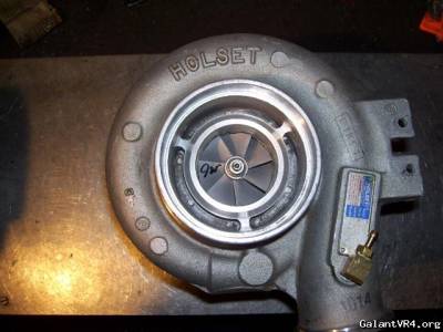

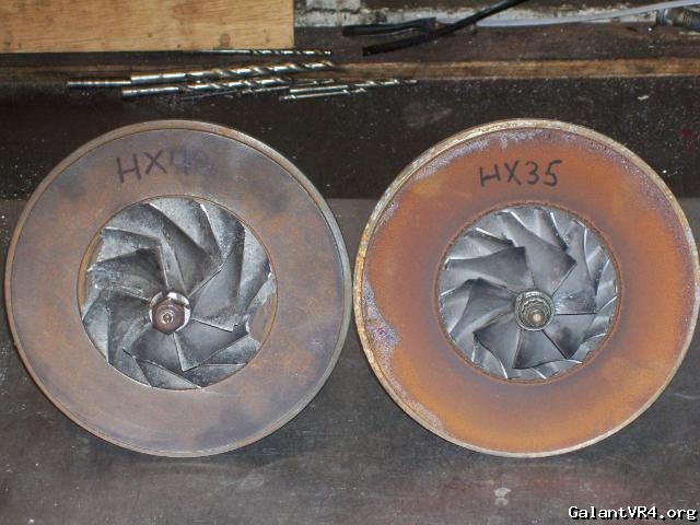

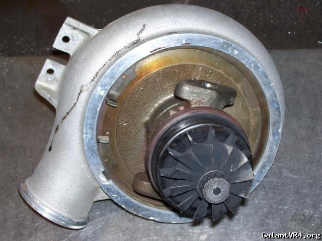

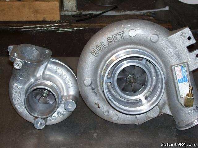

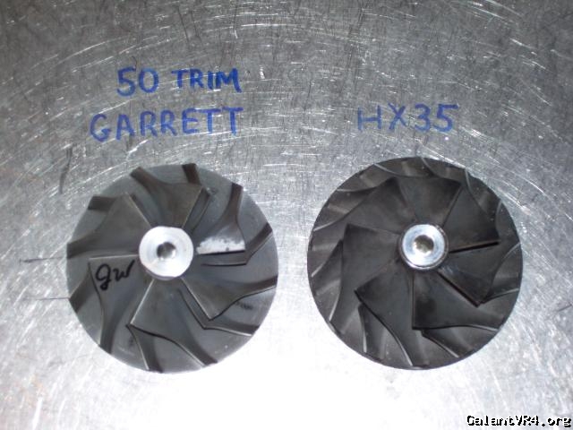

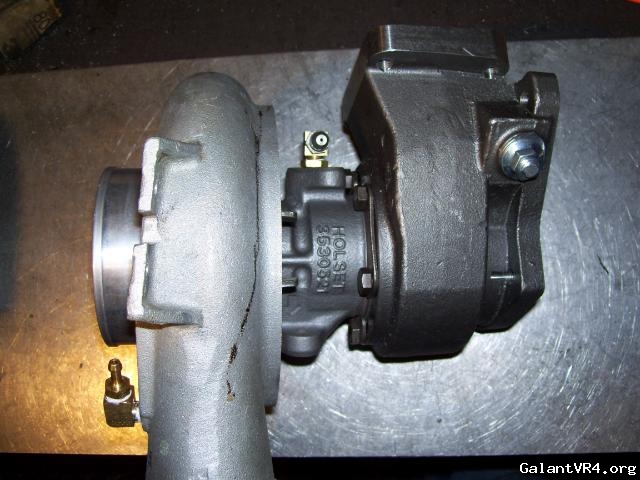

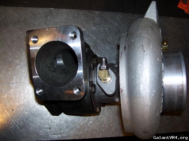

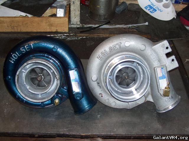

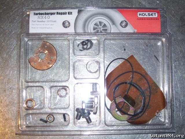

Update. Sent my hx35 to a recommended turbo rebuilder at the tuners. He's a stand up guy and very nice to talk to. His name is Justin. Here are some pics of the rebuild:
Cleaned up compressor housing:
Next to a small 16g:
Next to a holset hx40 (blue on the left)
compressor covers removed:
Hx35 compressor wheel compared to a garret 50 trim compressor
Original Holset rebuild kit:
With the brand new Bullseye Power DSM Bolt on turbine housing:
Pictures c/o Justin.
