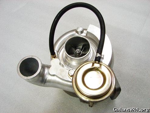

does anyone have any experience with ebay turbo's? saw this tdo6 turbo. Supposedly its made by a company called GODSPEED. dont know their rep or the quality of their turbo's but it's damn cheap for a TDO6 20G!
I have read in DSM forum that around 8 of 10 (somewhere close to that) turbo ebay buyers (especially EVO III 16g's) are happy with their purchase. Has its durability and have been running them for thousands of miles with no shaft play at all.

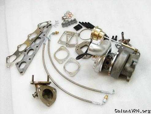

their main concern though were the install kits. they were all wrong.
I on the other hand would not need any install kits, i just need the turbo. so i emailed the vendor asking about warranties and rebuild services options just in case it breaks. still waiting for their replies.

Read the DSM forum closer and check the dates Chris, the very first knock off were listed as "GT" models. These had a decent rep and were of better quality.
The latest run of copies are horrendous, I would put the failure rate at 80% or greater. These are sold for as little as $150 bucks including gaskets and bolts.
Just friendly advice, YOU WILL GET WHAT YOU PAY FOR! So many folks are posting on these cheap models and hoping someone will say how great they are while 100 others warn against.

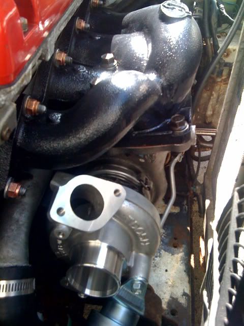

screw the ebay junk.. if you decide make sure you block the water passages off. This is my first 4g63 and everyone told me the evo3 on the street is unbeatable. You can get a new MHI evo3 for like 550-600.. then spend the rest on some other supporting mods.
MHI turbo's ftw.
no problem.. 22psi sounds like a good number to run. Also... my evo3 has not even been ported yet so there is even more room for improvment. My buddy has the 'newer' ebay evo3 on his 2g gsx auto.. and its crap... laggy and just doesnt wana run right. My moto... do it right the first time so you can have more time to play and less downtime /ubbthreads/images/graemlins/wink.gif good luck and let us know how your build goes. I'll have plently of videos when she is runing to show ya how fun a real evo3 is to drive on the streets.

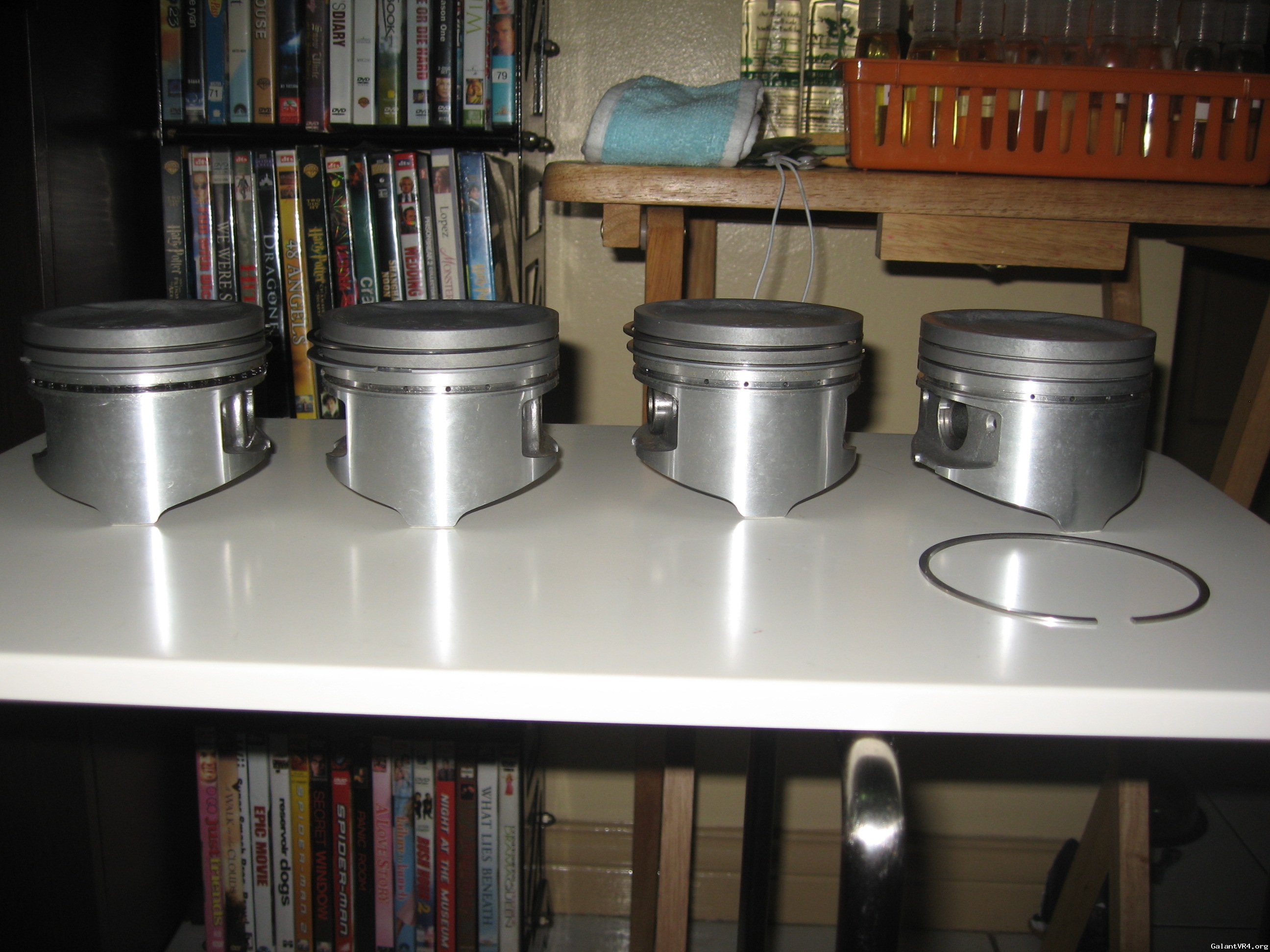

update: my pistons have arrived /ubbthreads/images/graemlins/smile.gif thanks myles!!!!
(it's a brand new NPR 2g piston)
