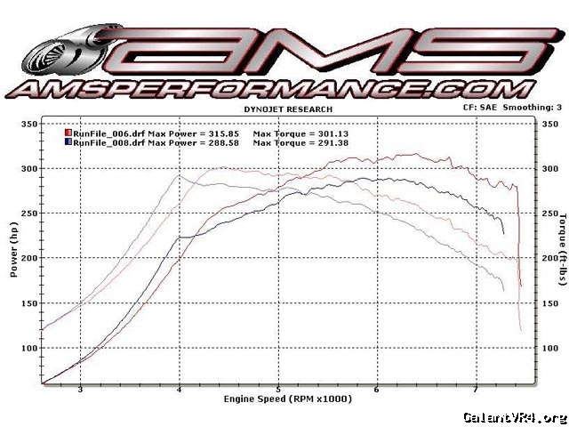

FP18g = higher boost threshold but more lag. E16g should get you going pretty fast on a decent setup and tune. Look at the dyno comparison to a normal 16g and notice the higher RPM boost but later spool.
