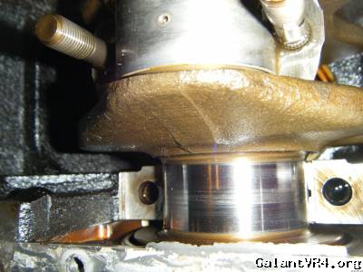

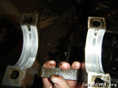

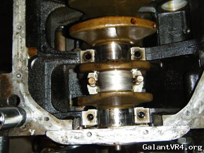

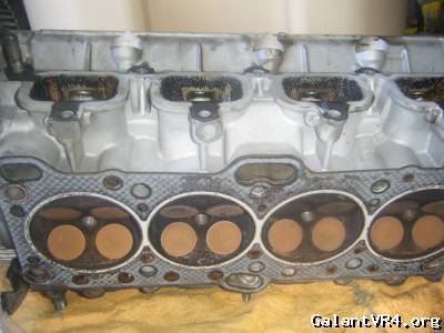

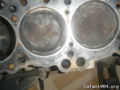

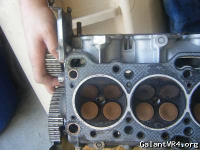

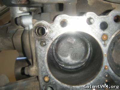

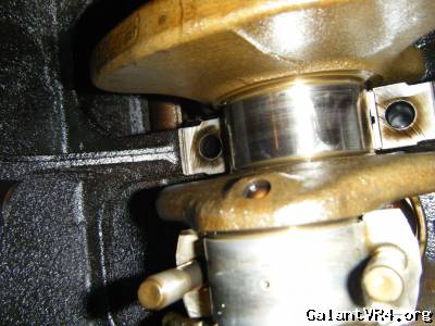

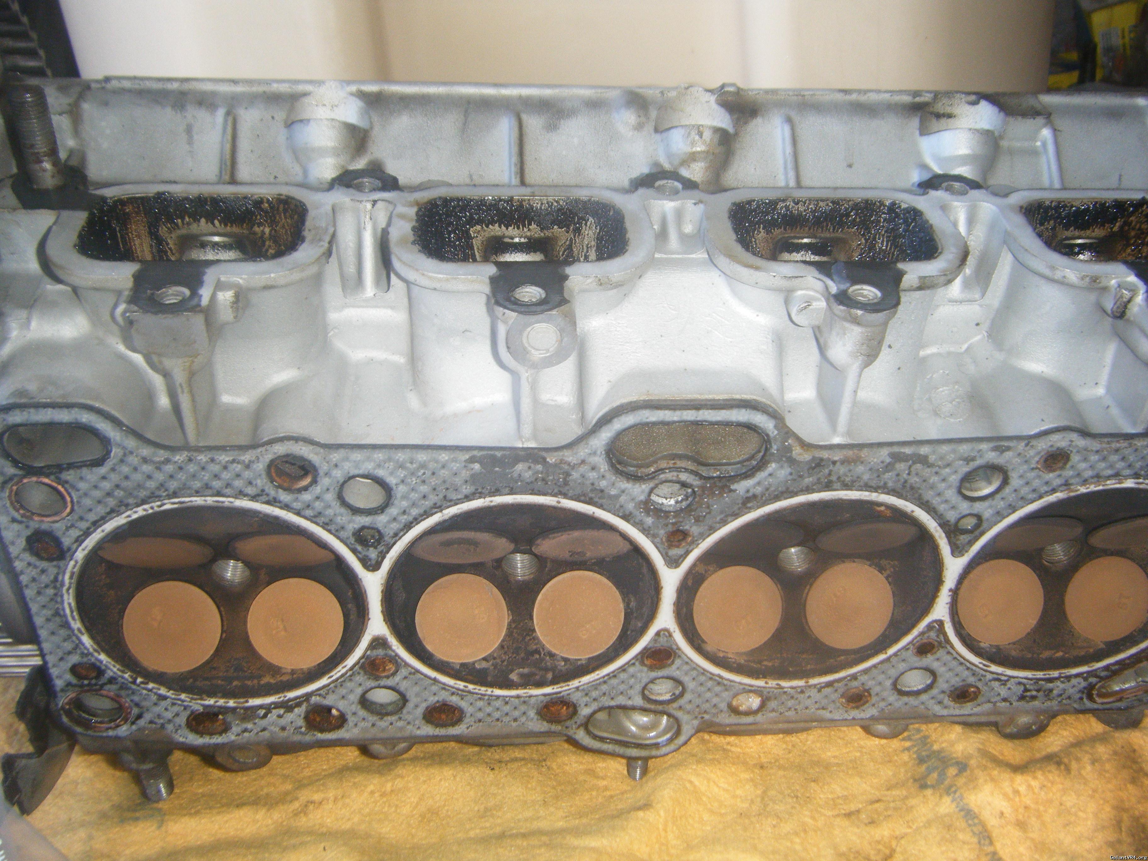

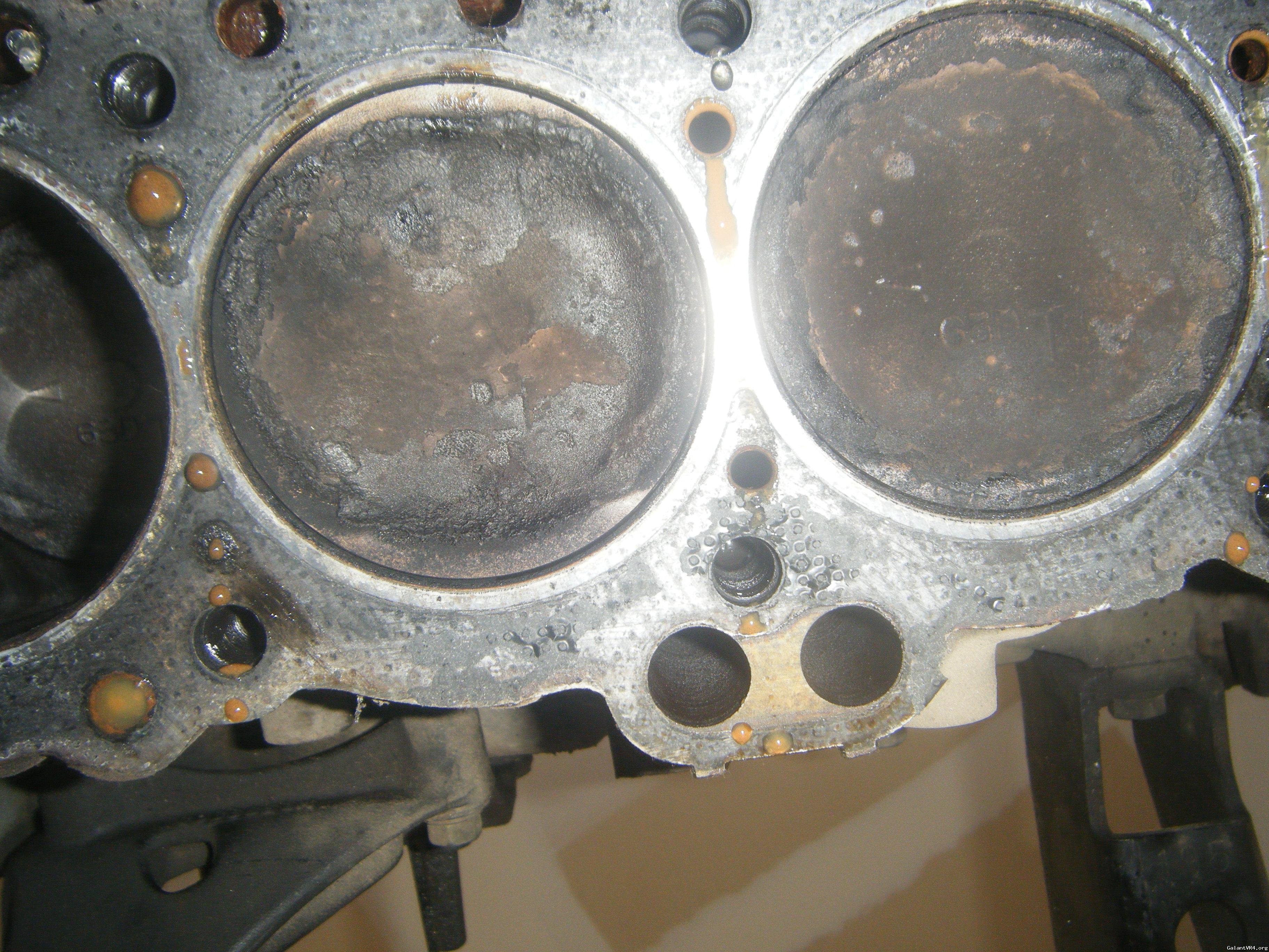

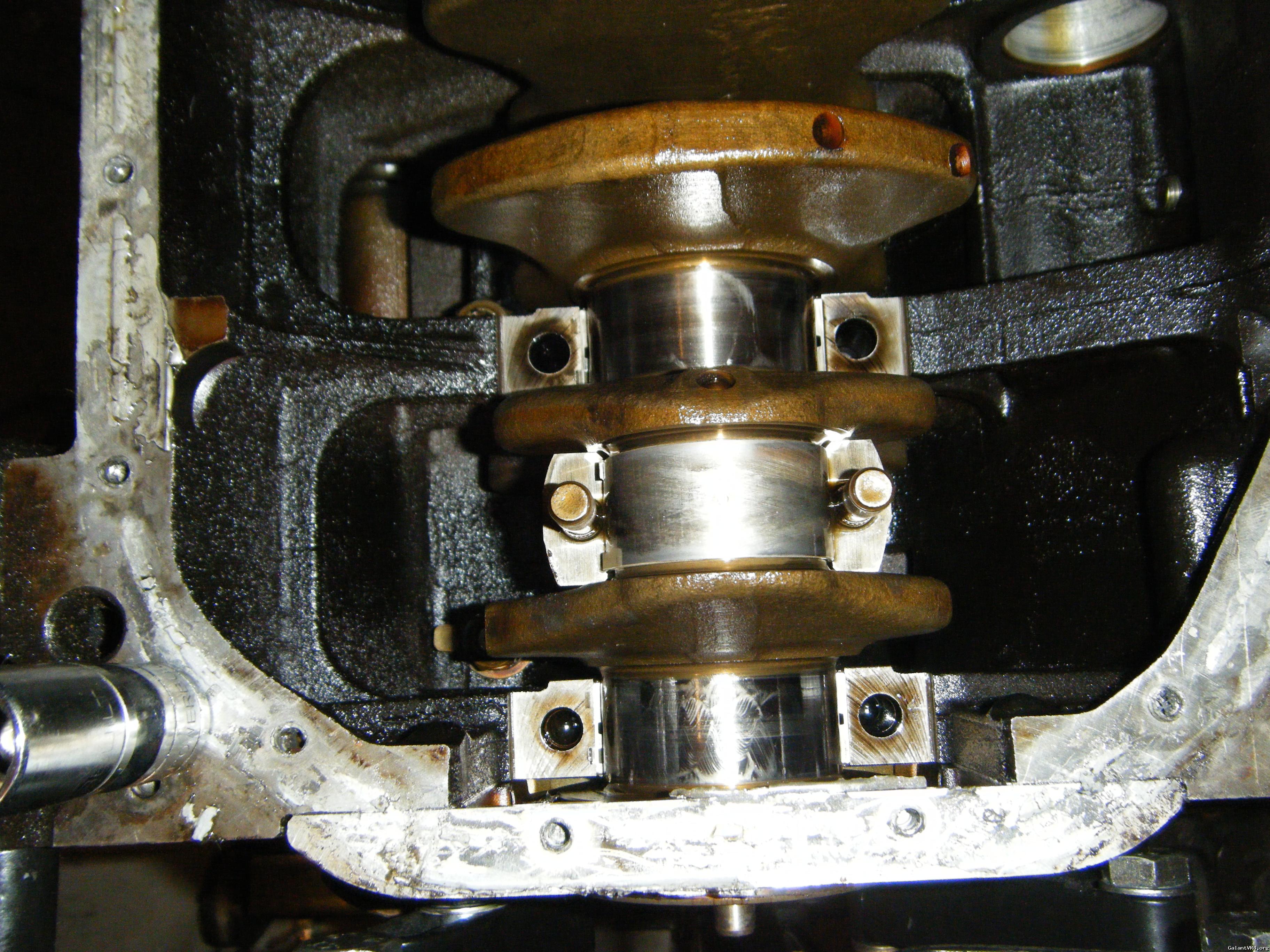

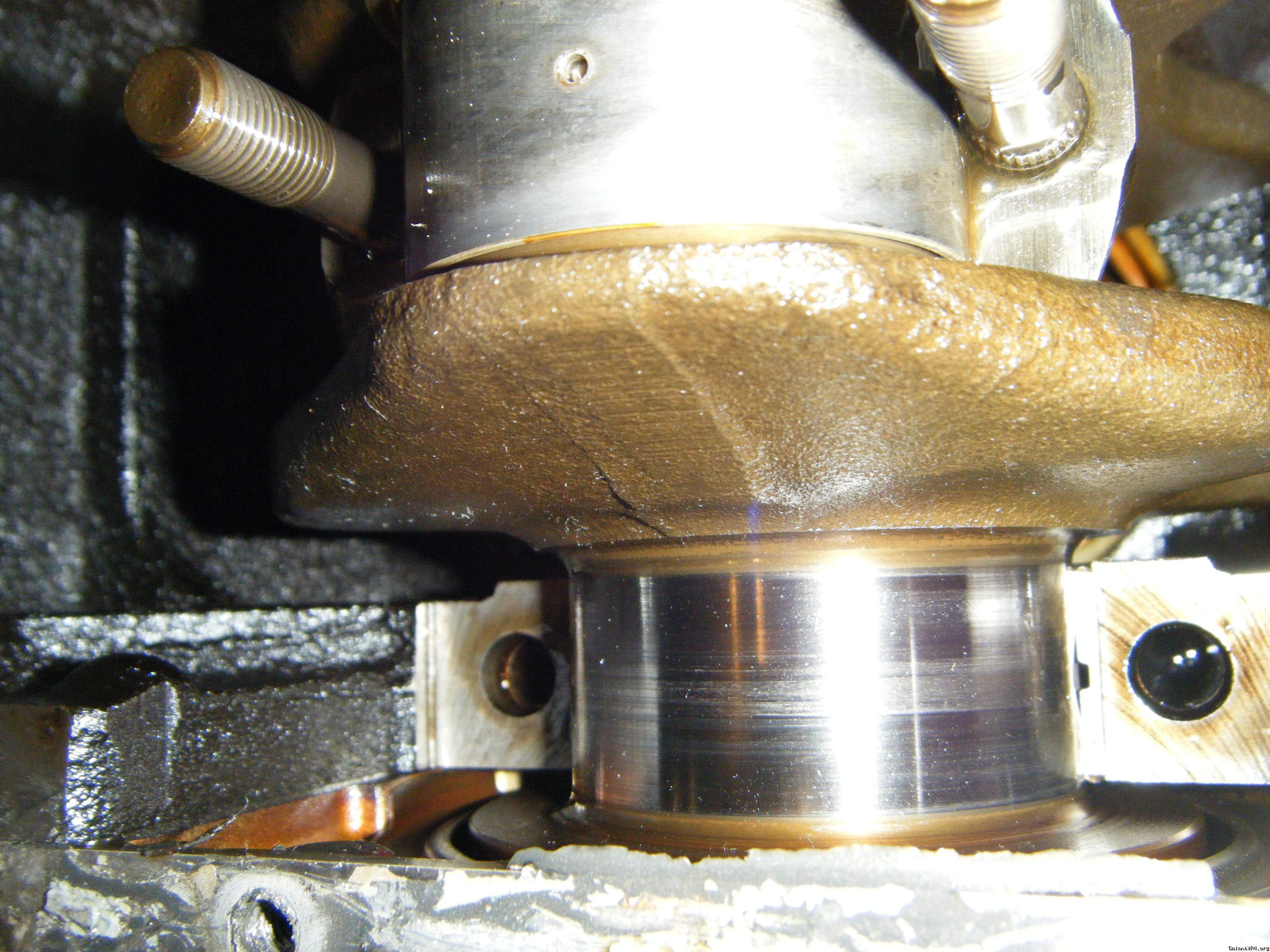

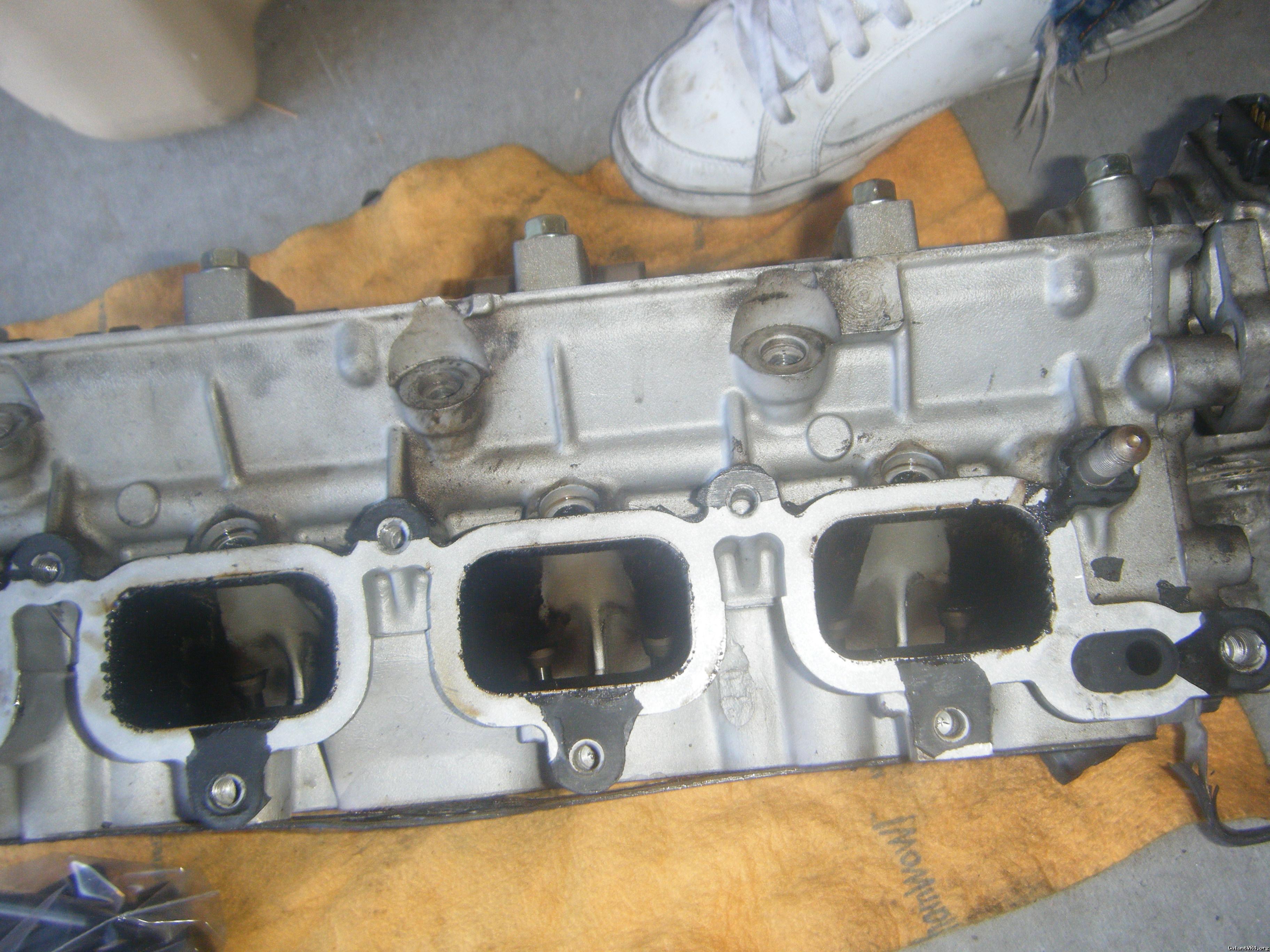

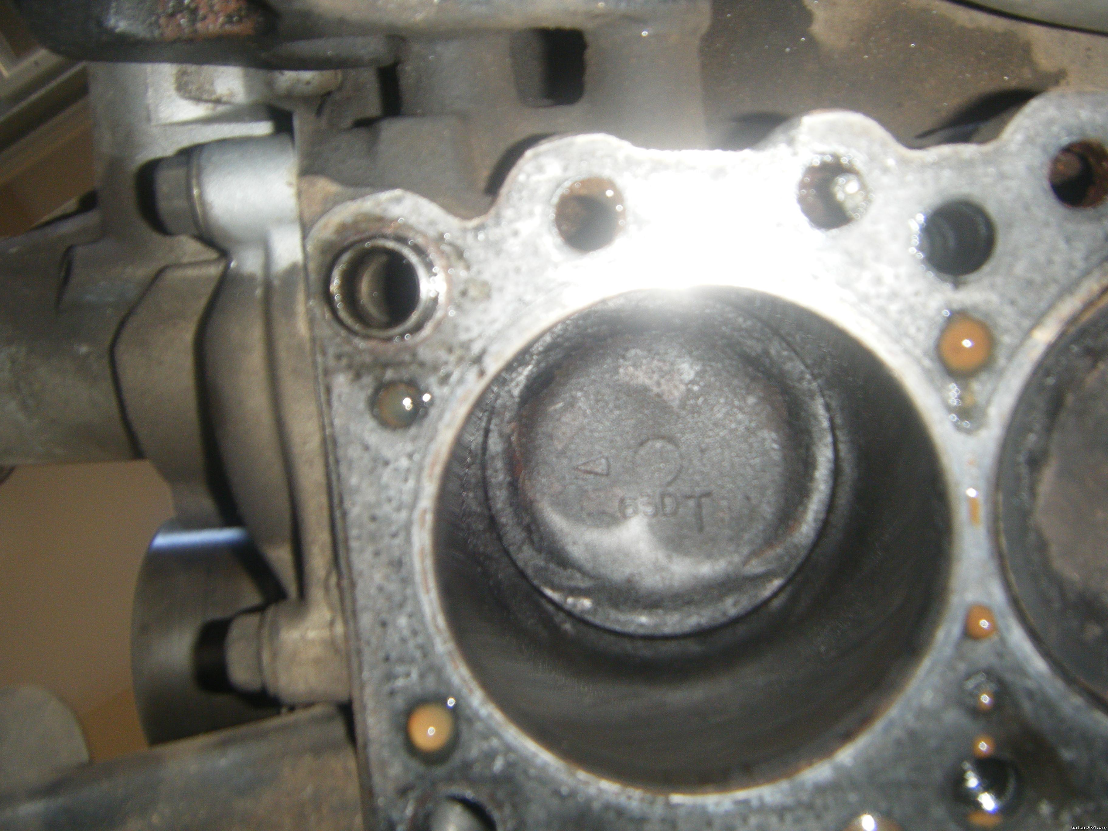

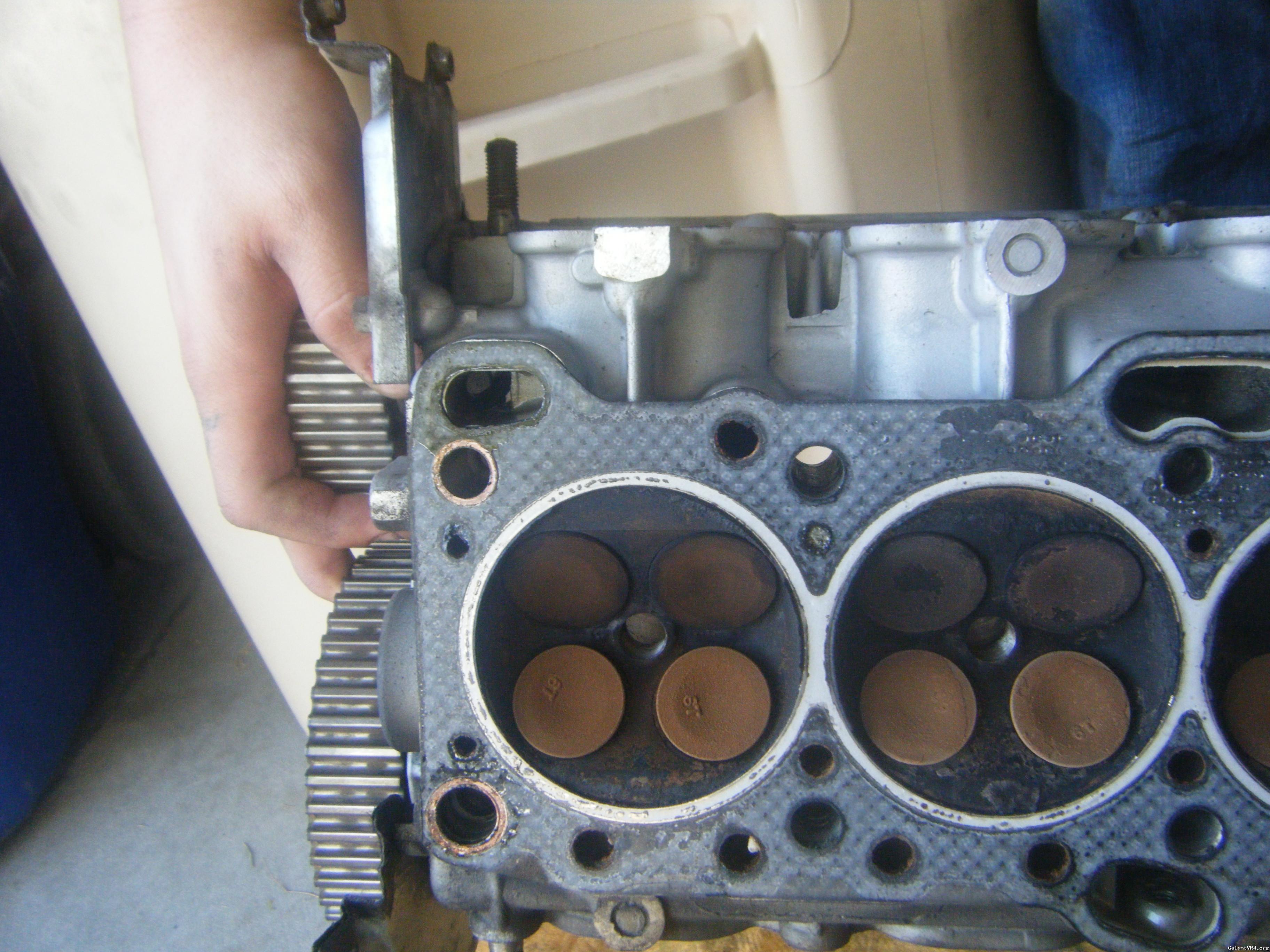

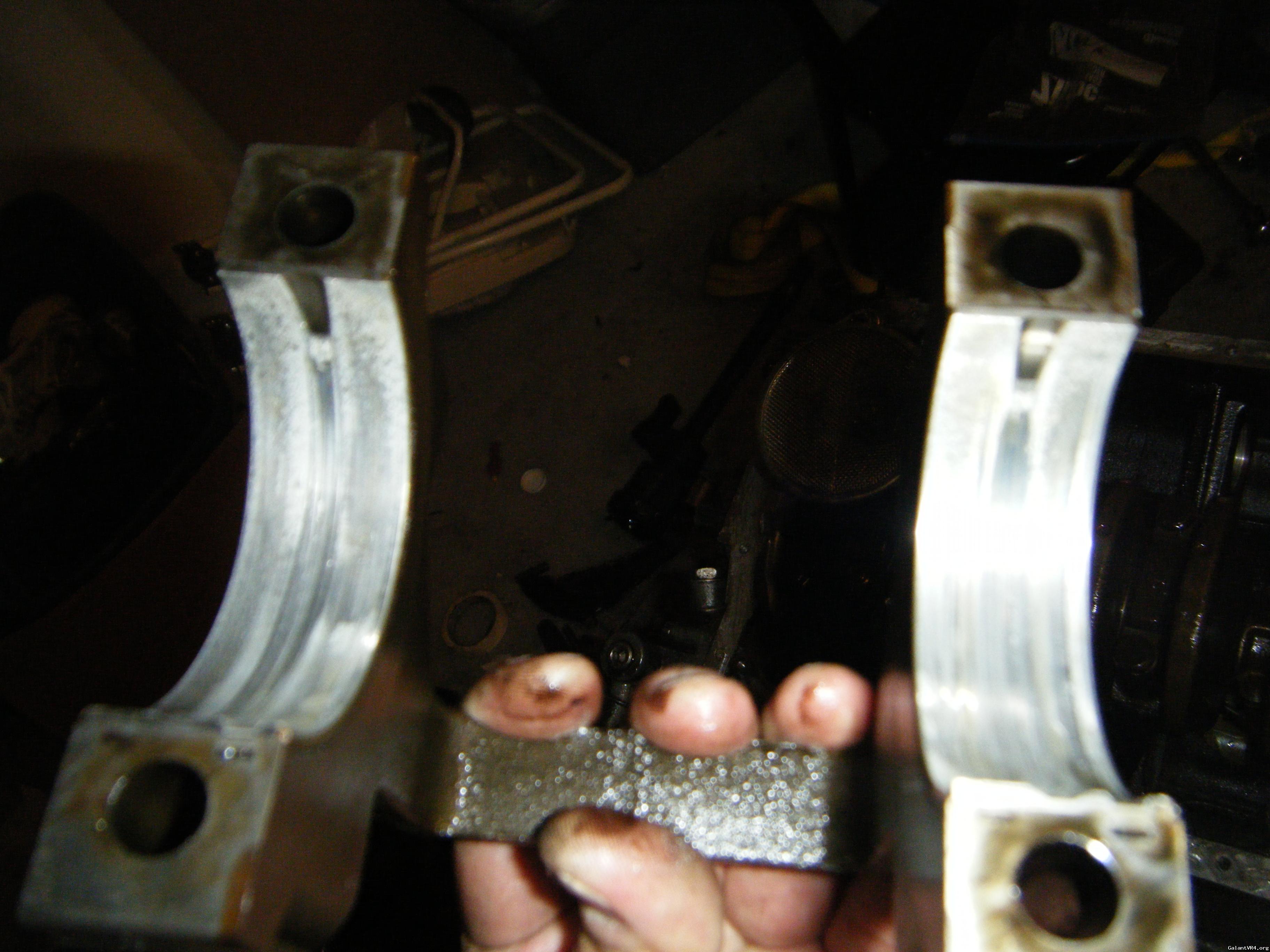

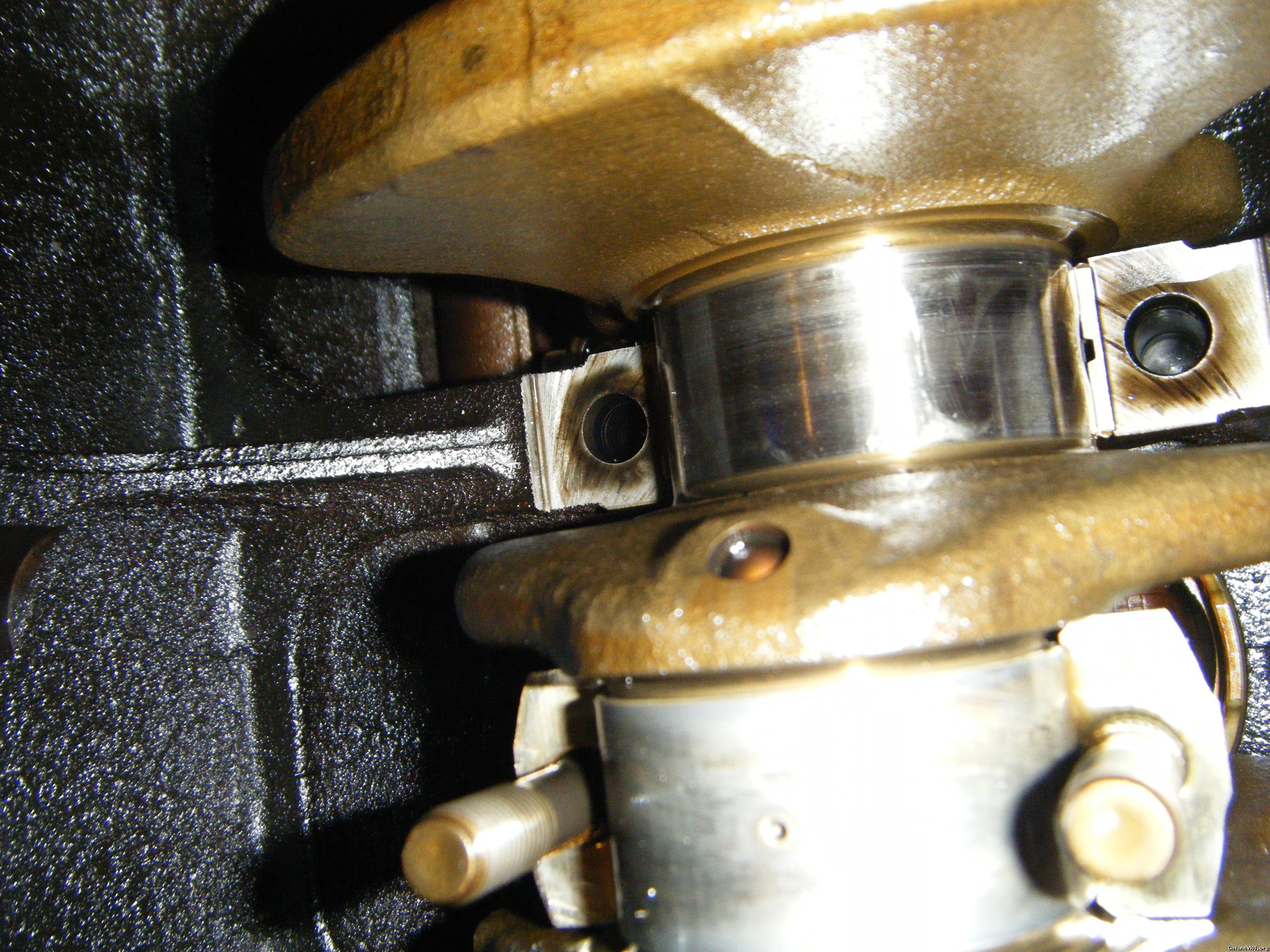

well I pulled the head and it looks ok but on the crank the 2 outer rod bearings were loose enough to shake with my hand and when I pulled the main bearing the one that has that bridge with 2 bearing? see picks the big bearing closest to the side where the tranny connects, after I removed that part the motor freed up there is some noticable marks on the bearings and i dont know whats good or bad. On first inspection the cylander walls look and feel ok . I guess next step Is where is a good place here in the mesa,tempe, phoenix area to get the block inspected and have the short block rebuilt for a good price I have 1200.00 for the block and head? thanks all for the large amount of help you have given me /ubbthreads/images/graemlins/worthy.gif click
Well got my head back and it looks great but it was warped and the bill went up to 320.00 now for my short block, I sent it down to Basko her in Gilbert Az, and after I thought it was not all that bad boy was I wrong . Rick at Basko said the pistons are odd shped and need to be.replaced as well as the block is shaped odd as well so it needs to bored over this is all on top of a crank kit as well so were at.1300.00 plus tax this whole thing is.about too be put in the back yard and rot .... I should have known that when I found this car for such a good price 3500.00 that it was too good to be true because I only got to drive it for 2 months and then it just locked up..... /ubbthreads/images/graemlins/bawling.gif
