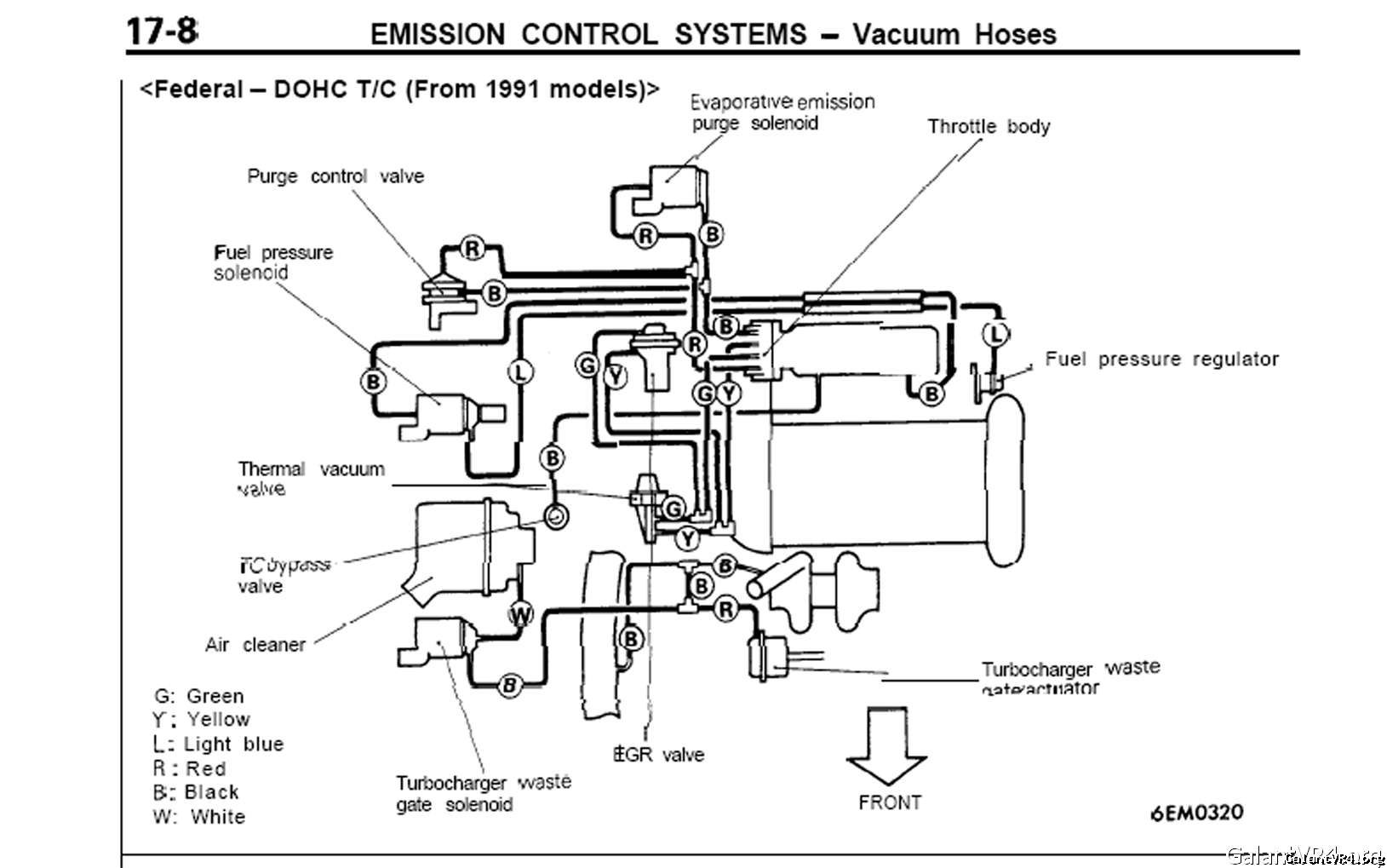

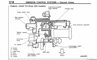

i would like install emissions back on my car does anyone have a diagram how to install ?

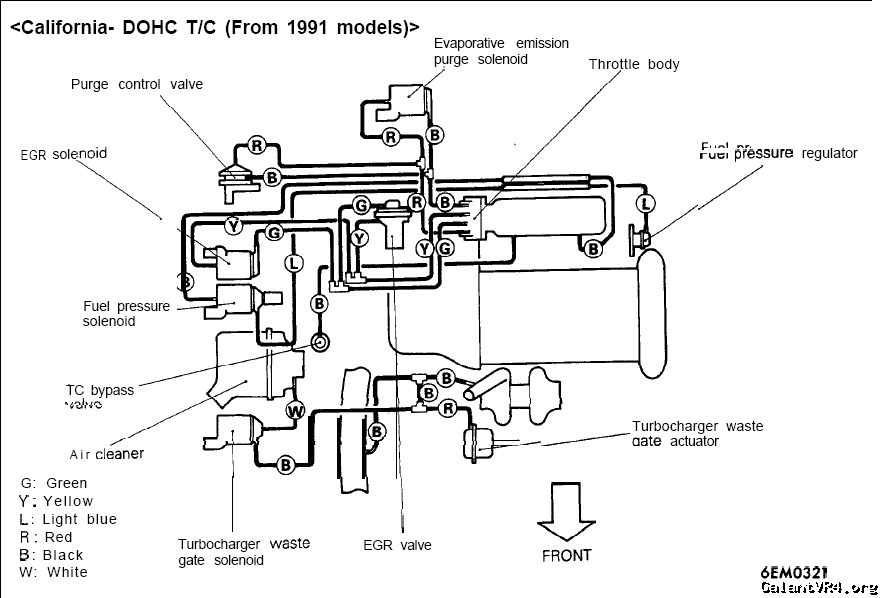

This should be just like the diagram on the sticker under your hood:
I see I have a california car
