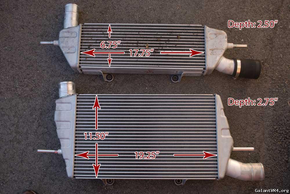

While I was at work one day (El Cajon Mitsubishi) I noticed the EvoX FMIC, flipped front to back, might make a good near bolt inintercooler for the GVR4.
the Inlet outlet in a flipped orientation seems to be optimal for minum addaptation.
here is a picture of a stock EvoX IC and a Lancer RA IC. Just imagine these IC's flipped front to back.
10,992
Jim, Paul is apparently not intimately familiar with those products.
Top smaller is Lancer Ralliart (lower HP turbo model), lower larger is the Evo (higher HP).
