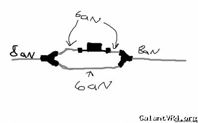

Here is what I picked up to run this sensor, Curtis is right about the sensor having a restriction as the fuel flows through it, it takes up maybe 2/5ths of the internal volume of a 6an return! Though, some if not most of these sensors in use don't run a y-fitting and just run it as is so maybe it's not a big deal?!? I didn't want to chance it though.
1. Russell PN: 644123 (black) x2. These are the 6an fittings for either end of the flow-through ethanol sensor.
2. Vibrant dual 6an to 8an Y-Fitting (black) x2. These are the Y-fittings you'll need to make sure there's no fuel return restrictions.
3. Earl's 6an tube nuts (black, two per package) x3. Tube nuts for 6an ports on the y-fittings.
4. Earl's 6an tube nut sleeve (black, two per package, color is wrong in pics!) x3. Tube nut sleeves.
EDIT>>> As for the sensor, I used the GM Part # 13577394 (the long tube version), but if I were to do it over again I would have gone with the GM Part # 13577379 (short tube version), the sensor was about 80 bucks new from GM and is a Continental branded part in a GM bag w/GM part number. I also grabbed the GM pigtail part number 13352241.
Then, all you need is a piece of steel 6an tube, this is how it should look /ubbthreads/images/graemlins/smile.gif Alternatively, you could just use teflon lined ss braided an lines. Also, my return is 8an so that is why I used the 6-6-8an y-fitting.
Total cost to plumb this into the return has been ~ $195.00 not including the SS 6an hard line I'll need to pick up to complete this part of the return.
