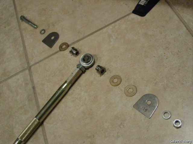

now, the hard part was getting the needed components to attach it to the car.
If there was such a thing as a Metric Hiem End "Hiem Extension", then this install would be cake... However, there is not.
My solution was to change the fasteners over to "standard".
What I used was a 1/2 inch bolt that was the same measurement as the OEM piece, and went from there.
as you can see from the picture, per arm I used,
one 1/2 inch bolt w/ nut
two split lock washers
three half inch washers that match the diameter of the OEM rear camber adjustment washer *3rd washer is used as spacer* - (see pic and explanation below)
two 1/2 inch Hiem ends
two DIY mounting tabs from performance metal supply. (not nessary)
By using washers that are the same diameter as the stock ones, we can "lock" the new bolt into position.
Using the new washers also deletes the factory adjustably placing the bolt on center BUT, with the AFCO arms you gain much more adjustably than stock.
It is a must that you use washers that have a 1/2 inch hole that is exactly the diameter of your new bolt.
In my case, I couldn't locate a set of washers that had the perfect ID, close but not perfict.
So I had to use two tabs per arm that I got from a performance metal supply, to totally lock in the bolt.
It worked out perfectly.
