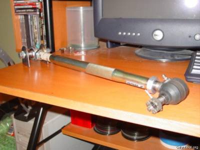

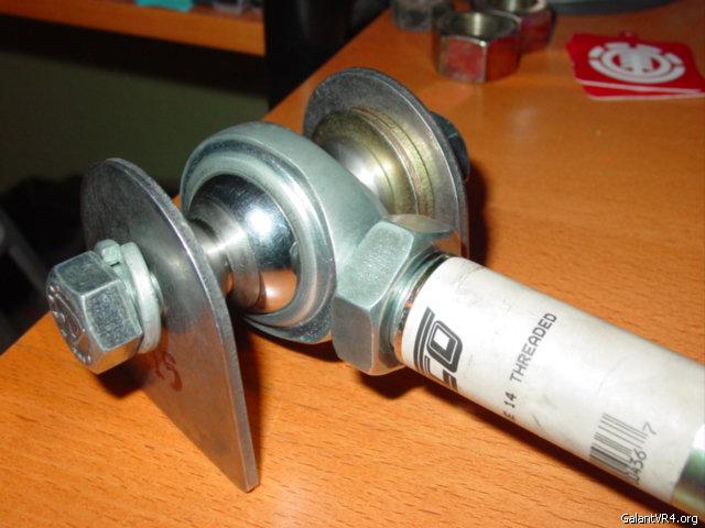

I had a question about the spherical rod ends...are they high quality type and do they have any 'safety' built in, should they shear (I guess by nature they would, but thinking more on the bolt side of it and have read some horror stories using them, but that is mostly with 4byin' applications, which is a whole 'nother can of worms on the suspension forces /ubbthreads/images/graemlins/wink.gif )...I guess the forces we encounter in this location though wouldn't be so much of a concern, but I'm still curious...
This looks like a nice 'upgrade' and will add another one to my 'to do list' now, he he...Thanks again for the info...
It looks like it may be able to. I forgot to bring them home with me, but I'll get more pictures up of the arms .

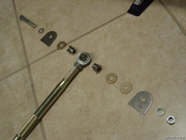

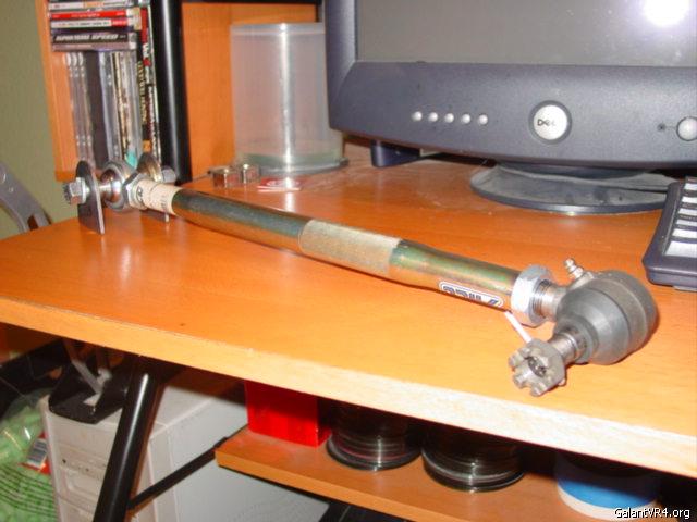

so i'm having problems with the install.
the rod end spacers seem to be too long (easy fix with a hack saw) but, the 3/4 id of the spacers is not big enough.
I might have bought the wrong pt#, I'm not sure though.

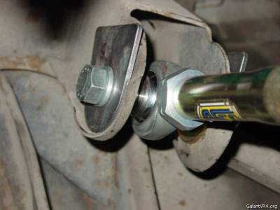

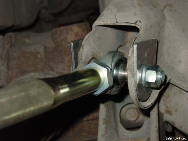

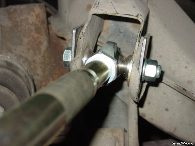

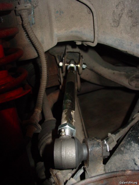

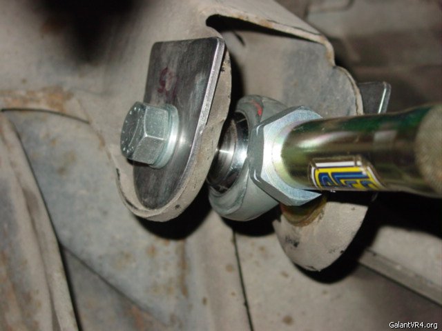

I just finished the install right at Midnight.
I don't have as much time to mess with the Galant as much now as I got a job (finally), working at a Saturn Dealership (and yes, i do more than just oil changes)
Any way, changing the camber is now hella cake.
all I do is...
1) jack up car slightly
2) reach under the car with my left hand and grab the lower jam nut, and loosen it.
3) reach through spokes in wheel and grab upper jam nut with my right hand, and loosen it. (works better with big boy 18' wheels like mine /ubbthreads/images/graemlins/cool.gif )
4) grab AFCO arm with left and turn right or left to adjust camber.
5) after selecting desired camber, reach back in and tighten jam nuts
6) drink a beer coz your done.
The whole thing cost me about $130.00 (the ingalls arms were $145.00 when I got um)

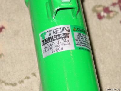

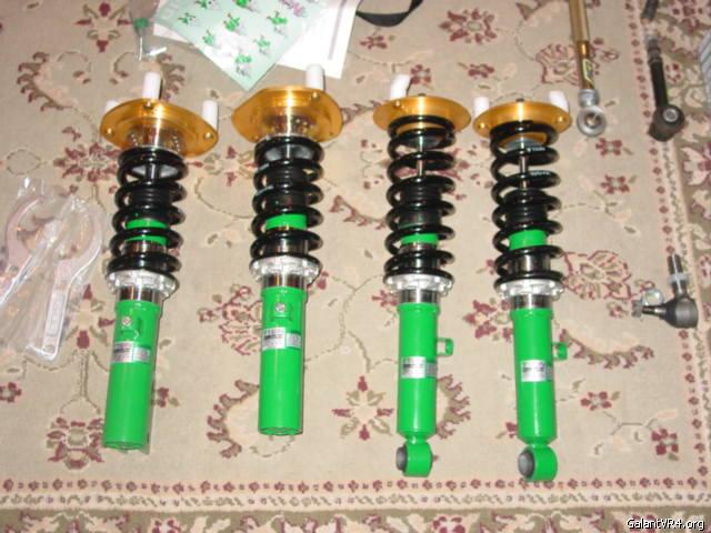

oh ya, one more thing... sorry Larry, changed my mind (yet again) on the GT35/40R and bought "these", which went in during the AFCO install.
Before I start getting bombarded by PMs...
I will list what parts I used to complete the AFCO setup, next week.

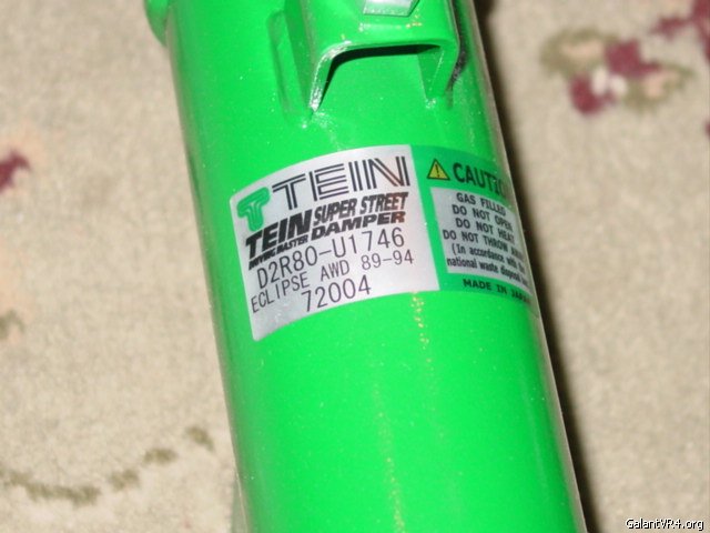

Yes, the 1G Eclipse coil-overs fit.
Yes, the Eclipse camber plates fit... if you are smart and relocate one stud its easy. BUT if you are dumb like me, you can make a new strut mount with an Eclipse bolt pattern and install away, ya moron /ubbthreads/images/graemlins/banghead.gif ... but, the added steel will reinforce the mount, so its not to bad of a dumb mistake i guess.
Factory hight Settings on Tien SS (untouched) is the same as the ride hight of the AGX and Ebach Sportline setup (expect its an even drop with the tiens) no 2/3G rear mounts necessary.
