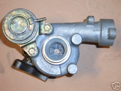

The turbo isn't 13G.

Well, i know it's not a 9b, or any other B series. It's definitely a G series. I'd venture another guess and say it's a 15g, but there's no way it is larger than that. I would say 14g, but i'm pretty sure that thing died out with the StarQuest era of mitsu cars.

Well, considering how the rest of the car should not exist... your turbos don't seem to exist either! /ubbthreads/images/graemlins/grin.gif
MD181852 is the downpipe for the 'right' or front turbo. There is a number cast into the exhaust outlet on the first photo, which appears to be 181851, or MD181851 if it were a part number. But this doesn't seem to exist either.
The 49193-29501 is an identification number for the complete turbo unit. It should be a Mitsubishi turbo based on the 4xxxx number but the massive list of turbos I have access too doesn't even go to 49193!
49124- TC15
49127- TD15
49129- TF15
49130- TD02
49131- TD03
49132- TD09
49134- TF08
49135- TF035
49160- 4MD
49161- 4HD
49162- 4LE
49163- 4LF
49166- 3LM
49167- 5MF
49168- TC05
49169- TC06
49170- TC03
49171- TC04
49173- TD025
49174- TD08
49175- TD07
49177- TD04
49178- TD05H
49179- TD06
49181- TD10
49182- TD13
49183- TE04H
49184- TE05
49185- TE06H
49186- TF07
49187- TD07S
49188- TD08H
49189- TD04H
After a bit more searching I stand corrected. I've found a mention of 49193 on a Suzuki Alto website. 49193-25302 is listed between the TF035 (49135-03110) and the TF035H (49495-60701). It kind of looks like your turbo...
Can only guess the light sensor is for automatic headlight activation?
This car is full of mysteries!

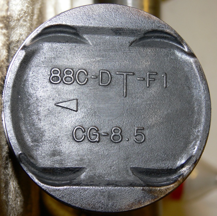

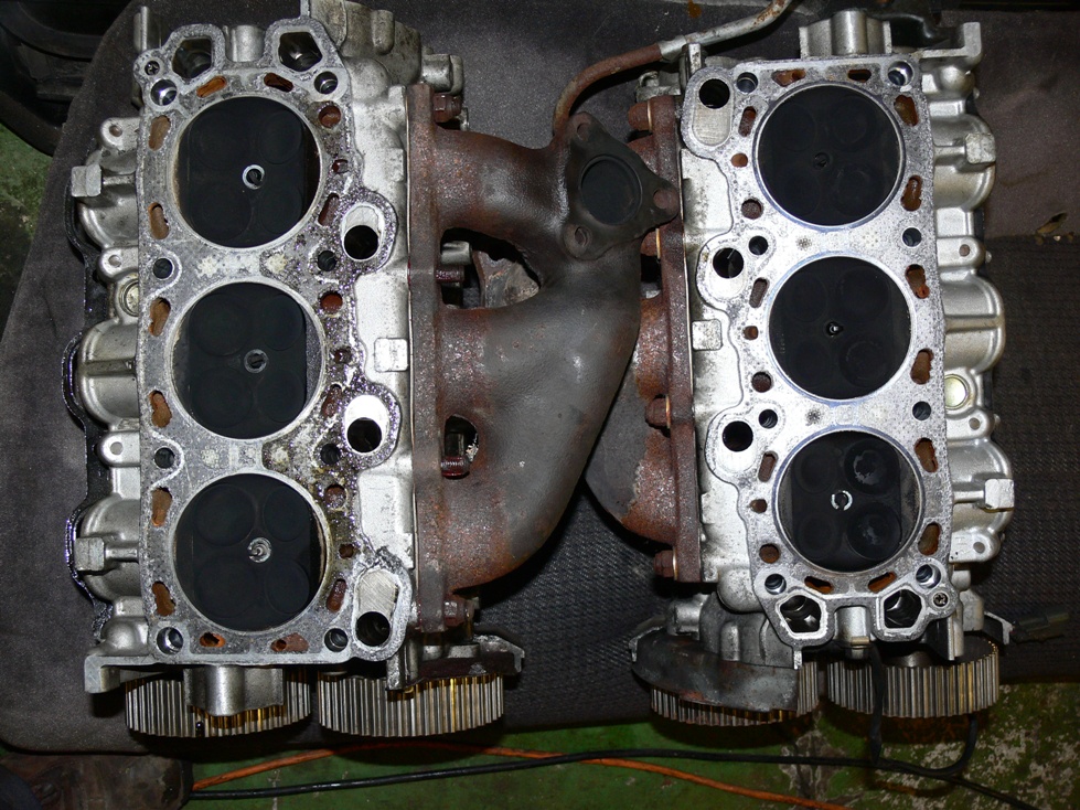

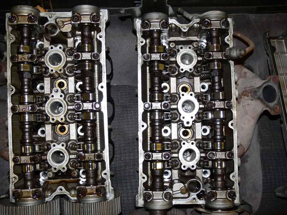

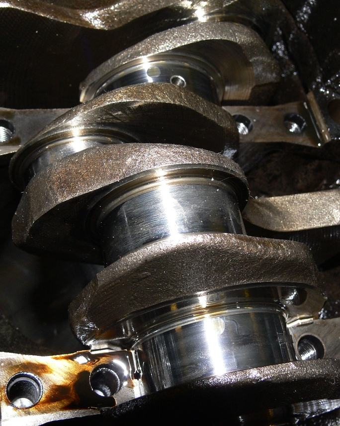

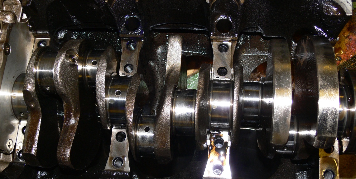

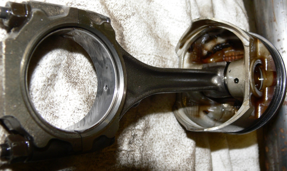

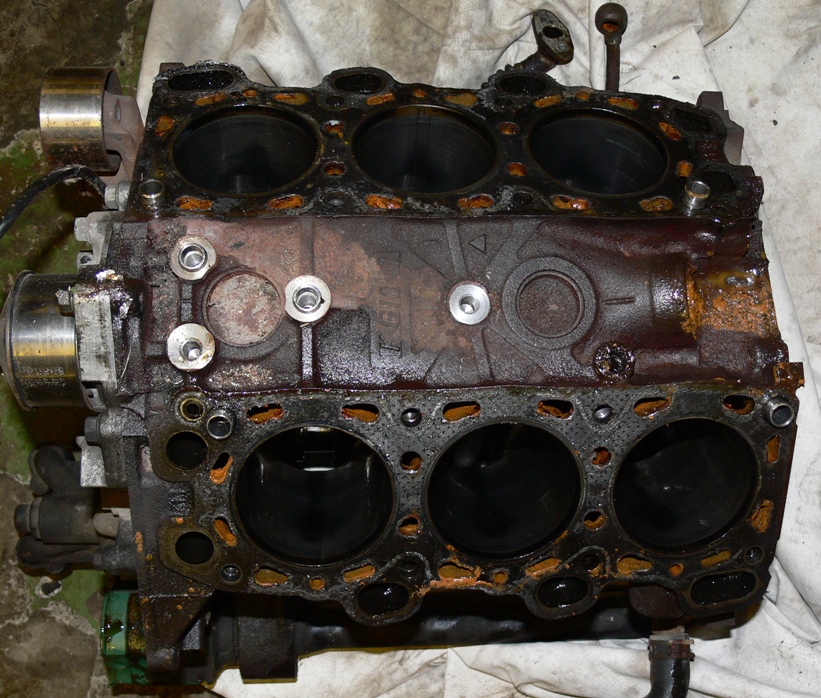

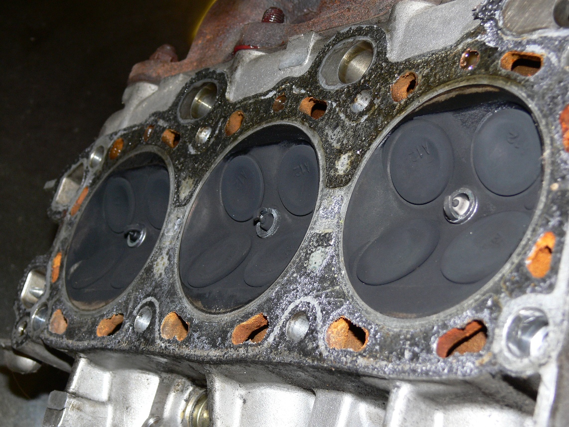

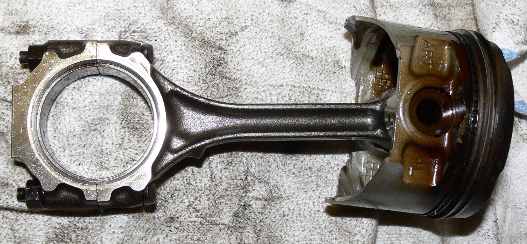

Hi everybody.
I got new pics about the E74A engine.
The conrod bearings have some wear, but the crank and the cylinder heads are beutiful. The block has a minor scratch in the 3. cylinder.
Check them out.

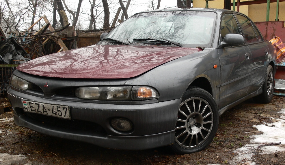

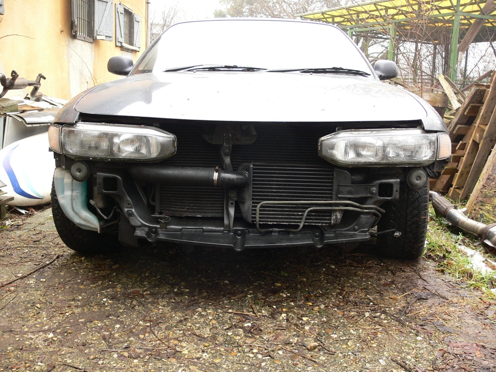

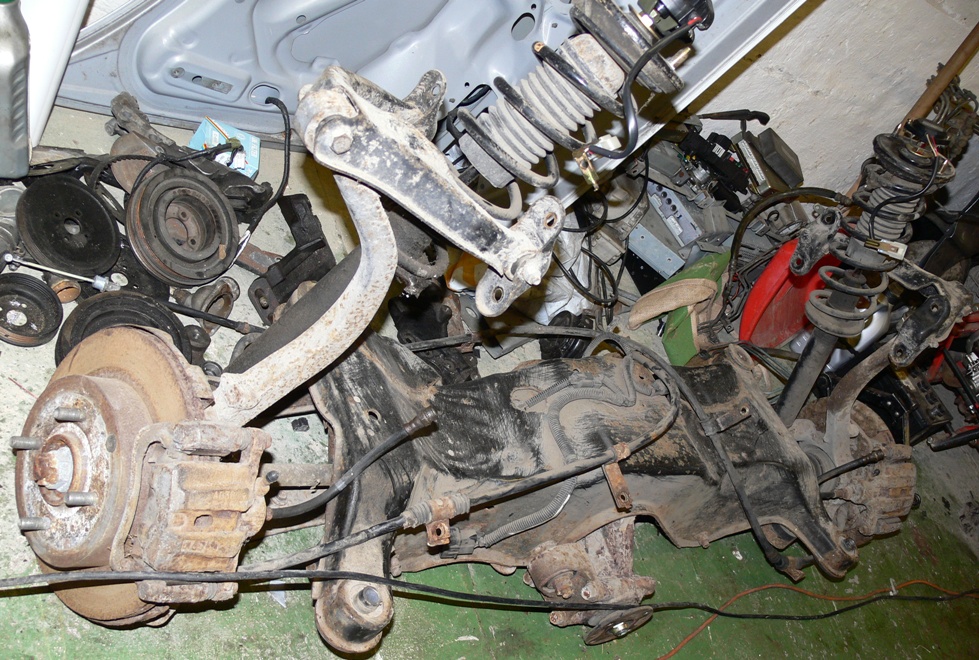

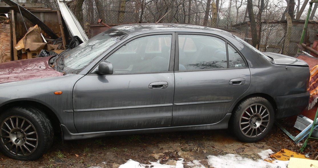

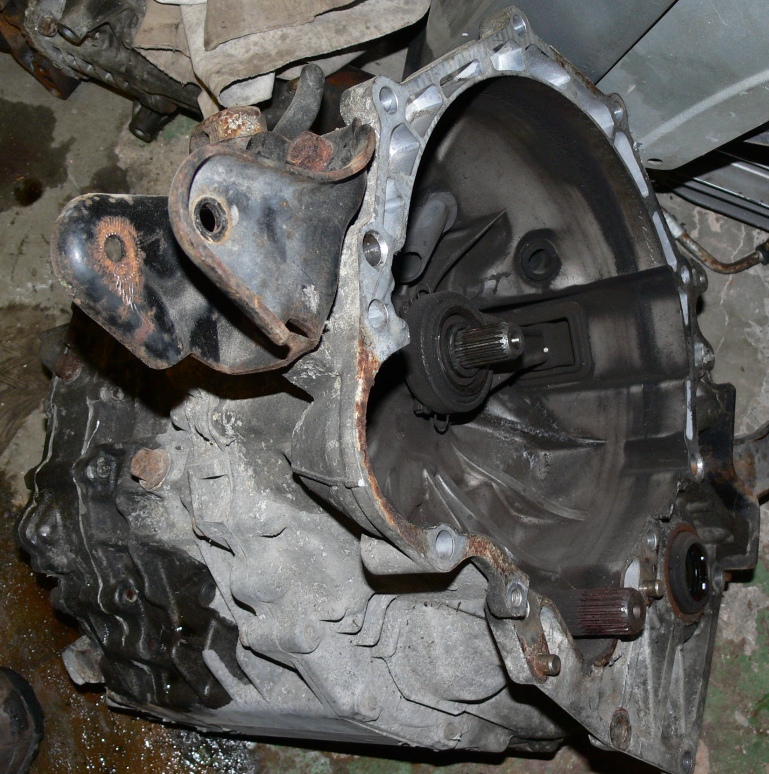

The car in the last two pictures is my new ride. I just bought it to sale one of the VR4 engines that I have in its engine bay. E88A, 2500cc V6 DOHC 6G73 4WD 4WS, it is the same as E84A except the engine.
