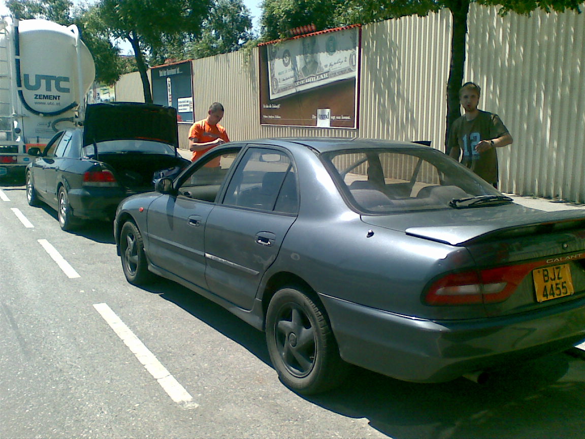

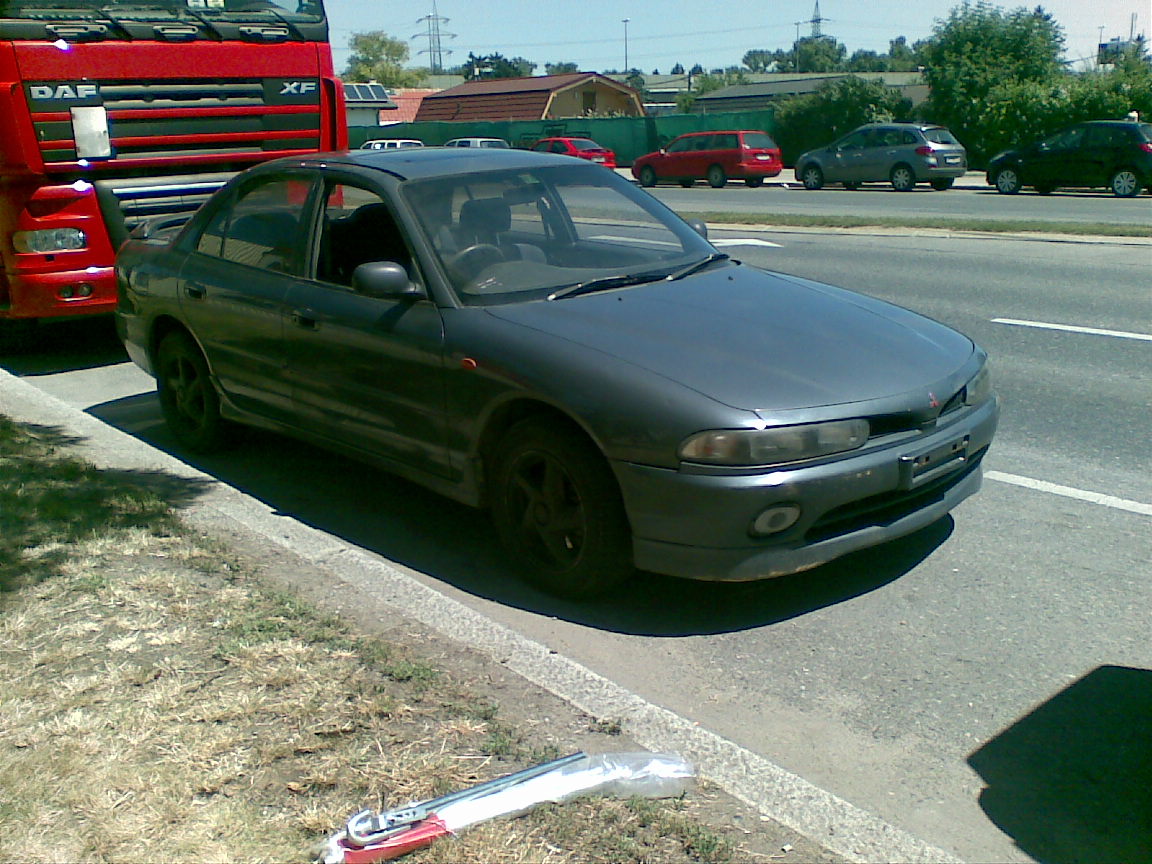

E74A (prototype?)-E84A VR4
One question. Those 16 inch AEZ rims on the E74A was factory default wheels? It has mitsu covers too.
My other VR4:
This dark gray car is E84A with every paper clear.
The silver one is the E74A with the strange VIN.
