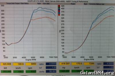

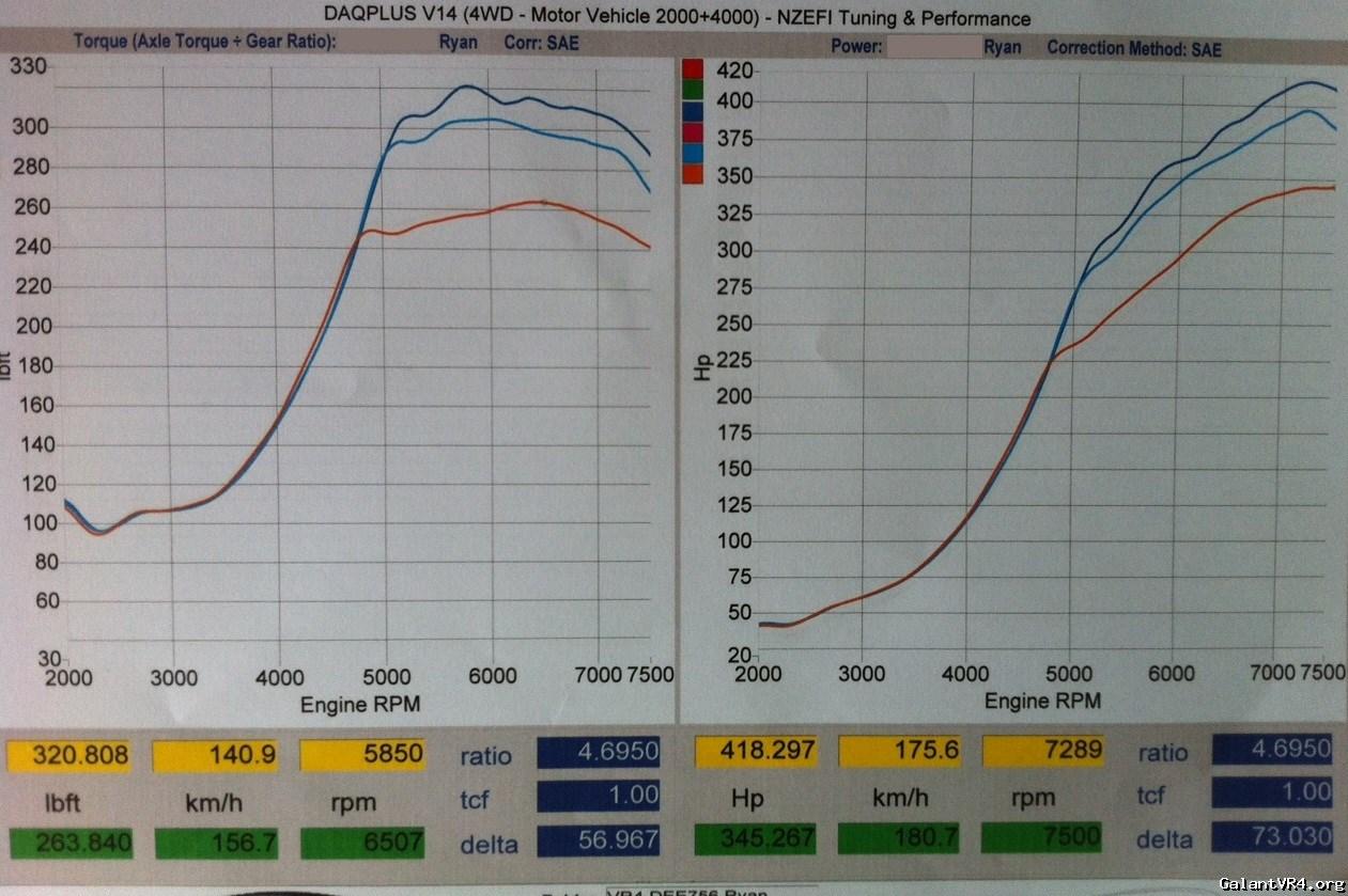

Car was dyno'd yesterday. Made 420hp at the wheels. I have to doublecheck how much boost that was with, off the top of my head it was 24psi. The tuner said he was adding more boost but not getting extra power due to having to limit timing. The pump fuel was obviously the limit of that.

This was tuned on a standalone ECU called a Vipec. I dont know the tuning software well enough to pull them out sorry. I will look into it though to see what I can find out.
