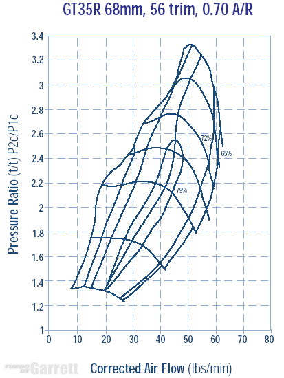

30-45 /ubbthreads/images/graemlins/wink.gif
Edit: I don't think I'm reading that right. The tooner should know what to make of that chart though.

40 lbs/min. Therese some computations necessary to get the psi. the turbo runs up to 79% efficient everywhere in that smallest center island. That's the sweet spot of the turbo and that's where it will be best utilized.
Is this a track car, Weekend warrior, or a dd?
--Edit--
Conversion factors:
(PR X 14.67psia) - 14.67psia = Boost
kg/sec X 60sec X 2.2046lb/kg = lb/min
m^3/sec X 60sec X 35.3ft^3/m^3 = CFM
CFM X .07 ≈ lb/min
