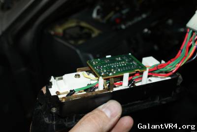

I know there is a DSM VFaq on this, but I pulled my Galant window switch out and it doesn't look the same. I know I've heard this mod is possible but I searched for about 20 mins and couldn't find a how-to on here. If anyone has any pics, diode info, or help it would be appreciated. Thanks,

Thanks for that info, but I'm not really looking for anything aftermarket. The factory switch is made to do it, but the simple circuit isn't there. I know I have to cut the stop tab off, but I need to find out what diode, and where to solder it in. The 1G circuit boards are slightly different.

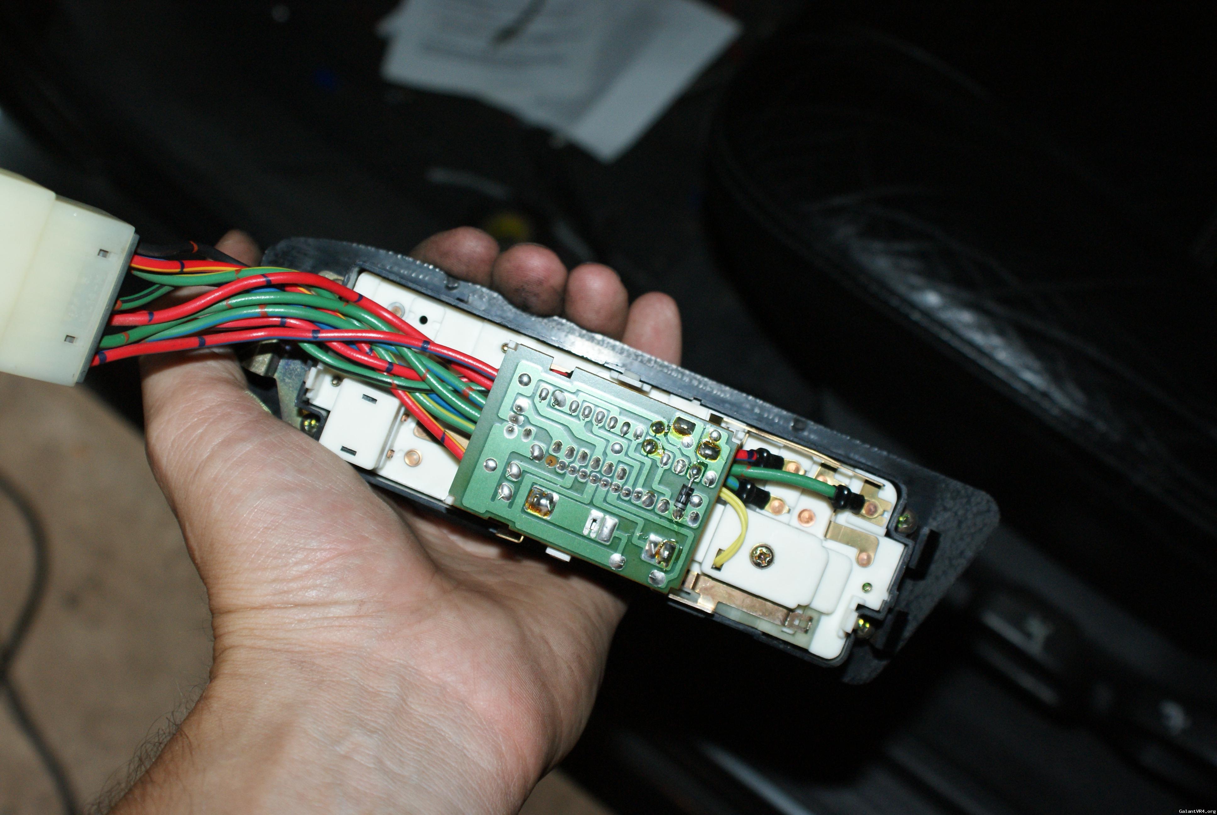

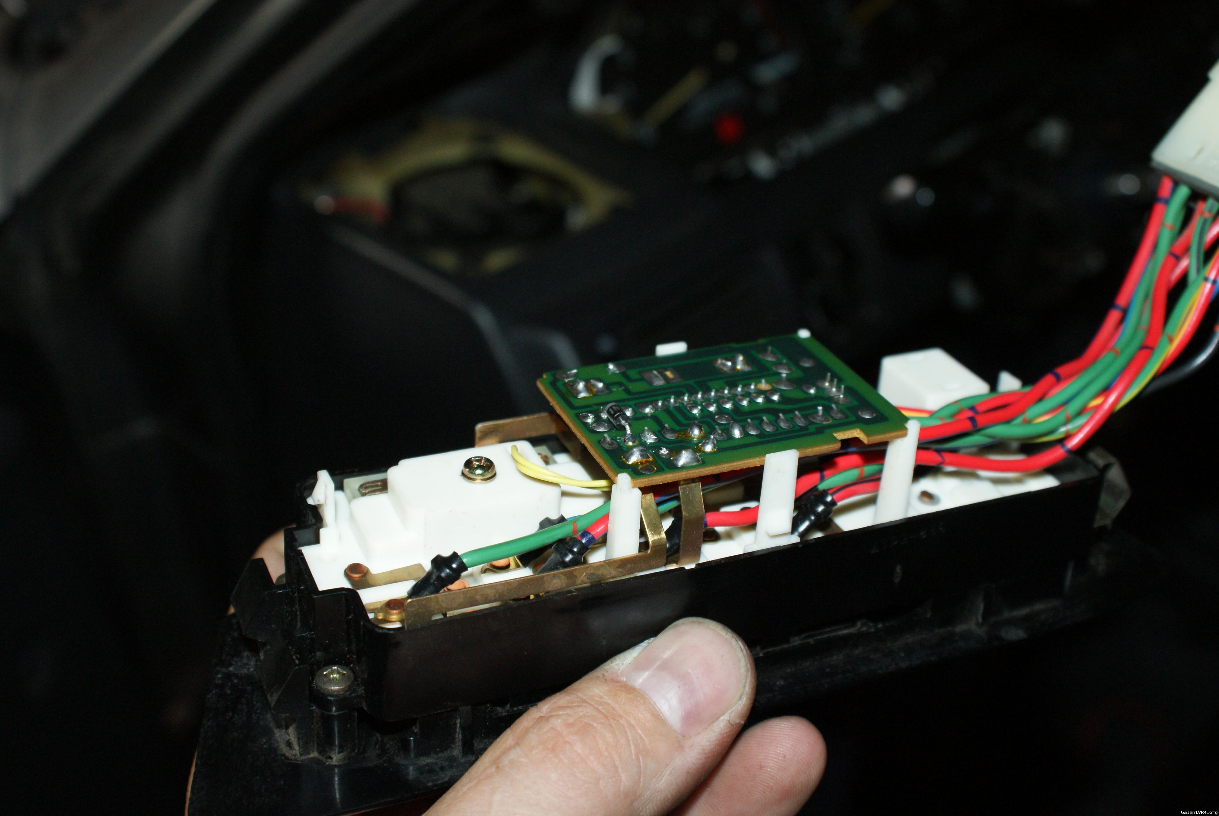

So after some time looking at it, talking to a few old-school GVR4 guys, I was able to figure this out. You need to use the same 1A Diode that's in the DSM Vfaq, but solder it in the second slot. There is an open slot with a diode symbol on it. Just follow the Vfaq, but not the placement.

Yup, just break off the tab in the switch, and solder that little guy right in that spot. Bam, JDM hotness auto-up. Thanks for the pics!
