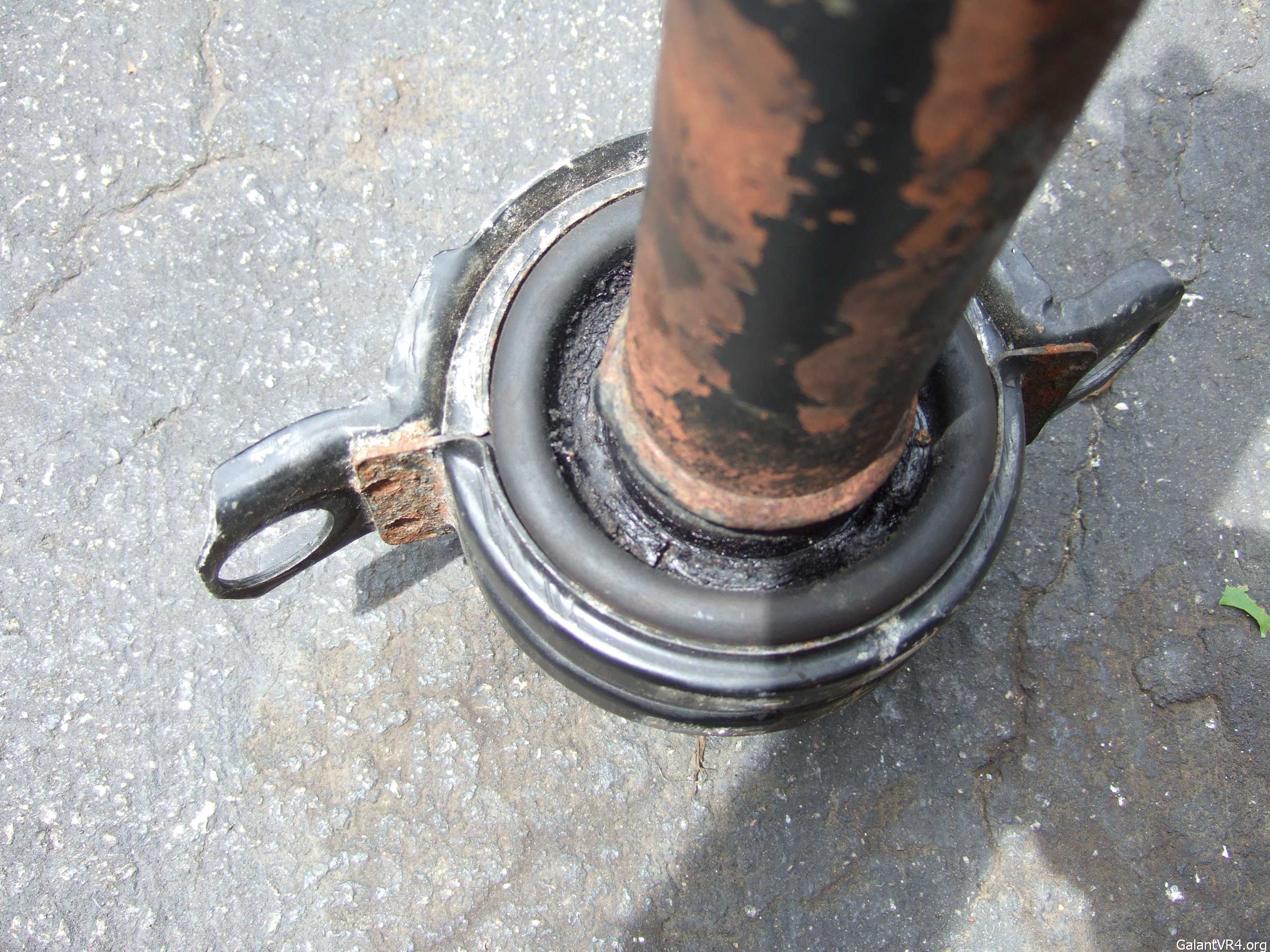

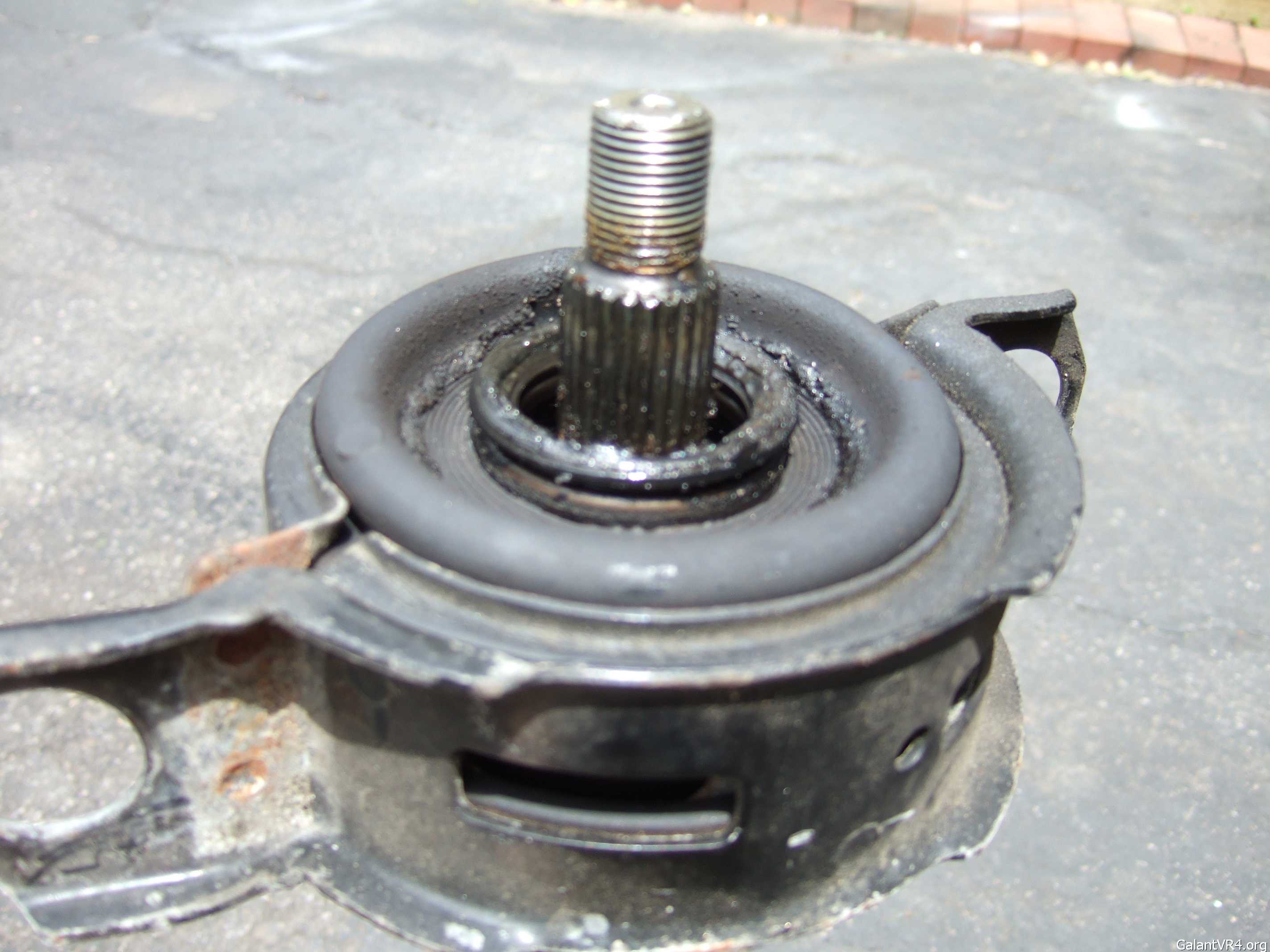

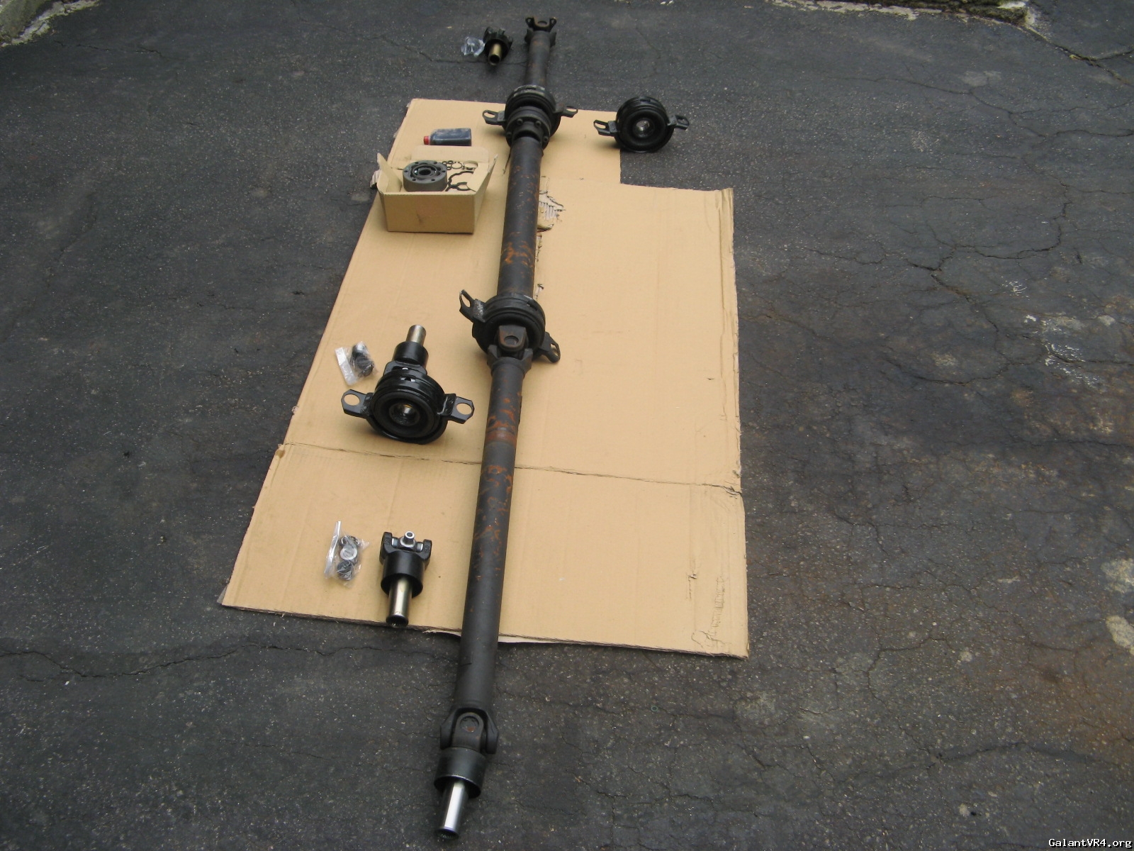

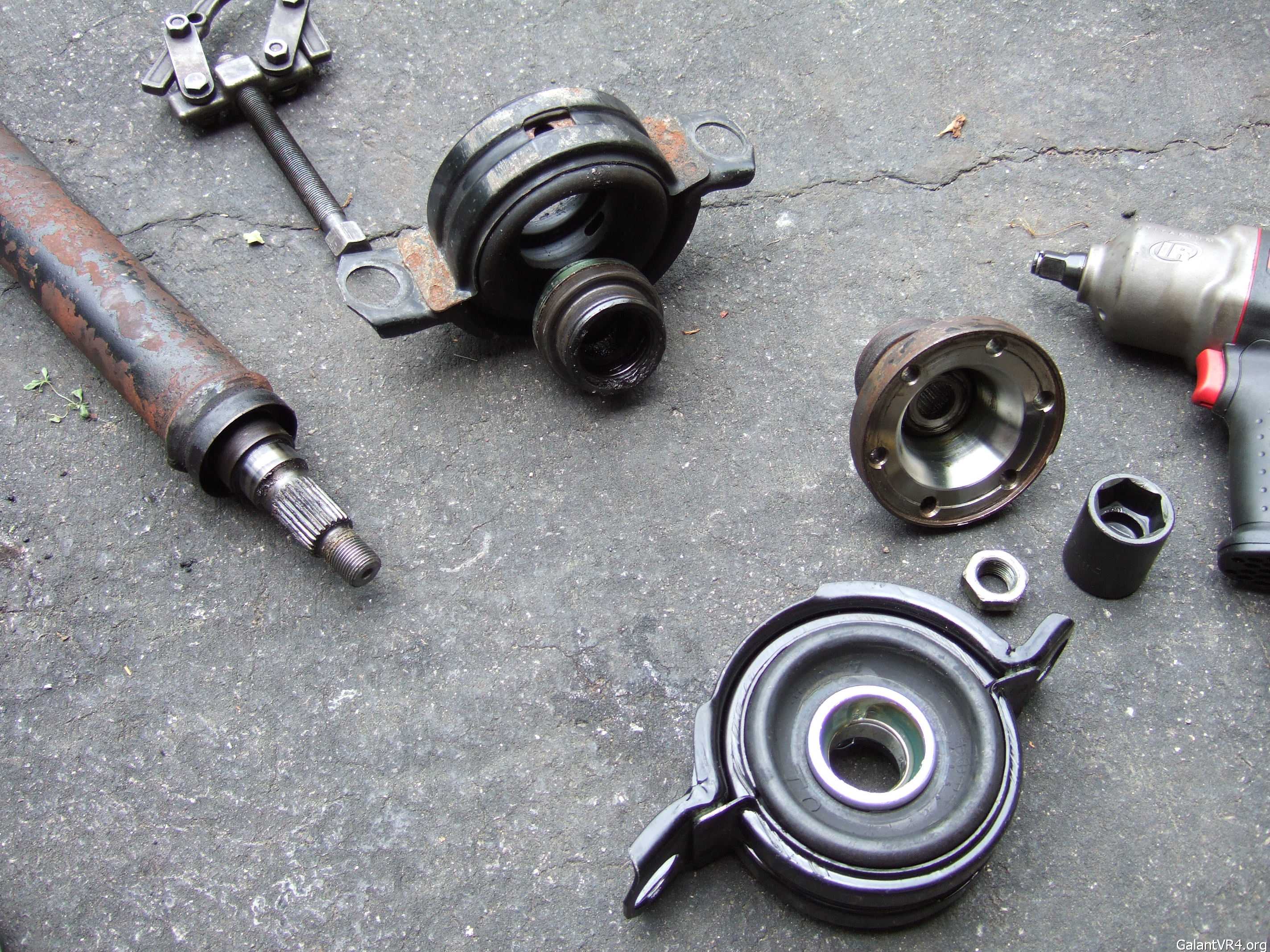

Bad rear carrier bearing. It's been vibrating like a mofo for a few weeks (no banging) and made some unhealthy grinding noises on decel. I split the driveshaft at the lobro joint so I wouldn't have to mess with the t-case. The impact gun made easy work of the "mega-wicked pisser Conan nut"
Be sure to MARK THE DRIVESHAFT in a number of different places before you pull it apart, and check that you're putting the new carrier bearing on correctly. The car mounts are offset, so it's possible to put the CB on backwards.

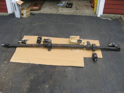

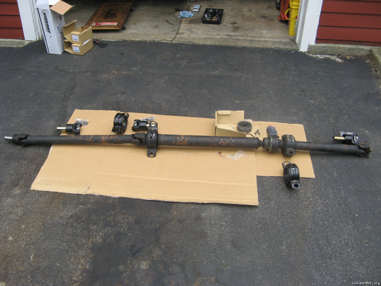

I'm in the process of rebuilding the entire driveshaft again. I'm done with all the u-joints and carrier bearings. It was a pretty easy now that I've done it a few times. All new parts ready to go:

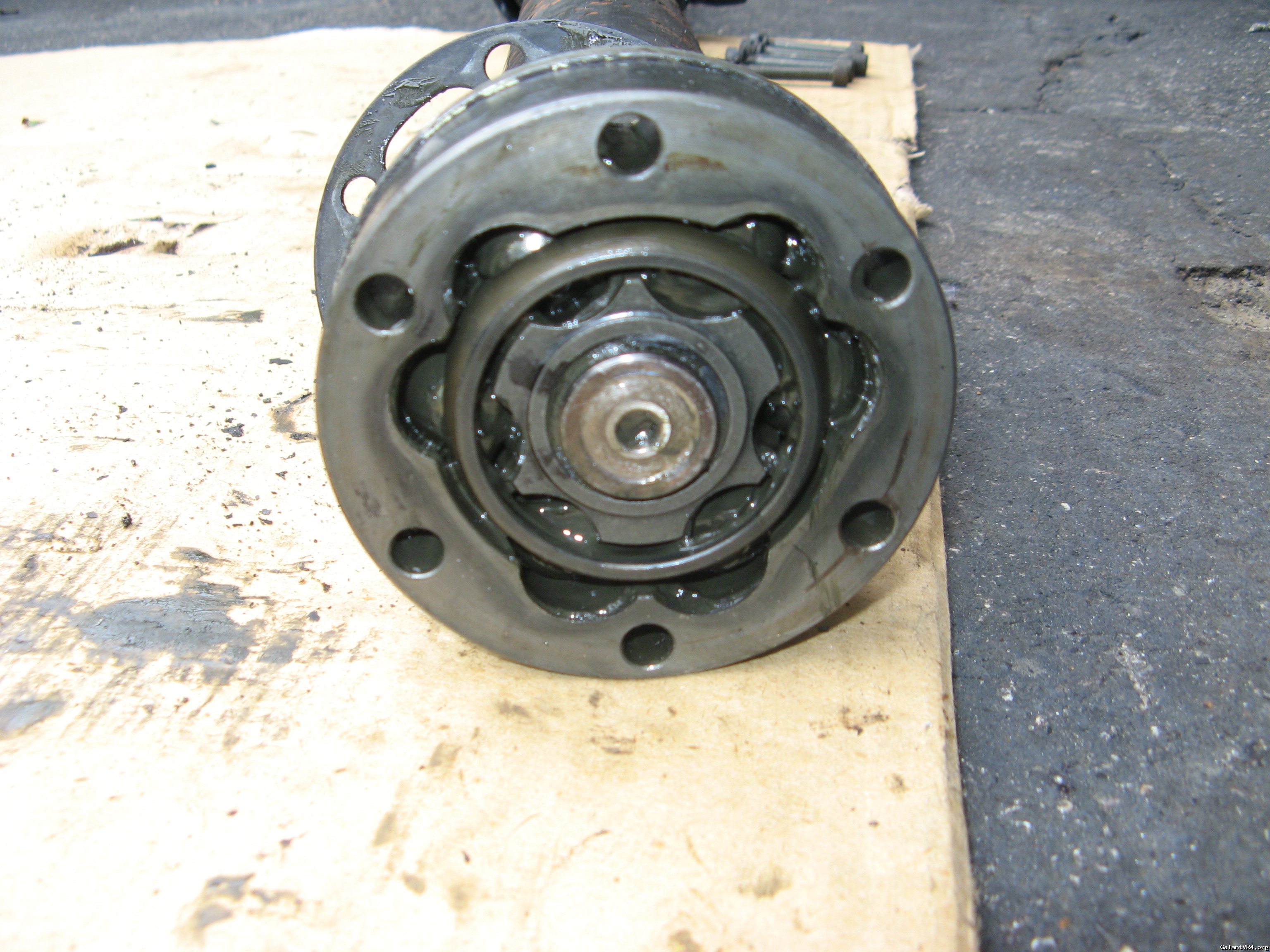

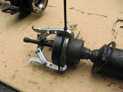

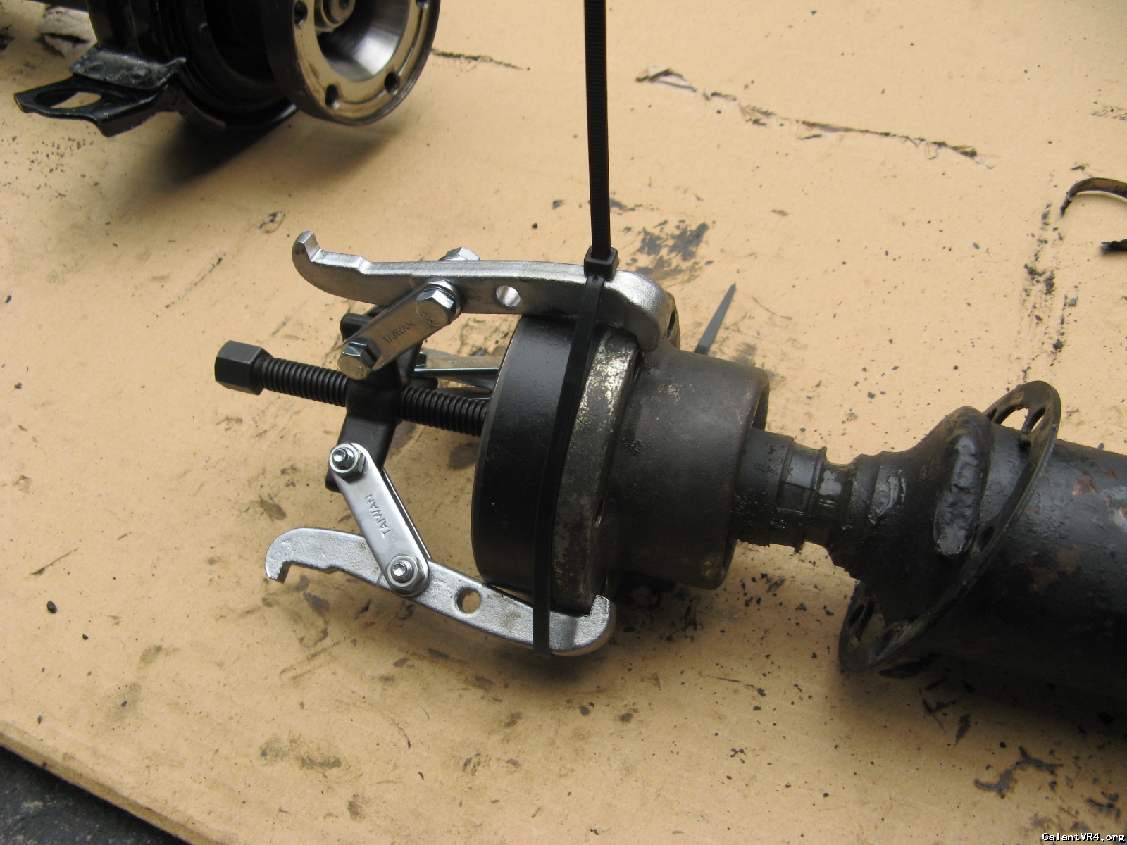

The problem is getting this f-ing lobro joint off of the center section of the driveshaft. There's a circlip holding it on that I have removed. But I can't seem to get the lobro to slide off of the splined driveshaft. I tried a gear puller, but it doesn't seem to be working. Any ideas?

Cy, I wouldn't drive the car without the rear driveline installed. The center diff won't like it, and you could damage the viscous coupler.
I don't know why that won't come apart. /ubbthreads/images/graemlins/dunno.gif
I've never pulled the c.v., but it seems like it should slide right off, after the c-clip is removed.
Are there burrs on the splines?
Are the splines twisted or deformed?
edit Just read the factory service manual, there's nothing else there, just that cir-clip, accesible from the outside.
They show the joint being dissassembled on the driveshaft stub.
after scribing alignment marks on the outer race, cage, and inner hub. (They also want the balls to go back in the same location from whence they were removed)
In the end, though, they show basically the same basic puller set-up that you're using, just pulling on the center hub.
Pulling against the outer hub may be hazardous to the cage, and may also put some dents in the races.
Are you replacing the c.v.?
If you have another c.v., it may be time to get more vandalistic. /ubbthreads/images/graemlins/devil.gif
An airhammer from the backside (against the inner race) would probably knock that c.v. into next week. (be carefull to not fork up the splines)
Or maybe a slidehammer (on an axle remover plate) with a few bolts threaded thru the outer cage may do the job. (Don't use the hardware from the shaft, it'll probably stretch/boogerfy the bolts.
I vaguely remember fighting something similiar to this on another vehicle, and the cause was a gnarly burr caused when the driveshaft section hit the edge of the plate that secures the c.v. (during an accident.) Copiuous filing achieved the clearance required to remove the hub.

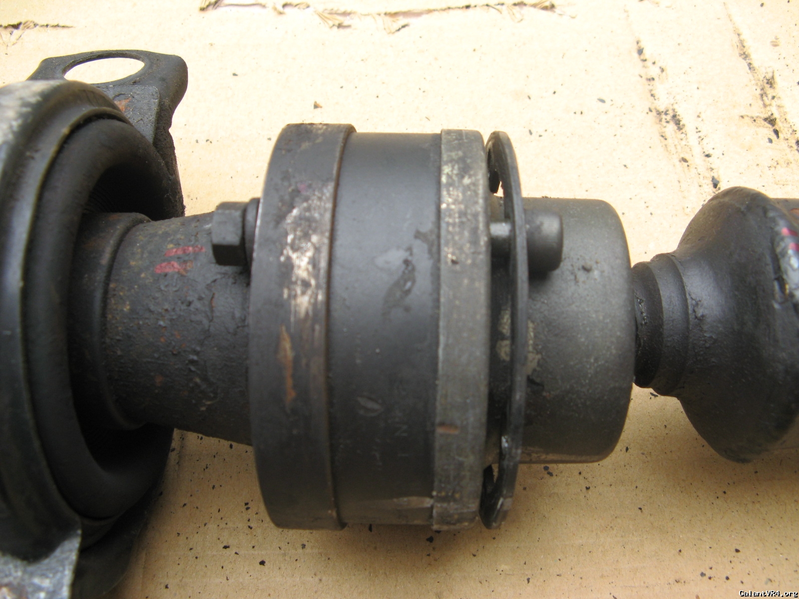

Did you get it off? This picture concerns me:
I'm pretty sure you're supposed to separate and remove the lobro joint from the companion flange first, not use the gear puller on both pieces at the same time. I could be wrong though.
