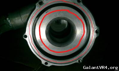

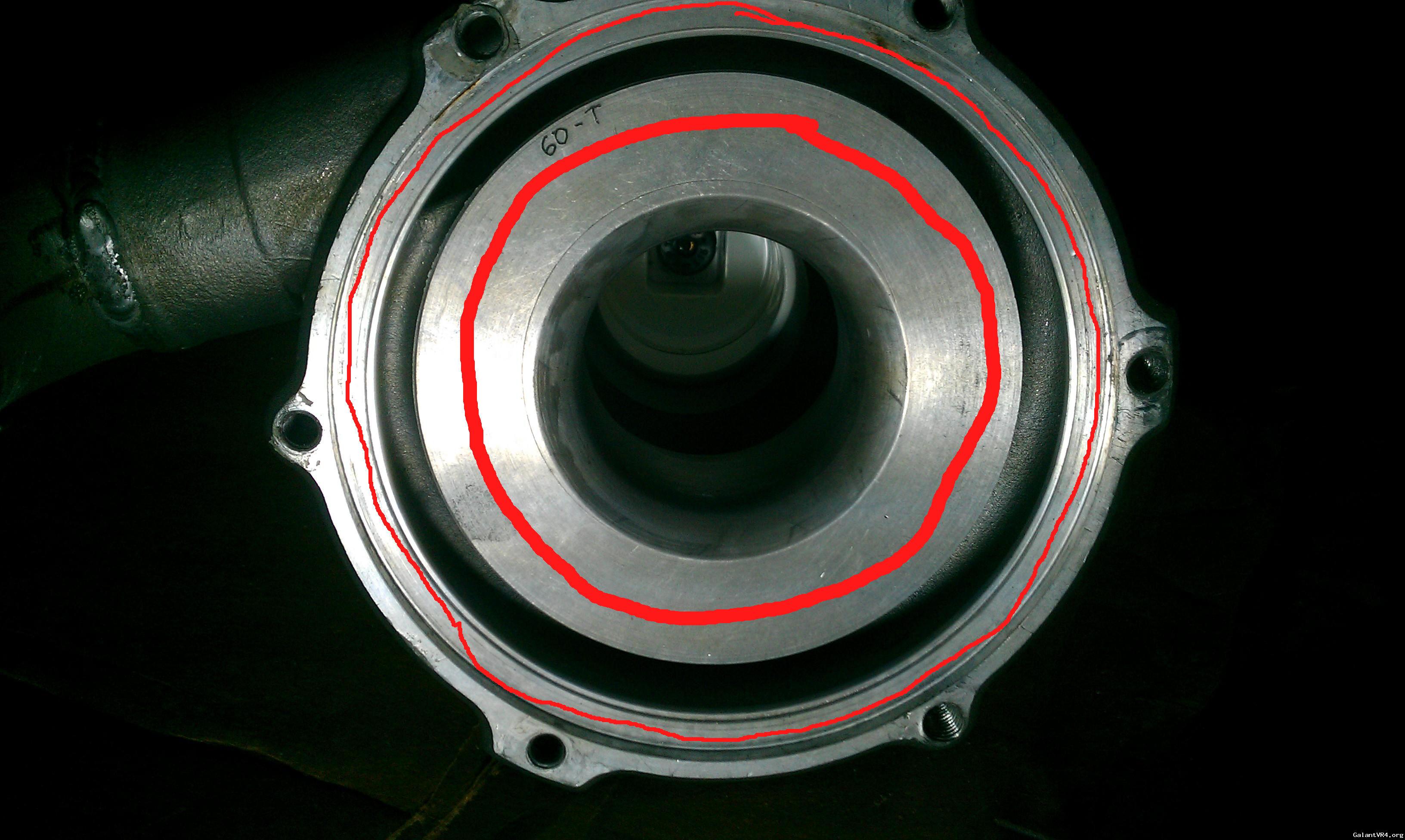

When I applied the sealant I just used a small amount and smeared it on the areas pictured below. I followed the tubes instructions and let it cure for a few minutes and then put the housing back on. To be perfectly honest with you unless it is really, really leaking I would just run the turbo as-is. The old school garrett turbos (T04Z / T67 etc) used no o-ring/seal of any kind and it was normal for them to leak a small bit right out of the box. Boost leak test it to 30/40psi and if it's just a small hiss you're fine.
Oh, and 400 grit sandpaper? To properly seal up I would have used at *least* 600 grit, then clean w/coffee filters and rubbing alcohol!
Make sure you're smearing where the red lines are, and don't over do it, just a little works fine!
