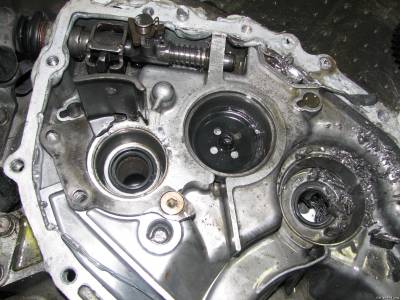

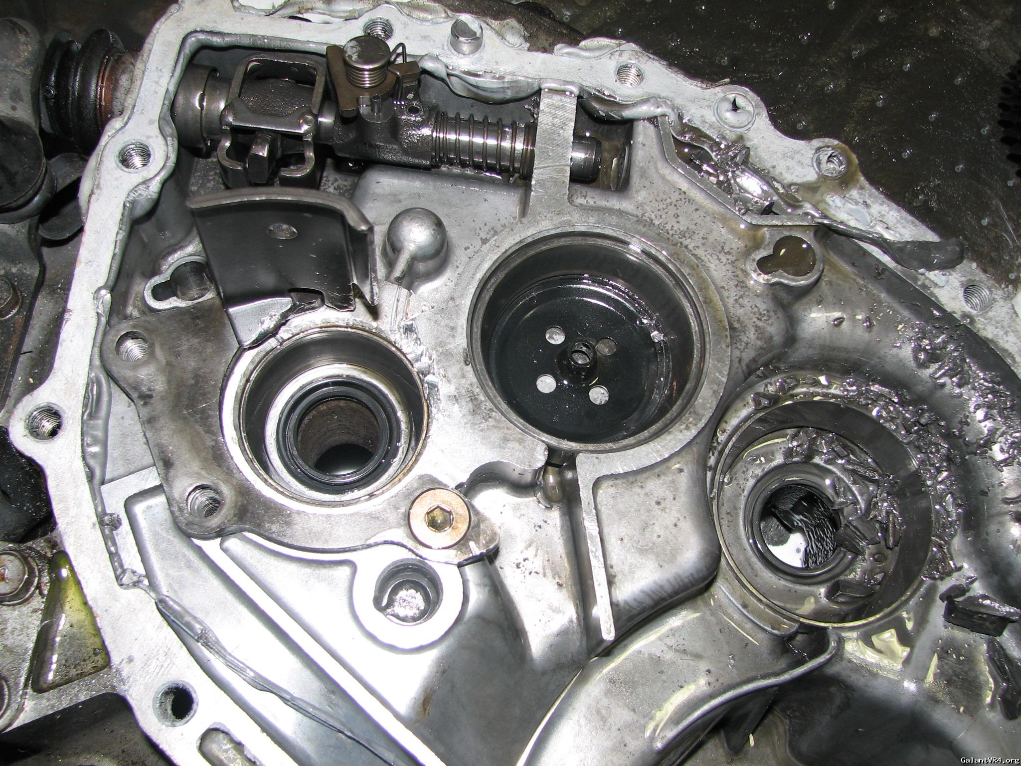

As always, great post DC.
"Kitty food"
That's funny. I always call it gravel.
Now that you say it that way, I think "Kitty litter" is a more accurate analogy.
