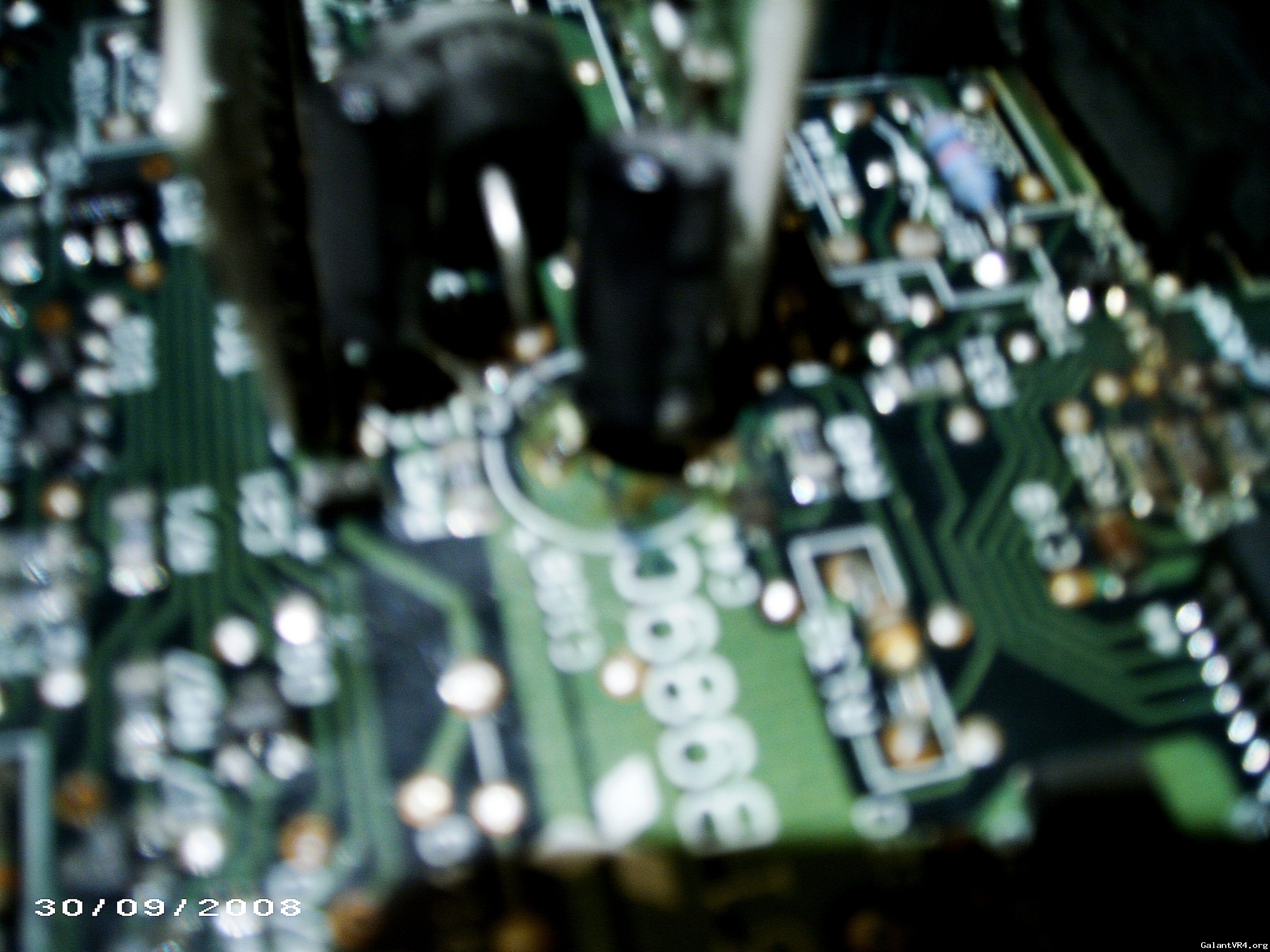

Pulled the ECU, nothing looks terrible to my untrained eye but what do I know. Took some pictures hopfully they show up well and you guys can tell me yay or nay.
This is the only thing I could see that worried me a little bit, wasnt the greenish-black I was told to look for but this is more like rusty brown?? Didnt know if it wasn anything to be alarmed by.

The only things I can tell for sure from that picture is that I need my glasses. Oh, I have them on, it must be the picture that's out of focus.
Actually I can tell that whoever changed that cap didn't do it correctly. I can still see the electrolyte damage (the tarnished copper under the green solder mask) to the ground trace and suspect that the cap isn't really soldered to both sides of the board.

Well thats interesting, do you think thats where some of my problem lies? If so is it repairable or am I better off sourcing a different one?
Those caps werent replaced anytime soon. Several years ago I'd bet so could they have messed up more over time or what? /ubbthreads/images/graemlins/dunno.gif

The ECU is pretty rough. The caps had leaked in the past and while fresh ones were installed there wasn't much attention spent on the rest. It had also blown one of the ISC drivers in the past and a replacement driver installed but it's not connected to anything. Only one of the four ISC drivers was functional. Both of the drivers on either side were half installed and are questionable. I'll test them before reinstalling.
I haven't done anything but remove the parts so far.
