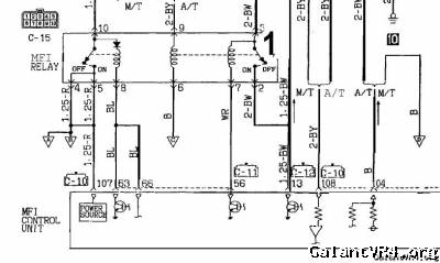

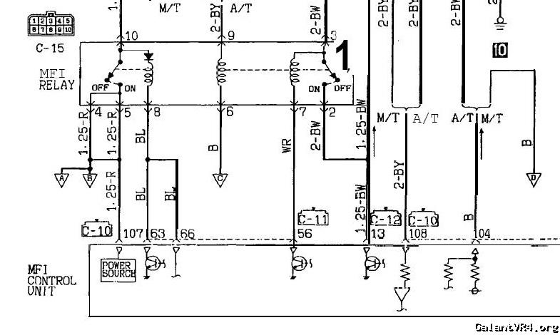

A buzzing MFI relay is almost always a bad ECU. The previous owner may have replaced the bad caps, but the problem is that most guys don't clean up all the acid laying on the board, and you can't find all of it in most cases. So, the acid continues to do its damage for years, and the ECU fails again.
The ECU grounds 2 different wires to the MFI relay, one half turns on the fuelpump and the other half powers up all the electrical stuff under the hood. You should try manually grounding those 2 wires, pins 63 and 56 of the ECU, to see if the buzzing stops and the car starts:
